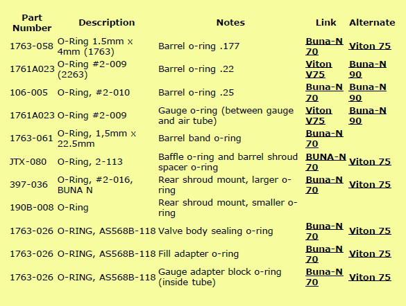

I'm looking for the complete list of O-Ring sizes for a Marauder. I have seen this list but it doesn't provide dimensions so that I can order several of each from the O Ring store, which is what I usually do when I start playing with a gun. Can anyone provide the sizes for each similar to the first line that lists 1.5x4mm Buna 70?

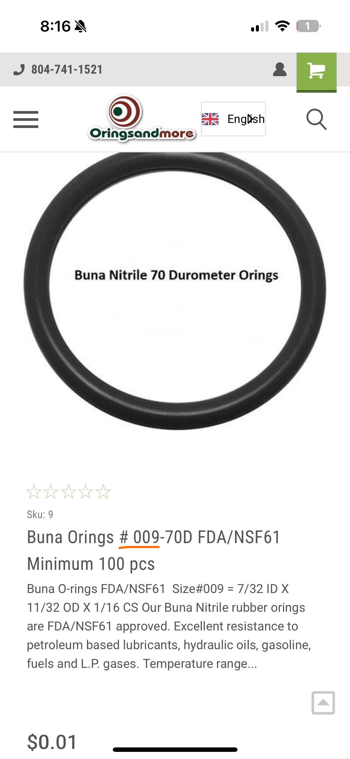

That list has all the sizes written on it. Some are metric and some are a standard size #. The standard are written in a reference number instead of dimensions.Kinda confusing. Example: #009 (.22 barrel oring) as show here on orings and more. Also this is cheapest place to to order I’ve found.
The marauder parts diagram online has most orings listed as well. I’m sure that yellow list is complete it’s been posted a bunch over the years.
