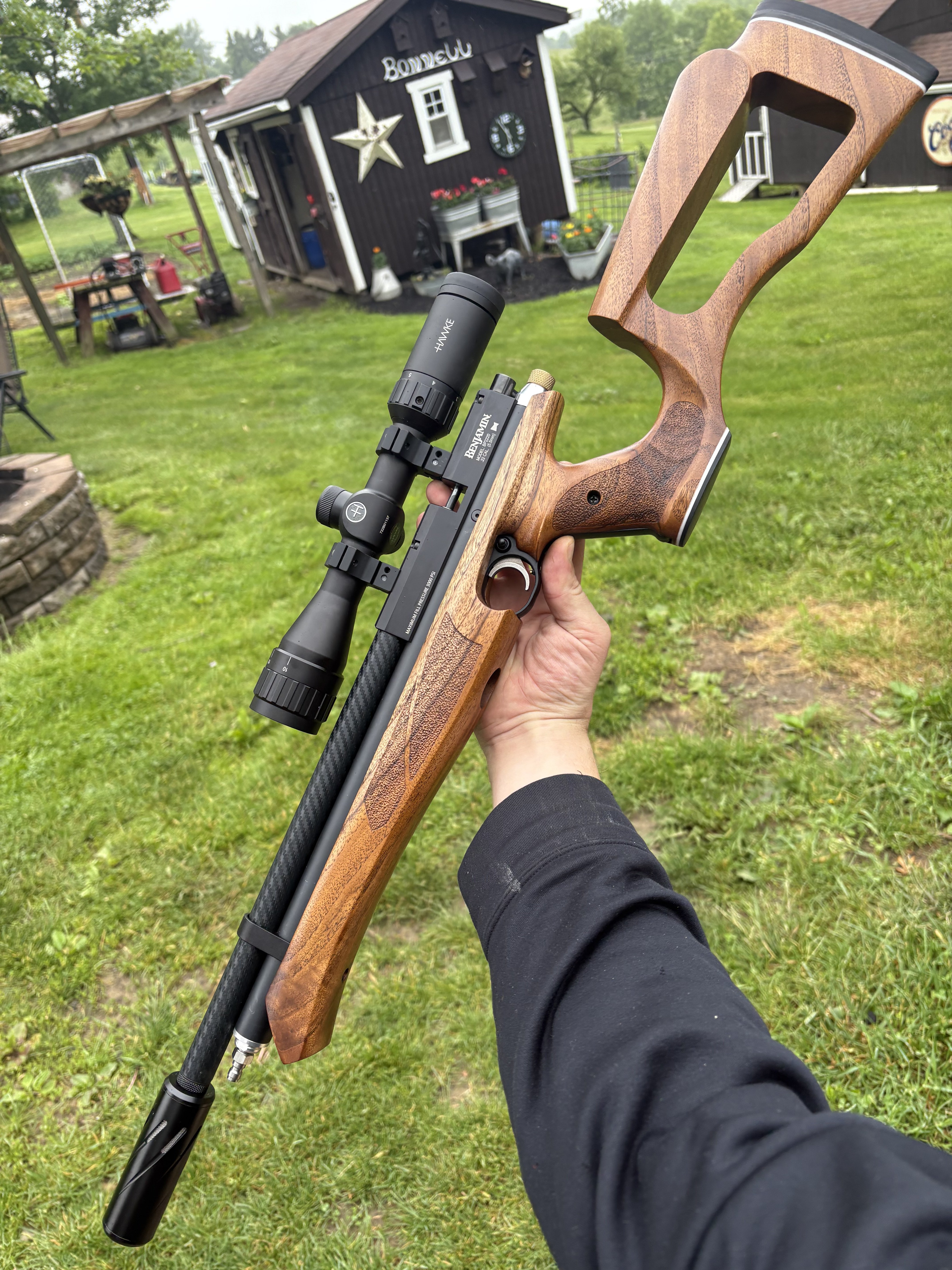

Leaks are just one of those things that happen w/ pcps.It can happen whenever to. I gotten guns brand new that leaked. Then I got guns that are atleast 8 years that never needed a oring. I guarantee there’s some neglected marauders that been sitting 10-12 years and haven’t leaked haha.
Marauders are very simple and proven designs.They are usually very reliable guns. I’m sure you could find the leak and reseal yourself. Just take your time. If you’re just a little mechanical inclined you’ll have no problems. Plenty of videos and info online to help. Plus us guys here on AGN 💪
As you mentioned there’s a ton of aftermarket parts available. That can become a deep rabbit hole once you start ahaha. I just did a PRod myself. It wasn’t a cheap learning experience but I sure had fun. Totally worth it to me. Guess it just depends if you like tinkering with stuff. I like it as much as shooting the things.
