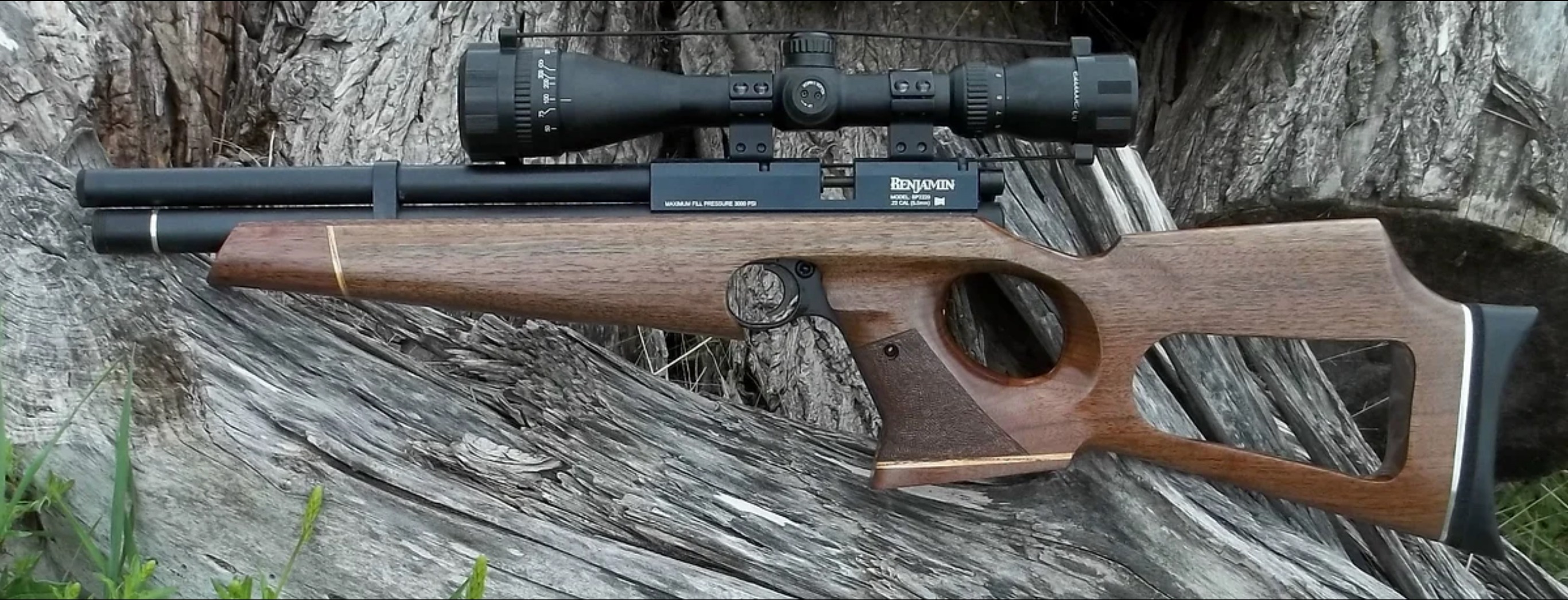

Anyone using a Marauder in bullpup form for field target? I’m thinking of getting one and putting into a Steve Corcoran stock. I’m curious about what opinions y’all might have.

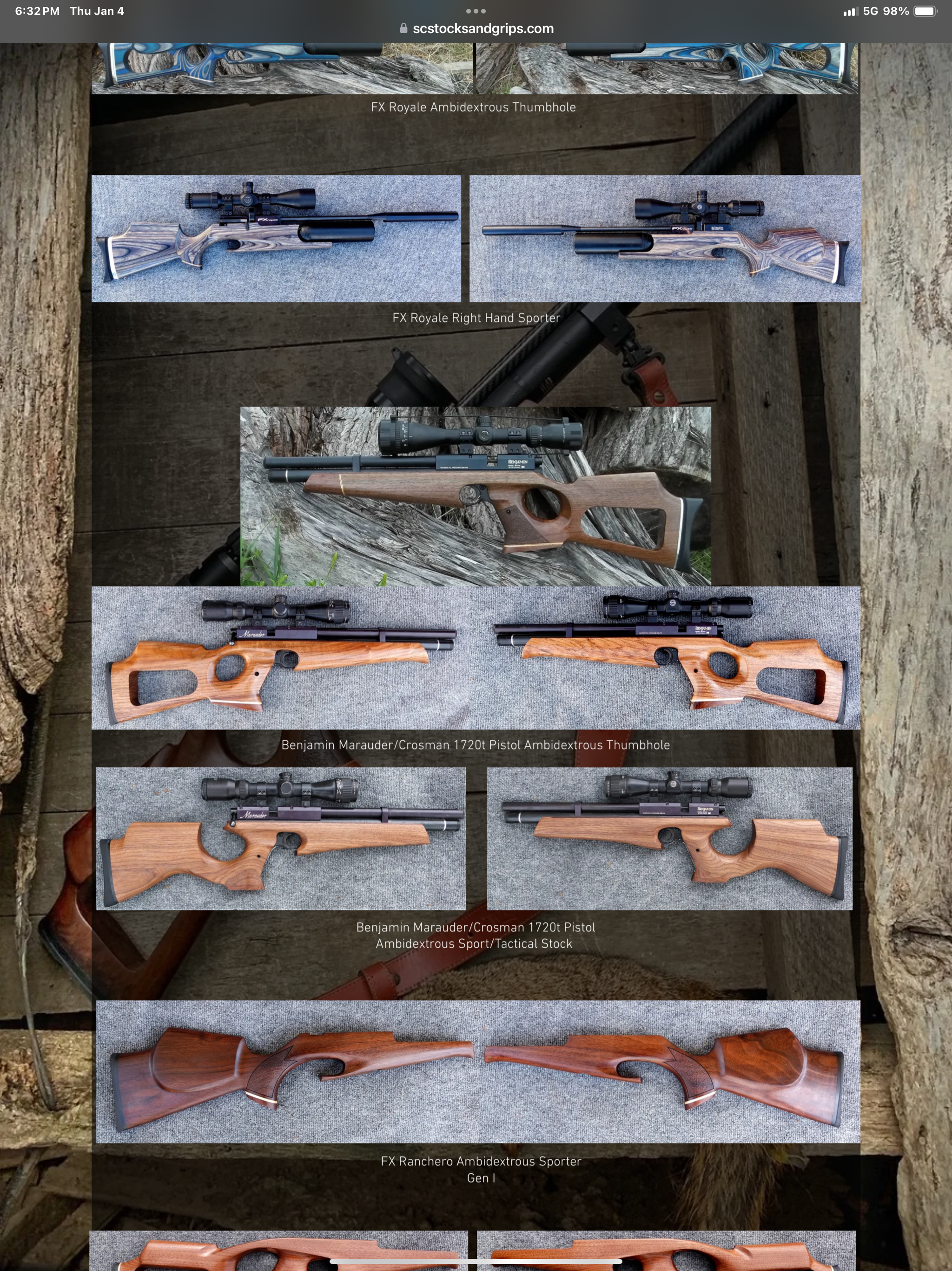

I think you may have the Marauder rifle and the Marauder pistol mixed up. The Marauder in the Corcoran stock in your first post is a .22 caliber Marauder pistol. You COULD shoot a FT match with it it, but in stock form it's nowhere near the 20 fpe limit for hunter AND only gets about 28 or so shots between fills.
As stated in a post above, NOT a good choice for FT.
