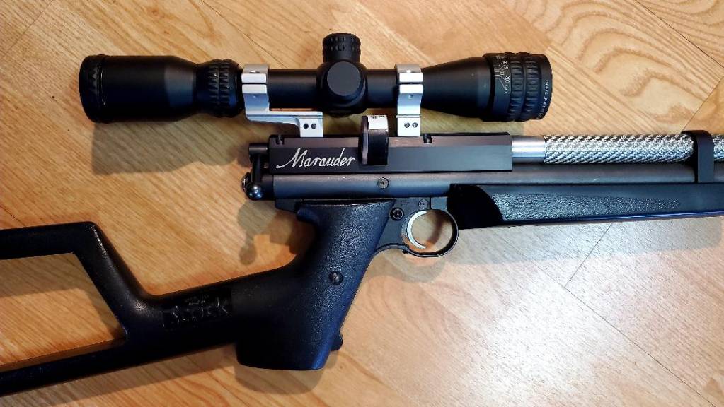

I'm using a Hawke 2-7x32 and BKL offset rings. It is lightweight and works well.
