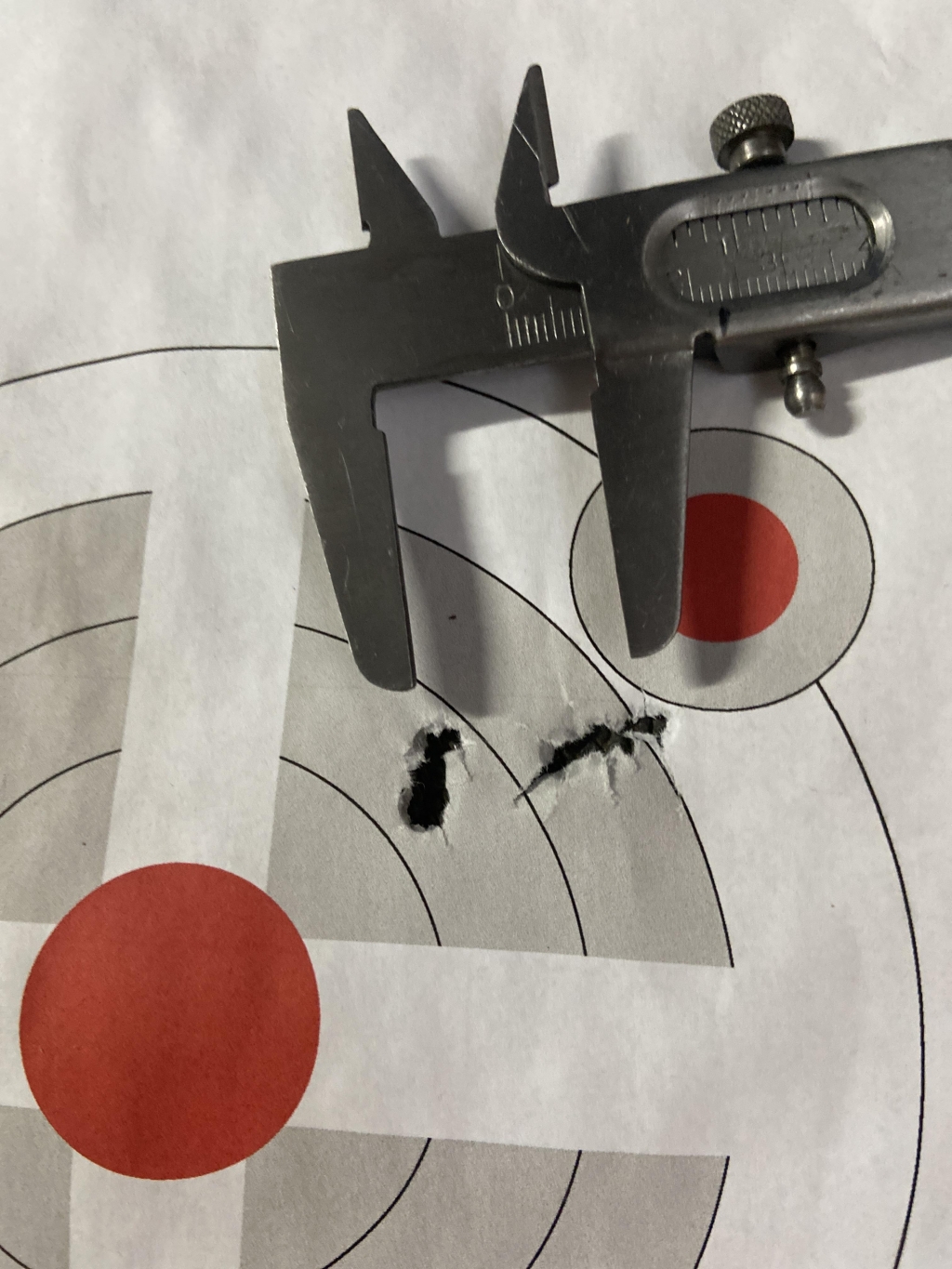

Also, it seems that the accuracy is slowly improving over time, but there a few times I got two groups in my groups, where there are three shots in one hole and two in another hole. my groups are between 3/4” to 3.5”.
Here is one of the best 5 shot group at 35 yards. (Most of the other good groups were destroyed in the rain last night)
My question what could be causing my inaccuracy? Could my marauder require a break in period of a tin of pellets? Could the barrel still need more leading after my intense cleaning?
Well there's alot of things that could be affecting your poi. Do you know what barrel came with it? How did you ckean the barrel, did you clean the barrel like you would a powder burner? Did you use a metal brush in the barrel? Do you see any lead clippings with the magazine, this is not a normal marauder issue but still good to check as damaged pellet skirt causes poi issues. Look at the tip of the barrel do you see any damage at the crown? This is where I would start. Good luck.
If you can take the noise, remove the shroud and test. Also test with single pellet loading, no mag. Push a pellet through and look it over. Burrs in TP/leade are common.
Unfortunately, the 25 barrels are not made by Green Mtn anymore. The crosman made barrels tend to have a very heavy choke and loose bores. I had some OK accuracy from the two I had. Sent one off to a machinist for a pistol barrel. Once he had the section cut, the pellet just fell through the barrel. Trashed it.
I don't think they will work well with slugs, but even the GM is not known to be that great at it.

A leaking transfer port seal will cause erratic groups like you are seeing as well as a bad breech seal. Do you notice any noise in the breech area when shooting? If you place tissue paper over the breech area and fire the gun you can detect small leaks by watching for movement of the paper.
Next thing to check is the striker and tube. If the tube is dirty then the hammer/striker will give inconsistent strikes on the valve pin. I clean and lube both with a very thin coat of silicone grease.

With that said, no one yet has suggested it could be your scope. I would try a different scope, if you have one. It doesn't have to be a high end scope. A loose reticle has had me chasing my point of impact poi at times.
That would at least narrow your accuracy issues to the rifle.

That sucks man. I have a 1st gen puncher breaker in 22 and that thing is a tack driver. I did some personal modifications to get the desired fps etc but it shoots lights out. I also had a gauntlet in 25 which shot lights out after some tuning just tooooo heavy for good field work. Then I had an Rti priest 2 in 25 which i should never had sold, as they put a side lever cocking kit for that. That gun was beyond lights at past 100 yards. Sounds like you got a bum barrel.
Good catch on the scope. I had read his initial statement "I have already eliminated the following variables as the culprit of the inaccuracy: Shooters error, Parallax issue, shooting position, Winds, Scope mounts, velocity, weather and barrel cleanliness. "  and thought he tried another scope. Rereading verified a number of scope items, but not that specifically. What is also common with scopes, is too much vertical recital adjustment is made, such that it as its limits, and will see those type of groups. Re-center the reticle and shoot for groups. If that is it, simple scope shimming to resolve.
