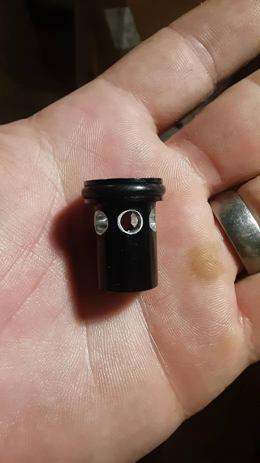

Opening up the holes in the air diffuser will help quieten the gun down as well.
With this in place on the barrel the shroud and barrel would if anything droop together. That means bore alignment would still be maintained.
