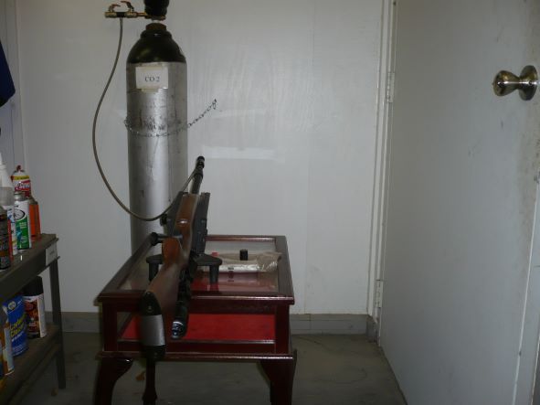

Back in 2008 I read with more than just a passing interest, the introduction of the Benjamin Discovery Rifles and their Dual Fuel capabilities, HPA & Co2!! It was the Co2 aspect that I was REALLY INTERESTED in, looking for an improved version of the M-113/114!! The Discovery with a larger OD Co2 tube .880” vs .750” for the 113/114 which will store more Co2 and should provide a longer shot string, and a 24.5” barrel, the M-113/114 a 22” barrel; and depending on the valve set up could also provide higher velocities as well. The overall length of the Discovery was 39 inches just one inch longer than the 113/114 units and weighed 5.25 lbs. nice compact size! Push type safety on trigger guard, wood stock and utilizes a male foster type fitting for charging.

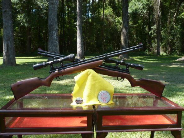

I was perusing the net in 2014 and came across a dealer who advertised “Discovery Factory Refurbs” at 165.00 each!! So I immediately ordered 1 each in .177 and .22 caliber the cost of two was basically the price for one unit when they were initially put on the market (Rifle only)! Both units looked factory new no wear marks etc. I was happy with both units, they each had rear adjustable and fixed front fiber optic sights. After field range testing both it was clear these Discovery units made the 113/114 Crosman Co2 rifles, have to take a back seat performance wise, in the area of velocity and power , the 113/114 units had been surpassed, took some 50+years but it had been done!! (Just my 2 cents others may disagree!)

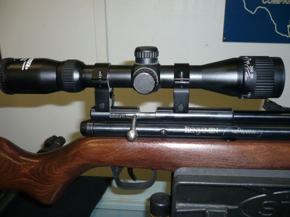

I identified 3 areas during the initial field test that were needed, for both units to meet my goals, (1) - scope (2)- trigger work and (3)- 2nd. barrel band. I chose the Winchester branded 2x7x32 AO Scope, did the 3 screw mod to trigger and set at 2.25 lbs. (info available on the net) and installed a second barrel band purchased directly from Crosman. There are pros and cons about second barrel bands. I fall in the Pro group; there was some slight movement at the muzzle end of the barrel, at least on my units, so I chose to eliminate this with the 2nd. Barrel band, I installed the band and after cleaning both band and lock set screws, and using Blue lock tight, tightened just enough to prevent movement of barrel, no more!!
