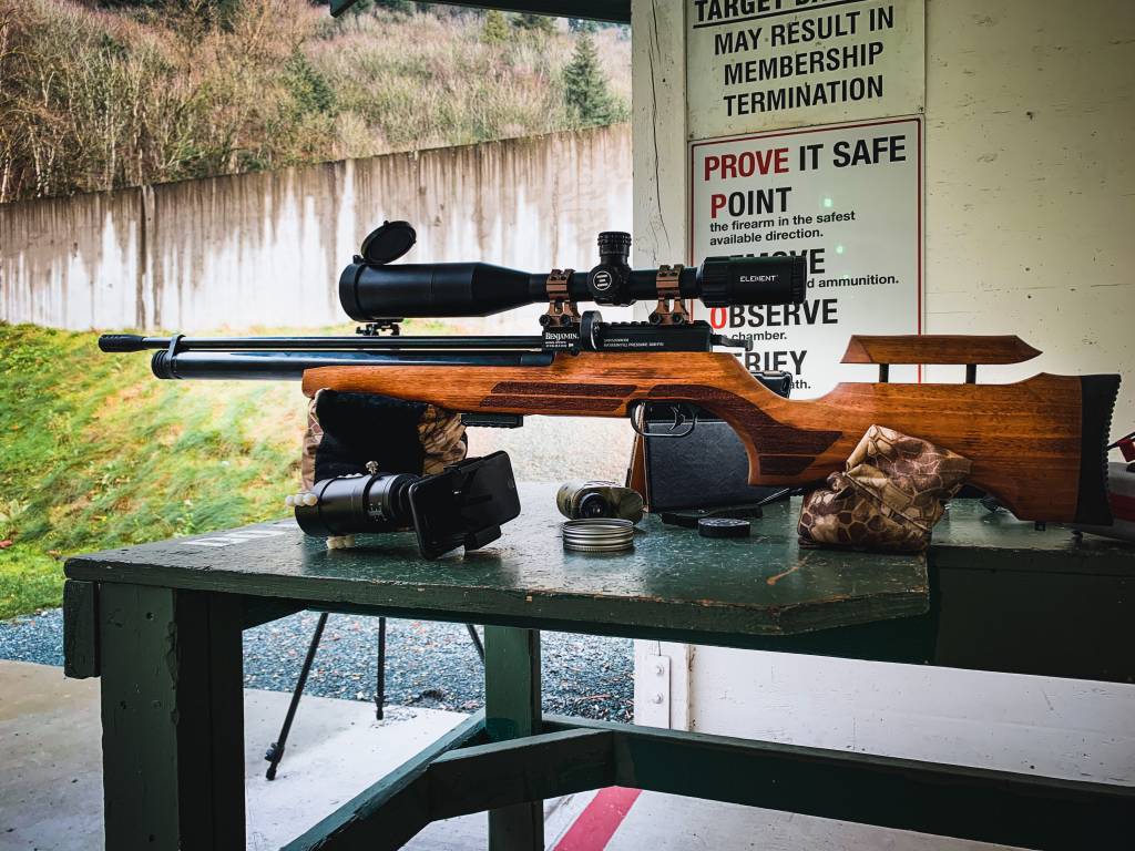

On low power it’s perfectly backyard friendly for my location. It shoots as slow at 470fps which is great for 25M and under and it’s not loud enough to annoy the neighbours. But you can crank it up and get it over 1000fps with lead if you wish!
I’m also running the same west hunter rings, I had two other sets that didn’t work and has to order them.
Thanks for the photo and the info. Looks like a beauty. I looked at those rings. Was going to order Leapers or accushot in Medium and High. Looks like you still have a bit of space between scope and action.
Yeah there is, and you can see I adjusted the cheek piece to match. The two medium sets I had did not work with not enough clearance for the mag, so I moved up to the higher set. I did not actually try the Westhunter Mediums, but Odoyle above said they worked for him. I may buy the mediums as well in brown to try them out.

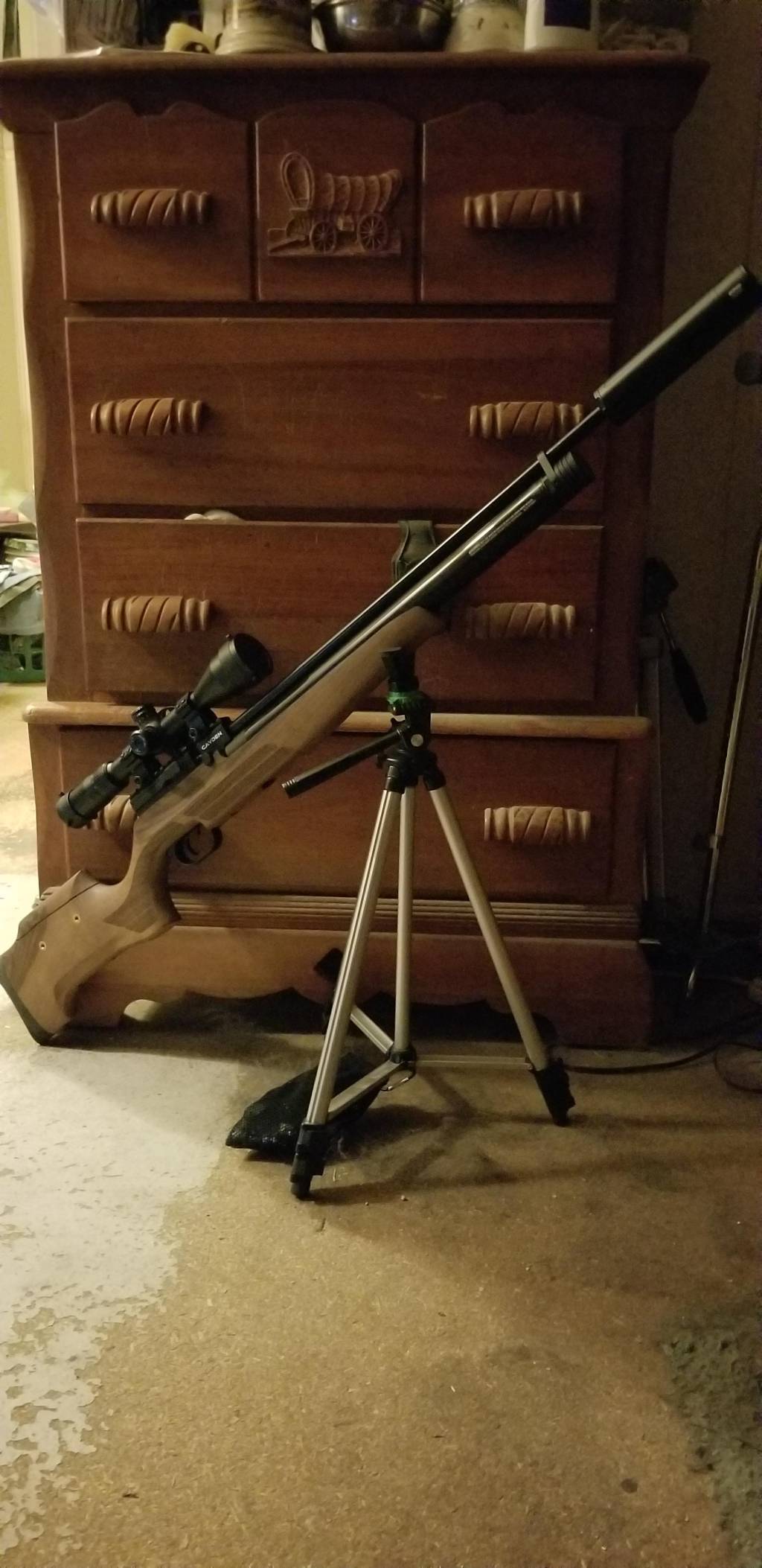

...you could go with lower mounts... 1.1" rather than 1.4" over center...
...the 1.1 " mounts re in the photo I posted...
...this is the "high" mount...I am using the "low" mount although it is really a medium IMHO...
...the mounts come in both sizes and may colors...
...I have the 1.1" mounts and it clears the magazine snuggly but with plenty of space even though it is a close fit @ the adjustment knob housing on my 30mm Alpha6 scope...
