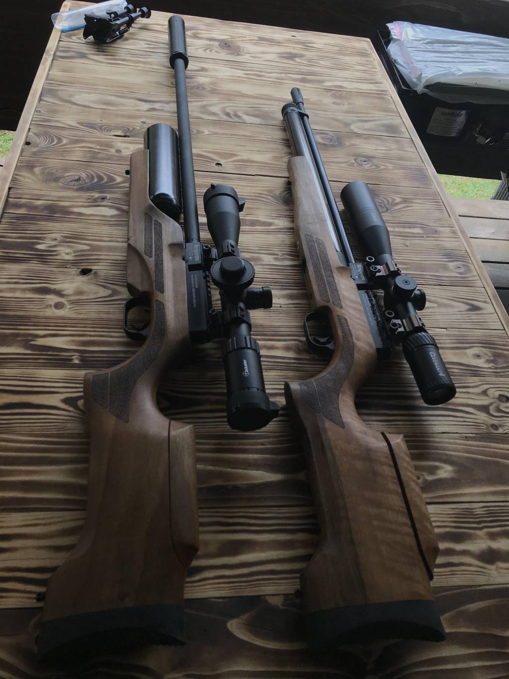

I am happy to own both the Cayden and the Kratos. I shoot 4 magazines per fill from the Kratos and 3 from the Cayden before refilling and get super consistent shot strings. I think the standard deviation on the chrono was like.... 2 or 3 FPS for them. Very impressive for unregulated rifles.
I’ve recently moved and have not unpacked my notebooks with my gun notes in them yet, or I could give you some shot string info for each rifle. I can tell you that I’m shooting jsb 18gr pellets through each of them and they are both like laser guns.
The Kratos with a donnyfl Shogun has no sound except for the mechanical sound of the rifle. The Cayden is almost as quiet with the Donnyfl Sumo. It has no ping sound at all and is pretty darn loud without the Donny on it.

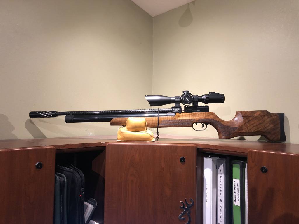

I have a very nicely stocked Cayden and I have to say I am very impressed with it it shoots just as well as my FX Guns. I added the cf shroud and huggett moderator which I think really completes the look and which I reccommend. I have shot a Kratos and while it's very nice the main reason to get a bottle gun in my mind is if they can be removed with air in them like on my Royale's you can't do with that a Kratos but you can change to a larger or lighter bottle if you wanted.
I agree with the assessment of others for hunting/field work the Cayden is the way to go for bench/target work the Kratos probably has the edge but I also think it would better off in .25 than in .22.
