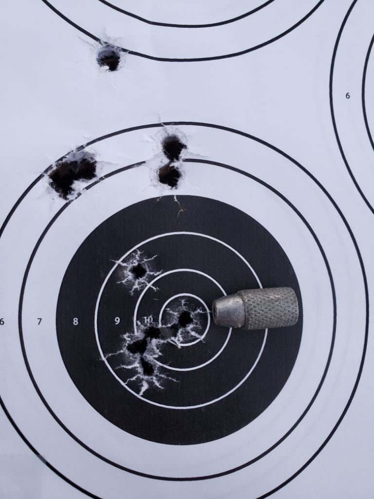

Benjamin Bulldog still experimenting with .38 pistol reloads

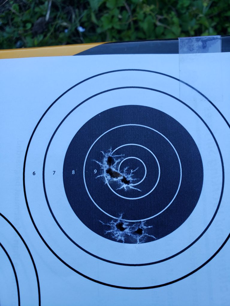

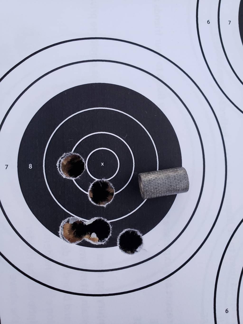

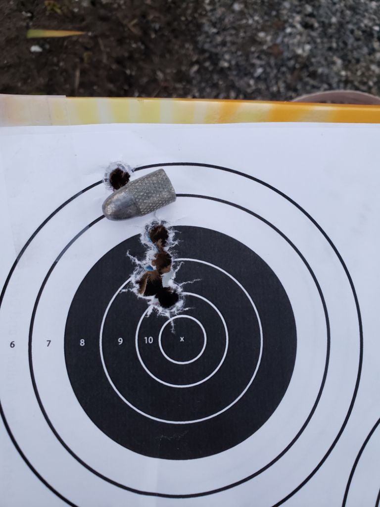

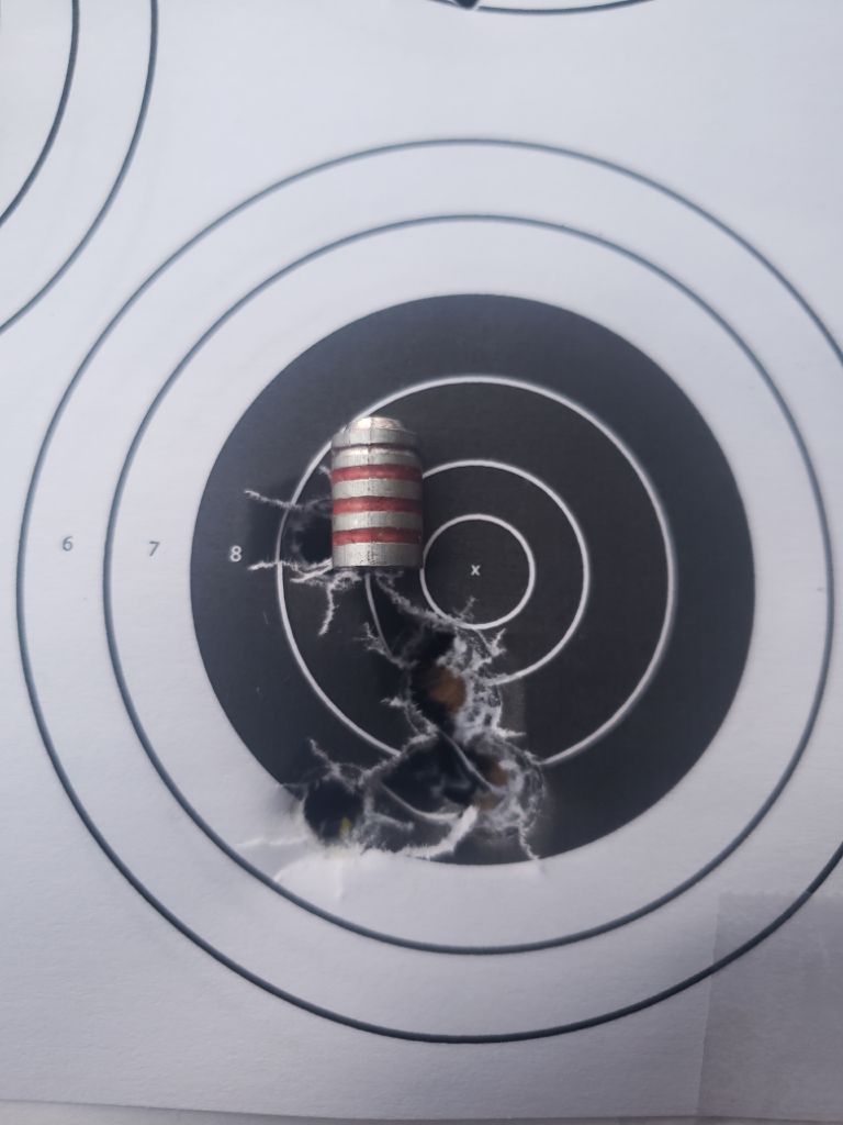

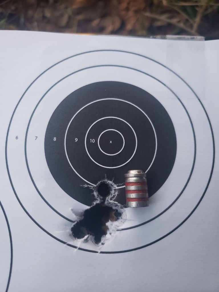

All hornady 158 grain. Lead round nose Semi wad cutters hollow points Hollow base wad cutters shot backwards as a hollow point. All 50 yards no tethered on a bipod. 2900 psi fill down to a 2100 psi on 5 shots. The one with 3 touching is 80 yards. I'm happy with a store bought .38 I pass through a .357 Lee die. $.10 per round .
 SWCHP 50 yards LRN 50 yards LRN 80 yards HBWC 50 yards All somewhere just above 800 fps......230ish fpe
I haven't run a shot string in awhile but one full mage of 5 shots with the same aim point all cluster up in that hole.
I can get 6 shots with tight groups from 2900 psi down too 1900 psi.
5 shot groups is about 1000 psi
