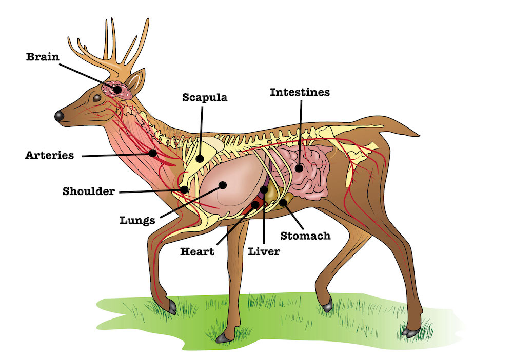

So a question to the deer hunters: Do you think the my Bulldog would be able to take a deer with a scapulae shot? That should incapacitate the deer and deliver a shock to the nervous system through the spine. The reason I ask this, is with the scapulae being as long as it is, if I'm off on my range, I still will get a good hit that I expect to do damage to the lung also. Or is it just safer to go for the lungs and do the tracking? I am considering going to Michigan, since here is Ohio we are behind the times for deer airgun use.
Any thought? Edit: Never mind, I just read an excellent response to my question above.

The videos I've seen of the bulldog taking large game have been chest shots that did not go all the way through. That will definitely kill an animal but not as quickly as a pass through and it won't leave as much of a blood trail. Even for small game with an air rifle I test penetration of my projectiles, typically at 25 yards. If you plan on shooting big game you should probably test further away. For brain shots on big game penetration through 3/4 plywood is recommended. For body shots on big game I want at least 12 inches of penetration in wet paper. I doubt the bulldog can pass the wet paper test but I bet it can the plywood test. If I have to choose between penetration and expansion, I choose penetration. I'd rather have a solid 357 slug go through a deer than one expand to half an inch and only barely get into the body cavity.
