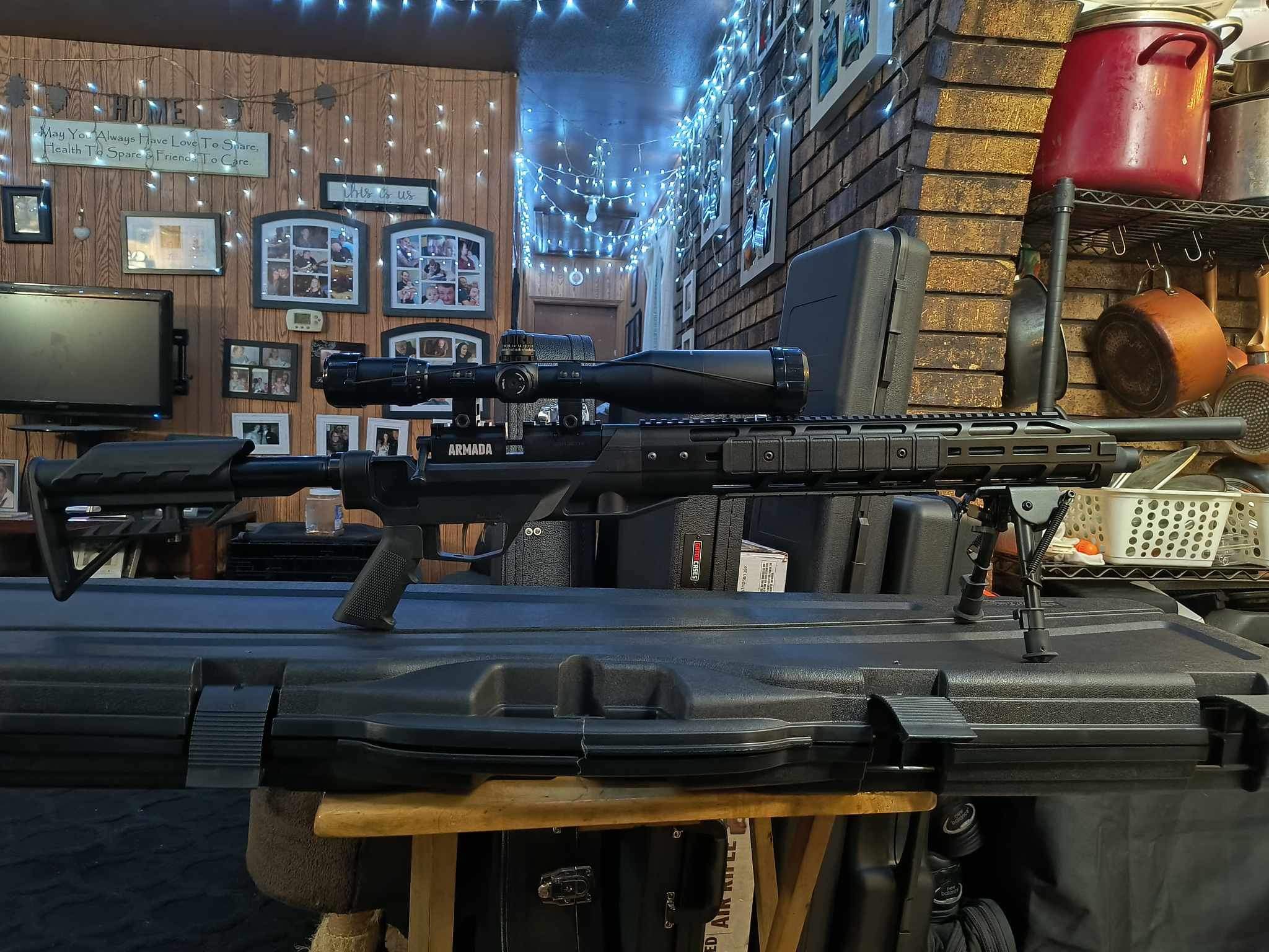

I just saw this post How did you make out with the Armada.
It has been absolutely awesome, absolute tack driver with 18.21 gr Hp Slugs, cpl little furniture upgrades and now I have ZERO complaints, 45yds is all I have to stretch on my property, but seeing as it pretty much stacks them in the same hole, 10rds I’m quite sure it would stretch out well!
