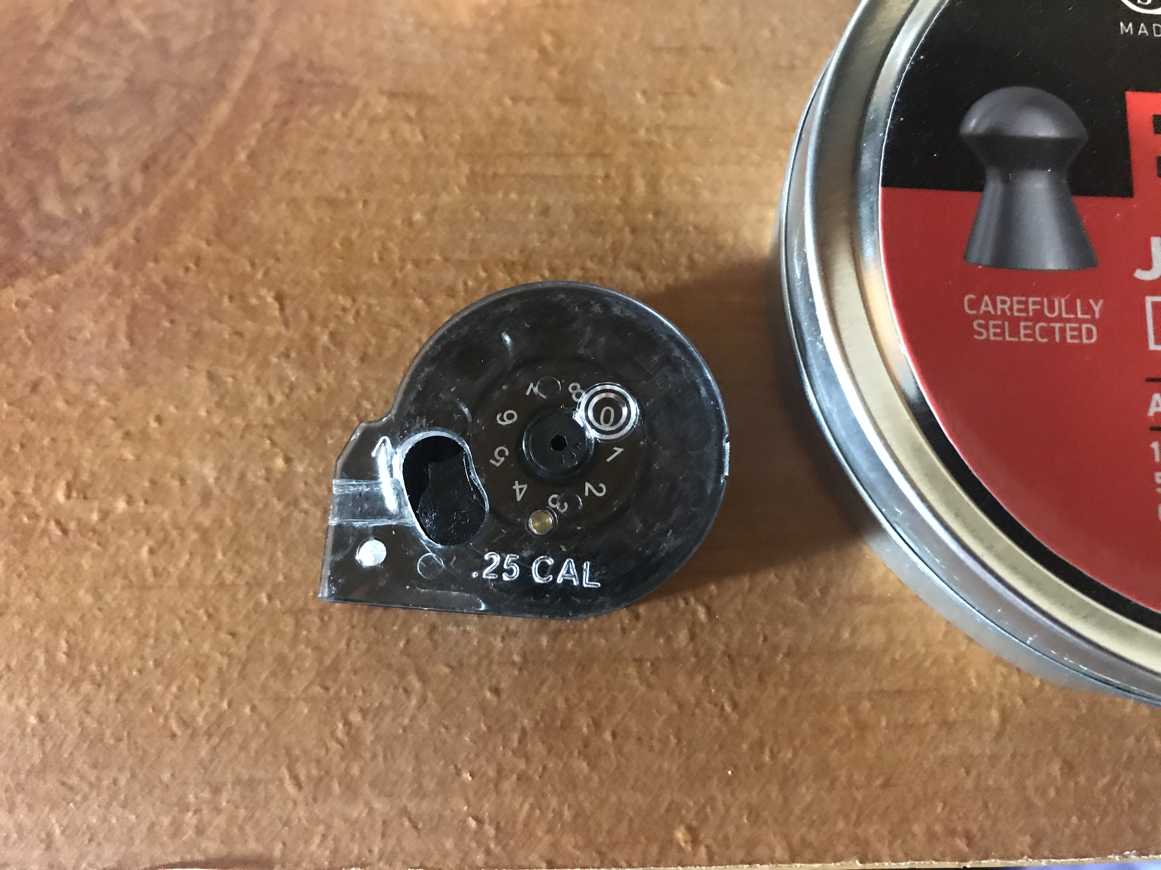

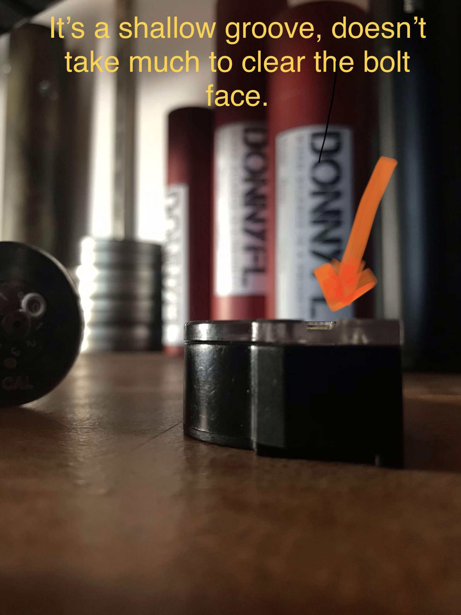

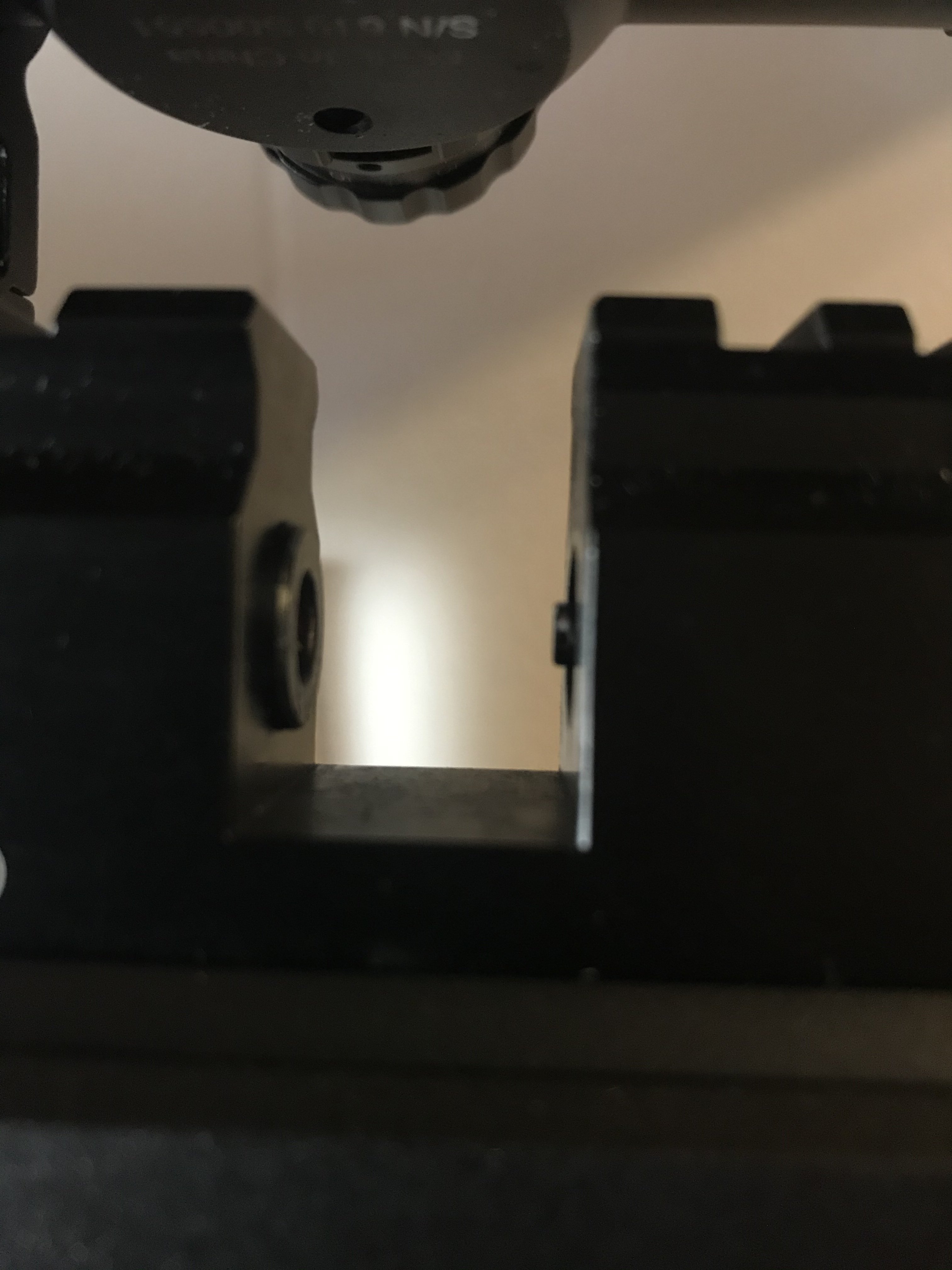

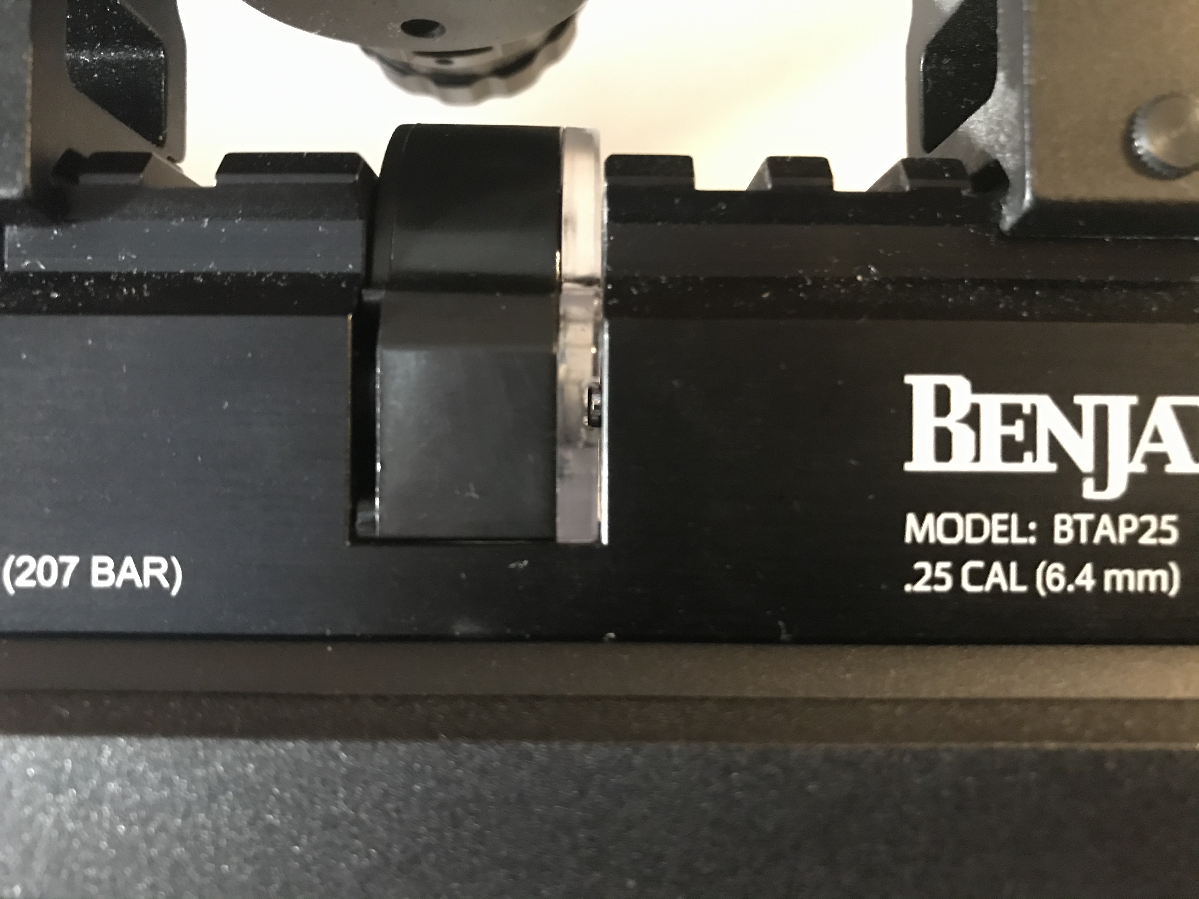

Hey guys. The reason you have to pull back hard on the bolt is because the bolts were made a tiny bit longer. I don’t know why. You can easily modify your magazine to clear the bolt tip using only a small flat file or a dremel. It affects nothing whatsoever other than making magazine changes easy and simple. I have posted pics on this forum before showing the modification needed.
You could also buy a replacement bolt, or modify your existing bolt. I think it’s simpler and easier to just modify the magazine though.
If you zoom in on each picture you can see the bolt tip protruding into the magazine space and the groove you need to make to clear it.
To create an index mark in the magazine I inserted the magazine into the gun and then let the bolt tip drag across the magazine as I removed it from the rifle several times. The bolt tip will scribe a line into the plastic showing you where it made contact. That’s where you need to remove material.
Everything will remain perfectly functional on the rifle, nothing changes except the magazine is no longer a hassle to remove and insert.
