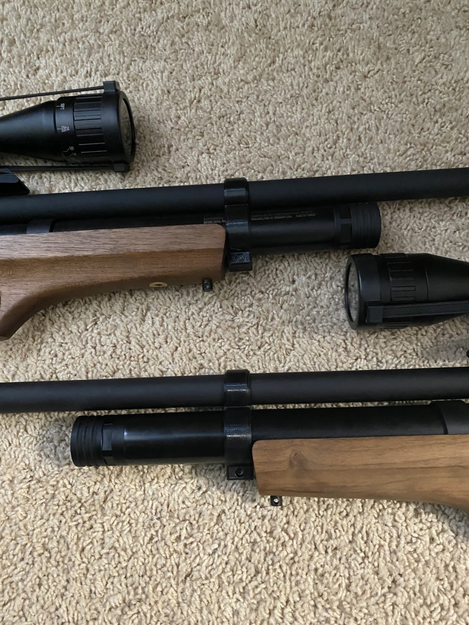

You'll find a couple variations of barrel bands on eBay now. They have come up with some nicer ones since I bought mine for my .177 and .22 Akelas. At the time I think there was only one style available.
or take a look at the Buckrail barrel band.
https://buck-rail.com/2022/02/01/benjamin-akela-barrel-band/

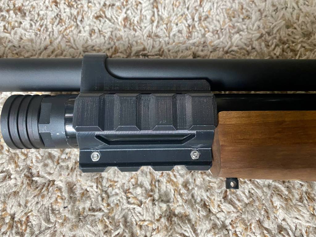

I tried one of the ones from eBay and didn't like it. First, the 2 set screws will scratch the air cylinder if you tighten them. If you don't tighten them the band is too loose to hold the barrel securely. Also, since they are 3D printed, the set screws strip extremely easily. I ended up getting the Buck-Rail barrel band and am extremely happy with it. It's much bigger and bulkier, but it's also much more secure and there are no set screws to scratch the air cylinder. I would bypass the eBay offerings and go with the Buck-Rail band.
You can see the marks where the eBay band scratched the air cylinder. I just wish Buck-Rail offered one without the 2 side Picatinny Rails, I think it would look cleaner and not as bulky.
