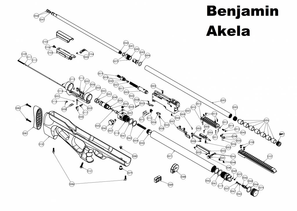

Recently acquired the Benjamin Akela, but unfortunately, I am not finding anything as far as basic maintenance of the gun - such as oiling, etc. The manual doesn't cover this topic at all. Nothing found on Crosman's site either, searching under the following model BPA77W, or name Akela. If anyone can share a link to this information and even a parts diagram, I would be very grateful.
- Joey
Reached out to Crosman support and received these two files, figured I'd share with any other interested parties.
- Joey
View attachment Service Parts Release info_CAYDEN_AKELA_KRATOS.1620419983.xlsx
