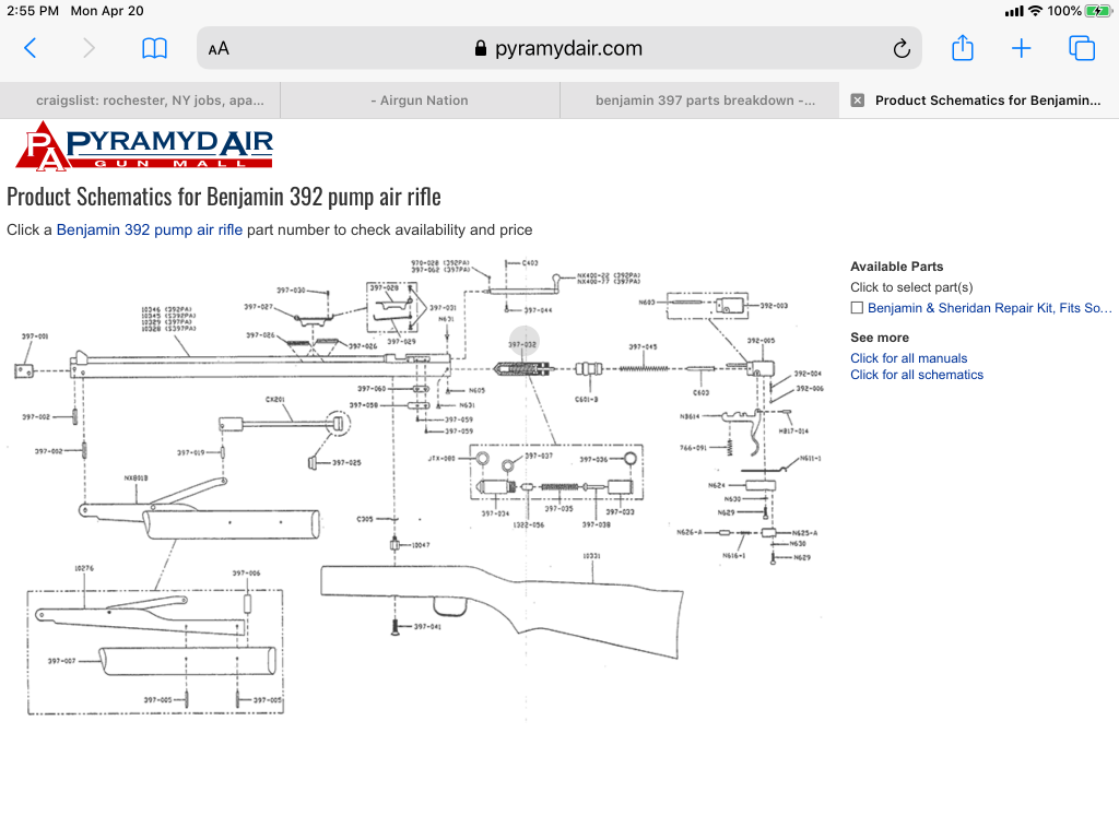

Nice free rifle ! Here is my parts breakdown.
