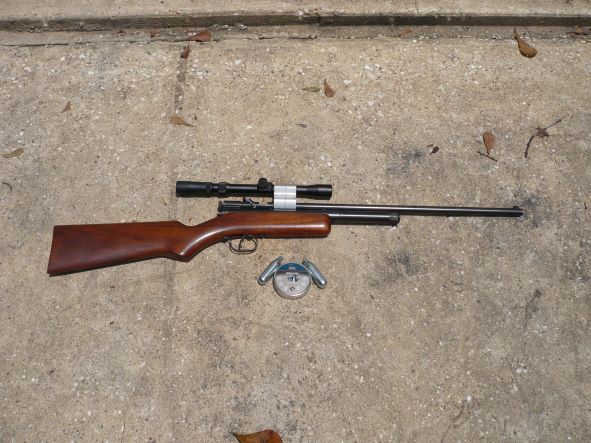

This Air Gun I am going to evaluate is a unit I added to my collection a while back, a Benjamin Model 362 CO2 Rifle .22 caliber (made approximately 1956-1969). I had been looking for one of these units for sometime and while I had came across several they were in such poor condition I passed on each, however this unit was in remarkable condition and all parts were there including the Bar-V Sheave sight, which as best I can tell, immerged on the 1959 production Rifles. The Benjamin 362 also had available as an option a deluxe Walnut stock which had an extended forearm, the unit I have has the shorter or regular forearm. They were advertised as the “Benjamin Super CO2 gas Carbine” with 2-stage High-Low Jet power (Two bolt cocking positions). Mine weighed 4.5 lbs. and was 34.5 inches long, a really light compact unit!

The B-362 that I acquired would not hold a charge and required a complete valve rebuild. When this was done I conducted some preliminary field tests to affirm that it was performing as it should. After determining that all was well in that regard I began setting up the rifle for the best potential accuracy possible. I installed a set of “Ron Robinson Classic Scope Mounts” and a Tasco ¾ inch 3-7x 20 scope, and adjusted the parallax setting out to 20 yards instead of 50.

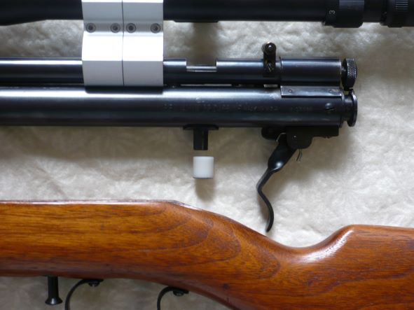

The next area addressed was the stock assembly stud, when these rifles were manufactured the hole drilled thru the stock was considerably larger than the assembly stud attached to the action for the assembly screw. I always machine a nylon bushing that is a snug fit in the stock that the assembly stud passes thru that removes all clearance when the assembly screw is tightened. I have found this improves accuracy and if necessary I will make a shim for the front of the stock that the action rests on, the goal is to bed the action in the stock so to speak, this is a step I take with all the old Air Guns of that era and has always improved the accuracy, in my experience.

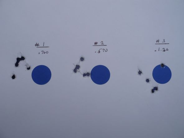

The accuracy test were conducted at 20 yards from a bench rest and revealed the B-362 capable of very good accuracy, I use card stock paper with ½ inch diameter adhesive dots, three on a target shooting left to right (groups are measured c-c). The first 4 shots went into .500’’ with a fifth shot stretching the group to .760”, the second 5 shot group was .570” the third group was shot using open sights ( remember the scope mounts allowed the use of the regular sights) first 4 shots measured .830” with the 5th shot opening up to 1.20” inches.
With the use of the Tasco scope and H&N HP 12.65 Grain pellets the B-362 is capable of sub .600 inch groups at 20 yards delivering 10.1 ft. lbs at the muzzle, this combo is lethal on feathered pest as well as rats, squirrels etc; at 20 yards they have no chance!! I can attest to this!!
