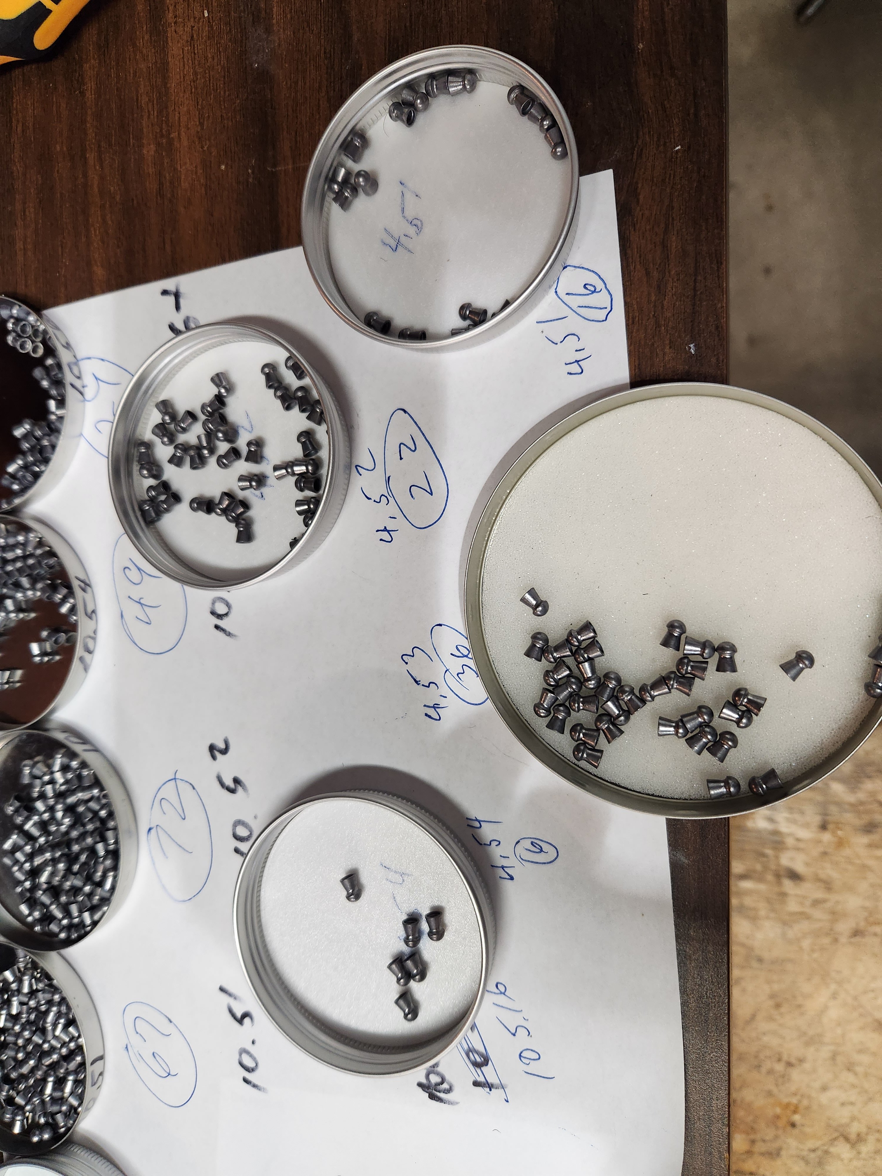

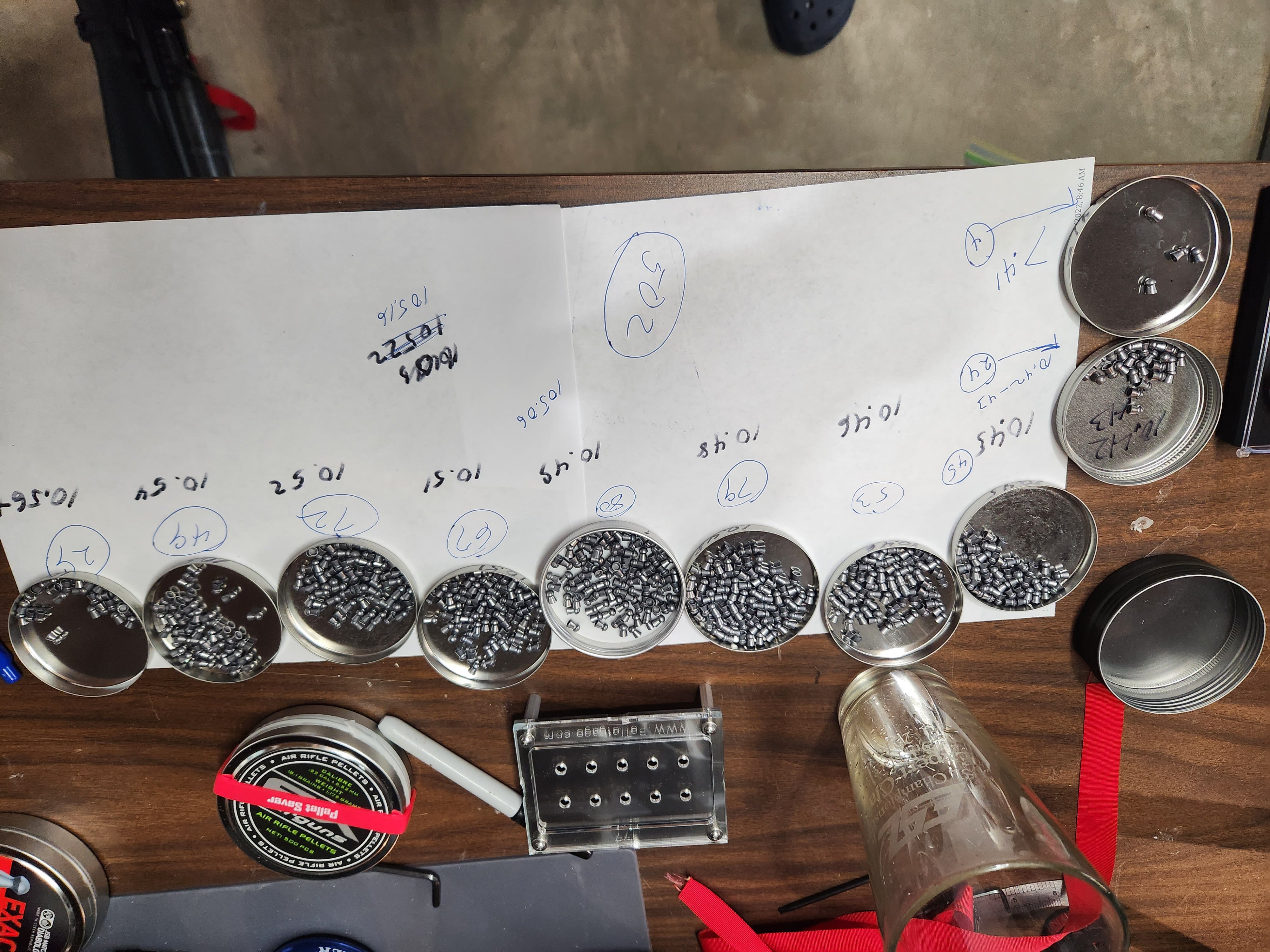

I weighted a tin of pellets and measured a few.
Strange my Amazon scale while repeatable and measures a 1 and 3 gram calibrated weights correctly it will not display 10.47 or 10.50 grain. 10 of the 10.49 pellets weighed together came out to 105.06gn.
4 <= 10.41
24 = 10.42 or .43
45 = 10.45
53 = 10.46
79 = 10.48
80 = 10.49
67 = 10.51
72 = 10.52
49 = 10.53
29 = 10.54 and up, heavy was 10.60
502 total
Then I measured the head size of the 10.49's
4.54 = 6
4.53 = 36
4.52 = 22
4.51 = 16
36 and 22 shots my be enough for me to decide if there is a real difference in this gun. Waiting for a perfect day.
4 <= 10.41
24 = 10.42 or .43
45 = 10.45
53 = 10.46
79 = 10.48
80 = 10.49
67 = 10.51
72 = 10.52
49 = 10.53
502 total
4.54 = 6
4.53 = 36
4.52 = 22
4.51 = 16
It wasn't fun at all.
Thats pretty darn consistent from a weight standpoint. All but 33 would be back in the same tin for me. I wouldn't have guessed there was so much variation in head size. I'm only basing that on how they felt being loaded though.

Measuring head size with a 'Pellet Gage ' is an art rather than science. There is minor variations in roundness and some could fit by moving the head around a bit in the hole, I thought that was cheating so if they didn't almost fall in they went to the next size.
I'm no expert at this.
I've had the same concerns with the Pelletgage and pretty much gave up on it because of it. These days if I load one and it feels off I just shoot it away and load another. Either way, thank you for taking the time to do the heavy lifting for us.
