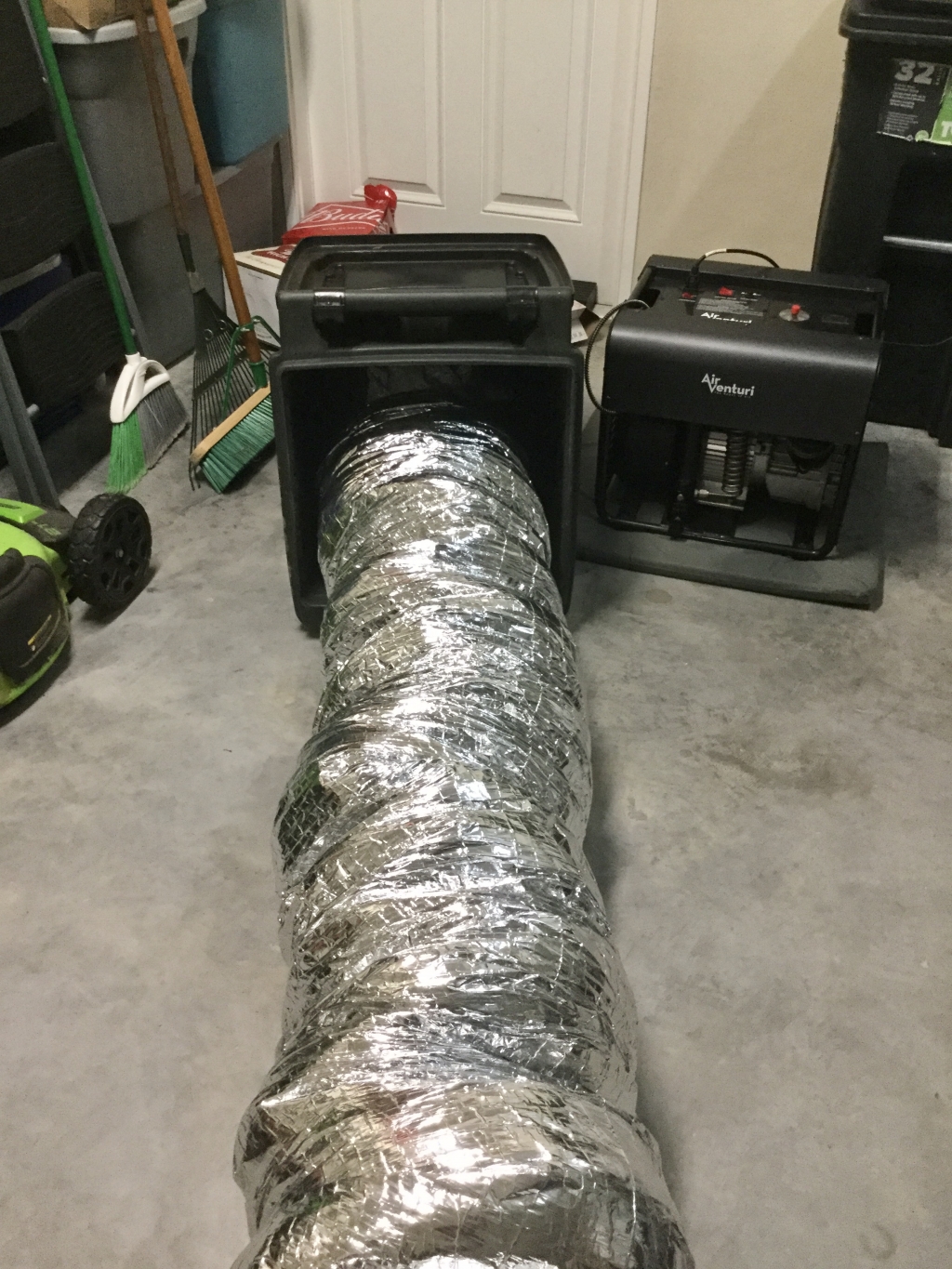

Not exactly bench top yet, but if it’s late and you need some numbers..
10” insulated attic ducting from lowes
should mention, bayonet style chronograph in this case
use your own throw pillows

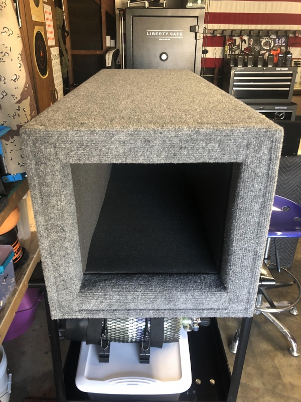

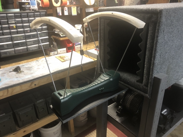

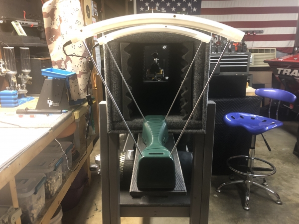

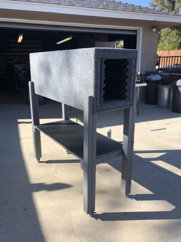

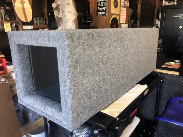

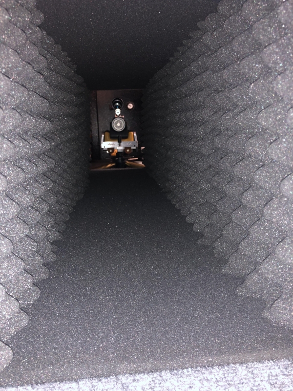

Are these the ones your after John??

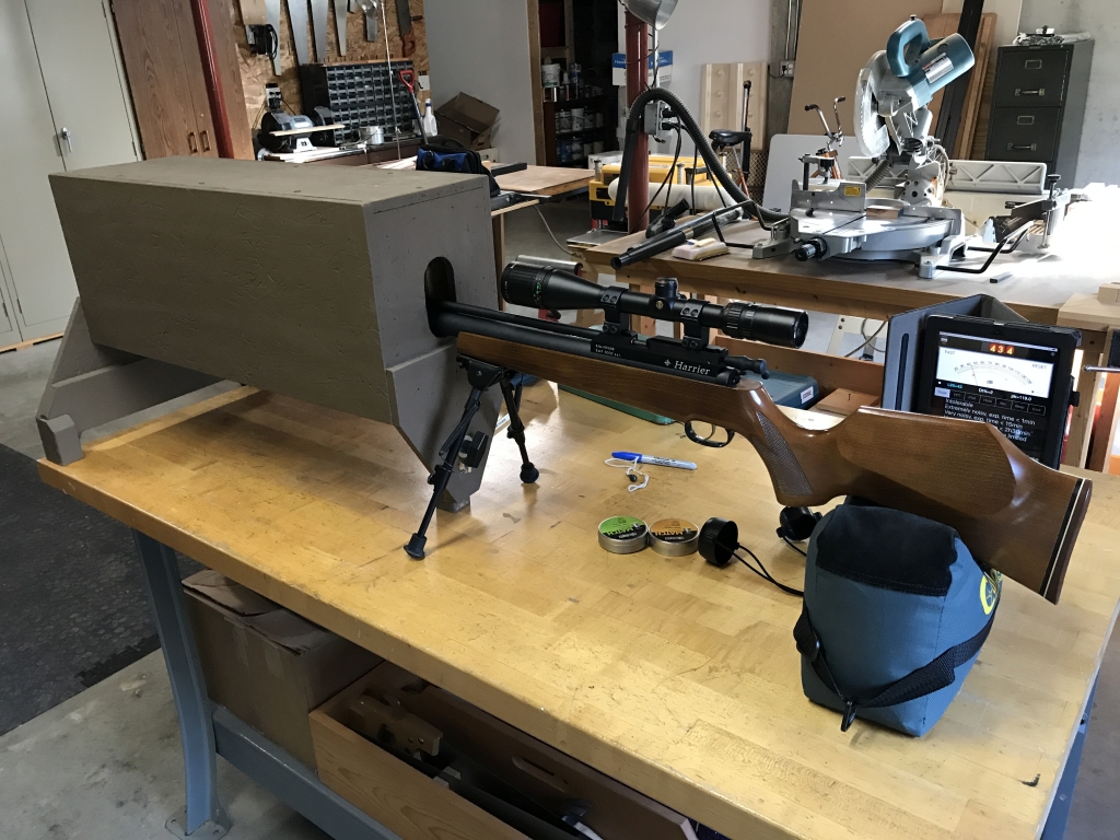

Here was my attempt. I originally hoped to use it for centerfire, but it didn't do much. But it does work for air rifles indoors if that is what you are looking for. It is just a simple box made of OSB. I tested it with and without padding and got these results.
So the padded box reduced the noise by 12 dB, and since a reduction of 6 dB cuts the sound pressure in half, both Max and peak noise were reduced to about 1/4 their former values. For the test I just used old towels for padding the inside. Some combination of heavy felt and acoustic foam might work even better. The box dimensions are 28" X 11" X 9"W. I don't know if I made it bigger than it really needed to be or not. I am pretty sure that keeping the size of the openings as small as practical helps considerably to contain the noise.
