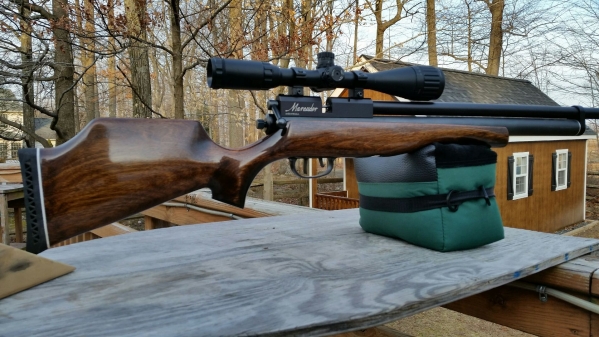

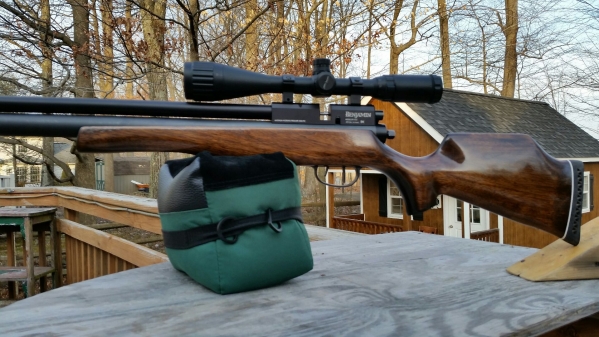

I've refinished several stocks, both Marauder and Disco. I hate the shape and balance, I usually thin the stock by running it thru a table saw. This reduces the overall width, then I re-run it against the fence taking the belly out of the stock leaving just enough meat to cover the gauge. This reduces a lot of weight and slims the profile down. A round over bit removes more weight in the foreend. On a couple I ran the table saw blade within inches of the gauge, then finished with a chisel and sand paper. The wood itself is usually uneventful, and rather plain. If you choose to darken it, a Walnut, Jacobean, or Ebony can do it nicely. I did a couple of Disco's with a boiled linseed oil, opting for the natural blonde wood. They came out different not interesting. The grain tends to be non descript, I finished several resin cast doors, using a variety of gel stains that brought more attention to the finished product. Joe Rhea did some stocks using the different stains, and to bring more contrast he lit a few on fire. Another nice trick is to hit the grain with a wire wheel, this removes the soft wood in between the grain lines. Highlighting this in a darker shade, then lightening shades with additional coats brings depth, but the weathered layered finish does not look good on a gun stock. In short your starting with cheap non descript grain, that in the past 100 years has not found it's way into he furniture market.
"guod123"I've refinished several stocks, both Marauder and Disco. I hate the shape and balance, I usually thin the stock by running it thru a table saw. This reduces the overall width, then I re-run it against the fence taking the belly out of the stock leaving just enough meat to cover the gauge. This reduces a lot of weight and slims the profile down.
I did mine with a disc sander, a rasp and then hand sanding. Took over a pound off. Then "conditioner, stain and Tru-Oil
Reactions: NMshooter
That white bootline on the butt pad sets the stock off, I drilled out a 1 3/8" hole in back of the comb put finger wells and a slice of birds eye maple. I cut the forend shorter also and put a slice there. I for the life of me can't get the factory butt pad off. It's been collecting dust. I don't feel like investing in a high end butt pad the Marauders don't see much action. That Tru oil looks great in a photo, I know the product is WAY better looking up close, nice work.

"BigTinBoat"
Wow that looks really great! I sure wish my Gen 1 Marauder looked that nice. I've had it since around 2010 I think. It has been through the wringer, but I still love that gun.
