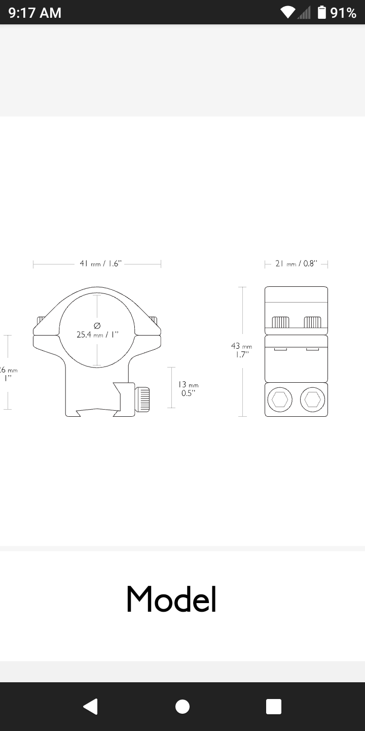

Most adjustable rings are probably higher than you need. Unfortunately, there is no standard for designating ring height. One company's low might be higher than another company's medium. So, you have to experiment. Some ring makers define their heights by specific reference in their web site. In those cases, a quick measurement will identify the minimum height needed for clearance, but with a couple of caveats. The objective end will be over the barrel, and barrels are not located the same in all rifles, relative to the mounting surface of the scope. Also, clearance issues aside, your eye position is critical, so you might need rings considerably higher than the minimum to obtain proper fit. It's kind of like Churchill's comment about Russia, "a riddle, wrapped in a mystery....".

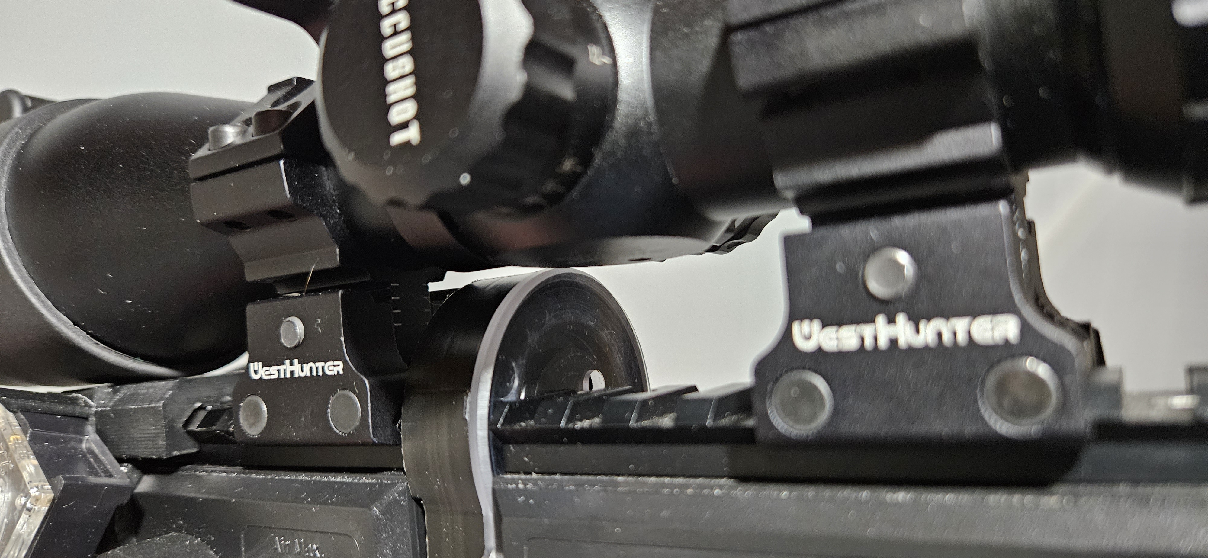

FX you can slant them I think but the WestHunter adjustable ones I have on my Avenger and Notos were 1/3 the cost of FX and work fine. That's right though the WH ones were, per the Amazon listing, collapsed height at 32mm center raised height at 38mm center so maybe they won't work for this application.

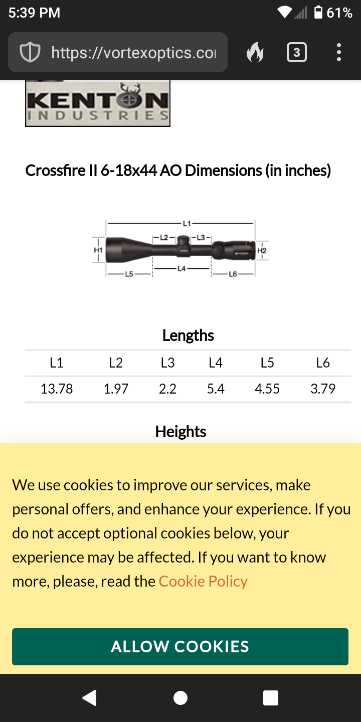

That's why I love the scope ring height calculator website I linked, you can tell it objective bell end size and if you're using lens caps and also if you have any MOA built in and also if the rail is flat all the way out or if the barrel is tapered/lower than the rail height further out where the obj end goes.
You can either do all this measuring or buy low and medium UTG, Monstrum or other low cost rings and like mentioned by Jasonmc and get different guns with other scopes and it'll work out for something in the collection. Lol

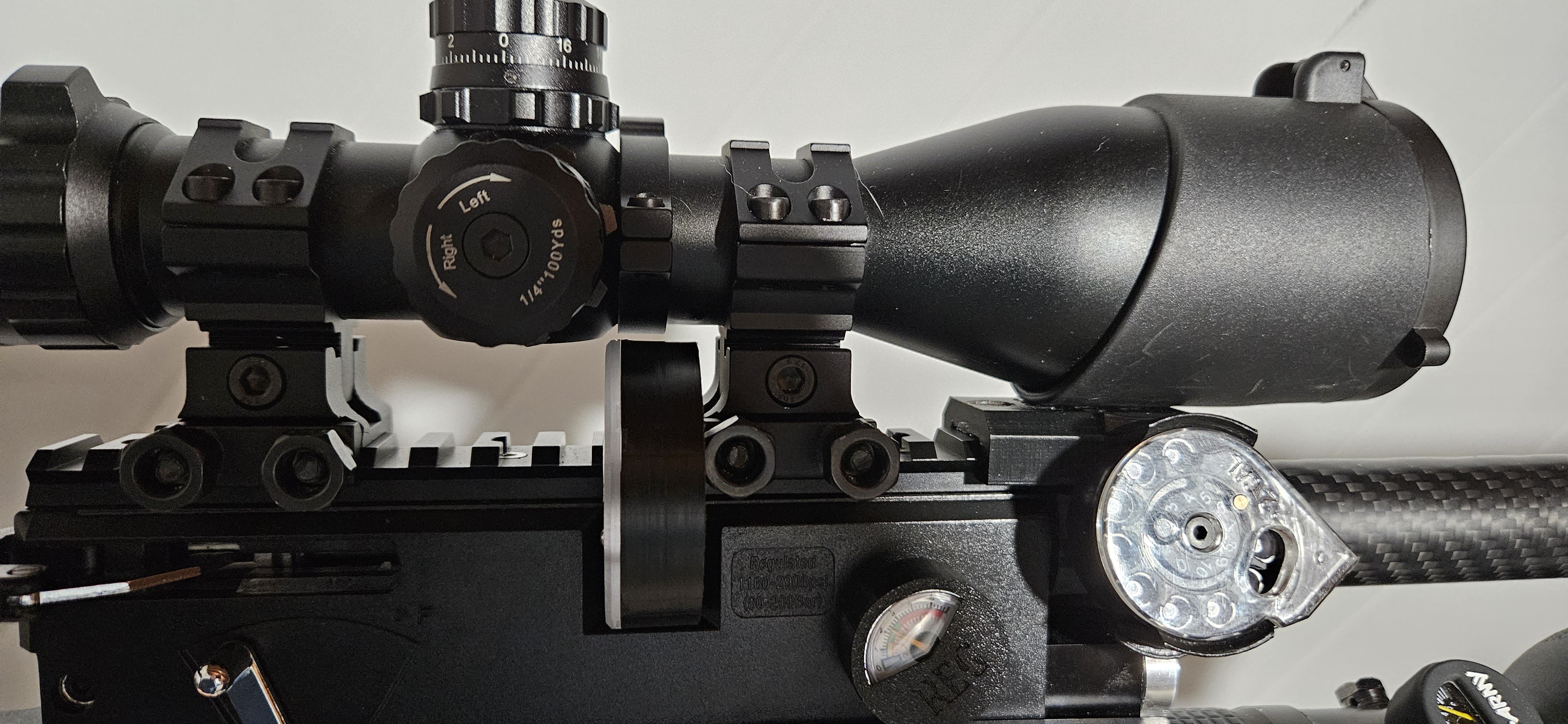

I see what CAB is worried about, the magazine hitting the scope, I'm going to guess at mediums or the adjustable's.
Yeah…they are close to .9 height
As I recently found out- even though your objective lens clears no problem, your magazine might not clear the bottom of the scope especially if the base of the scope that houses the turrets are above the mag slot.
These scope calculators and the info that the scope ring manufacturers provide do not take into consideration magazines used for PCP. It’s just a measurement from pic rail to ring center height.
Your safest bet if you don’t want to buy multiple sets is to go with what others suggested and get height adjustable rings like the fx no limits
Reactions: EmptyTin_Tim
Personally I've got some FX's I'll give to anyone, no I won't I'm tossing them in the trash, there is something wrong with them, I ran out of windage, the Amazon adjustable height ones work fine, have some of them too.
