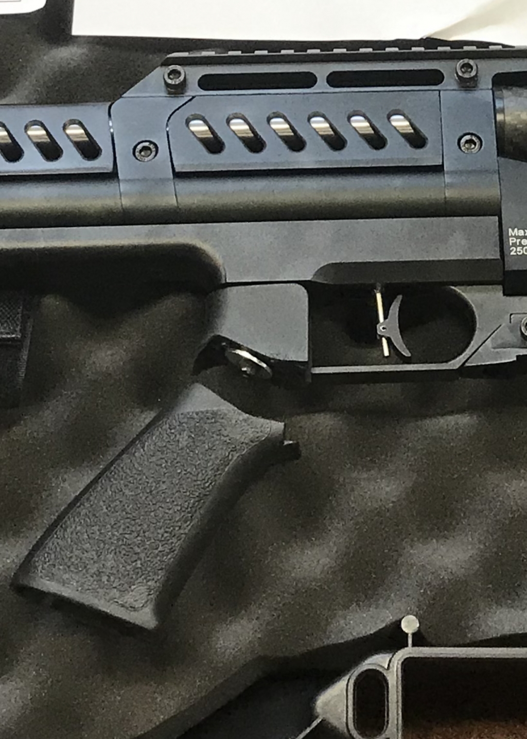

Waited for UPS to deliver and anxiously opened it up to find my grip had snapped in half
I was like WTF, how does this even happen with it strapped into the hard case and the case also in a cardboard box. So i shrugged it off and contacted the dealer, who by the way was absolutely awesome and shipped me a new grip and I received it very quickly 2 days later. The only thing I can see happened is UPS dropped the box so hard it cause the grip to somehow snap off
