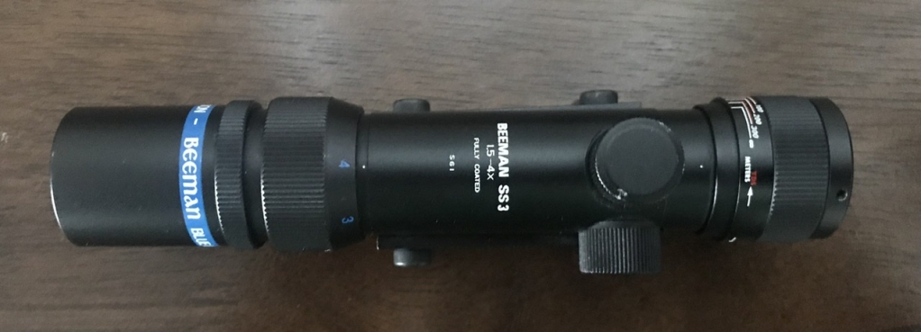

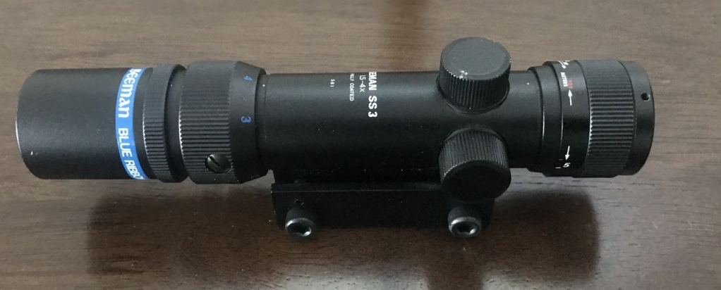

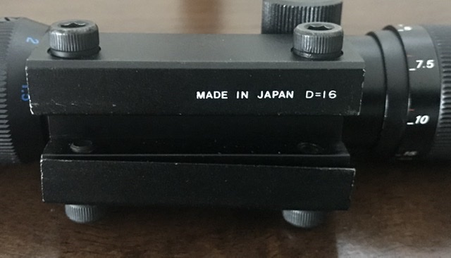

I have an SS3 but it only came with one set of the pins and unfortunately they don’t seem to be the right ones for dovetail spacing.
