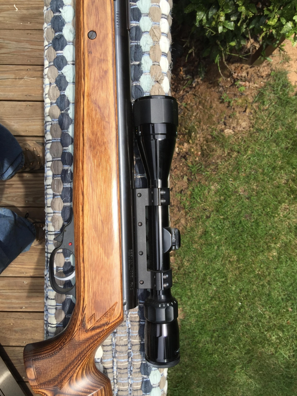

I bought an RX2 in .20, used, a few months ago. Golden State Airgunner guessed about $500 and that's pretty close to what I paid for mine and it's in pretty nice condition.
It is a very nice airgun. FPS spread is in the high single digits so it's slightly more consistent than my only regulated PCP. I've got the ram set for 790-800fps with the JSB 13.73, that seems to be the sweet spot for cocking force/recoil/velocity.

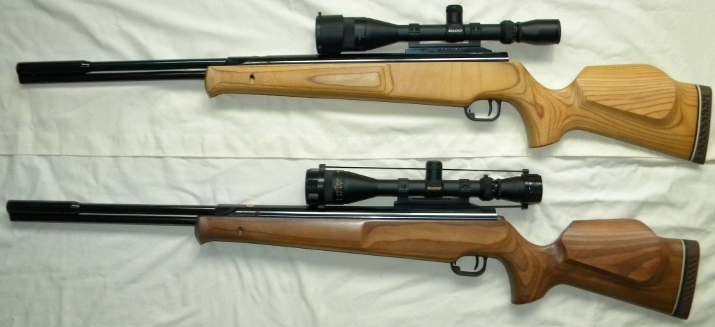

A few things; the pump was only to be used to service the rifle to its factory limits but so many went way above and wondered why it was hard to cock, why seals were scorched and others where seal were blown out in the ram itself. The RX series in factory form should be no where near 60 lbs to cock, the Eliminators are about 50. The Theoben underlevers you mentioned are called Dual Magnums and only came in .22. One stroke was 840fps/24fpe with 14.6gr and the second gave 1040fps/36fpe with the same pellet, they are the most powerful factory made piston guns to this day. The internal function was simply to push the ram further back in the compression tube for more swept volume, there were only about 104 ever produced. The Whiscombe is quite different in that it can only be fired at only one power although more than one stoke is needed and are recoiless dual piston rifles. More Whiscombes were made than Dual Magnums. Here are my 2 Dual Magnums- Beeman marked (top) and Theoben bottom.
