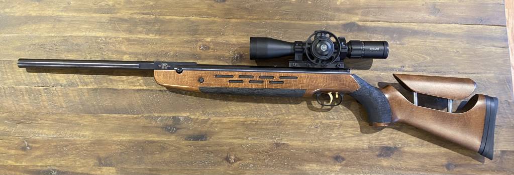

What happens when a Beeman R9 .22 meets a HW98 stock and .22 shrouded barrel? You get a Beeman R98!
I ordered the .22 98 barrel from Chambers way back when I purchased the HW98 in .20 for fear of hating the caliber, but the .20 is perfect and the spare .22 has been just that, a spare sitting on a shelf for over a year. My HW98 is currently broken down awaiting a new stock from Craftsman Vit so decided to get creative.

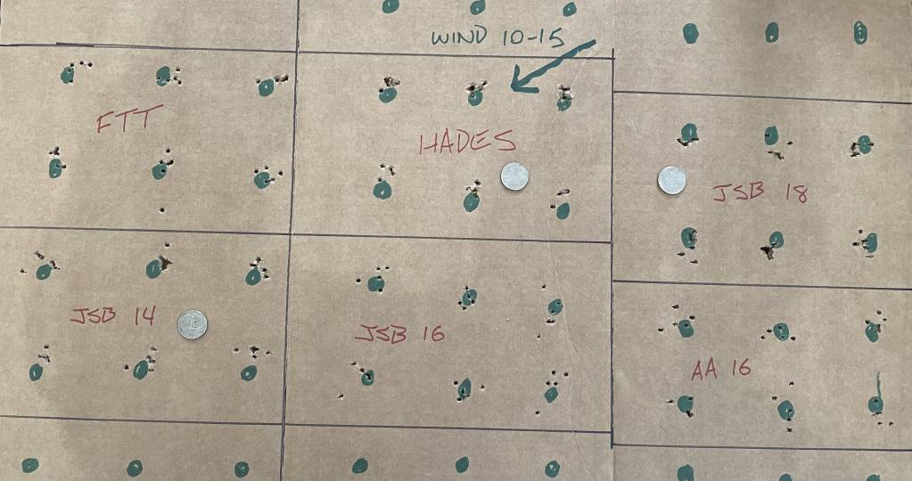

Today was not at all ideal conditions to be pellet testing but I did it anyway. Temperatures in the 20’s with 10-15mph winds, had to take a few breaks and warm up in between groups.
I was most surprised by the JSB Hades, I only have one other rifle that shoots them decent. Taking the wind and temperature into consideration I think the barrel is pretty solid. Ran the pellets over the chrony this morning and these are the results:
FTT 730fps 17.3fpe
Hades 700fps 17.3fpe
JSB 18’s 635fps 16.2fpe
JSB 14’s 695fps 15.4fps
JSB 16’s 675fps 16.1fpe
AA 16’s 680fps 16.1fpe
This rifle is running a vortek PG3 kit and seal and has been a pleasure to shoot since it was installed and has about 5k rounds through it.
