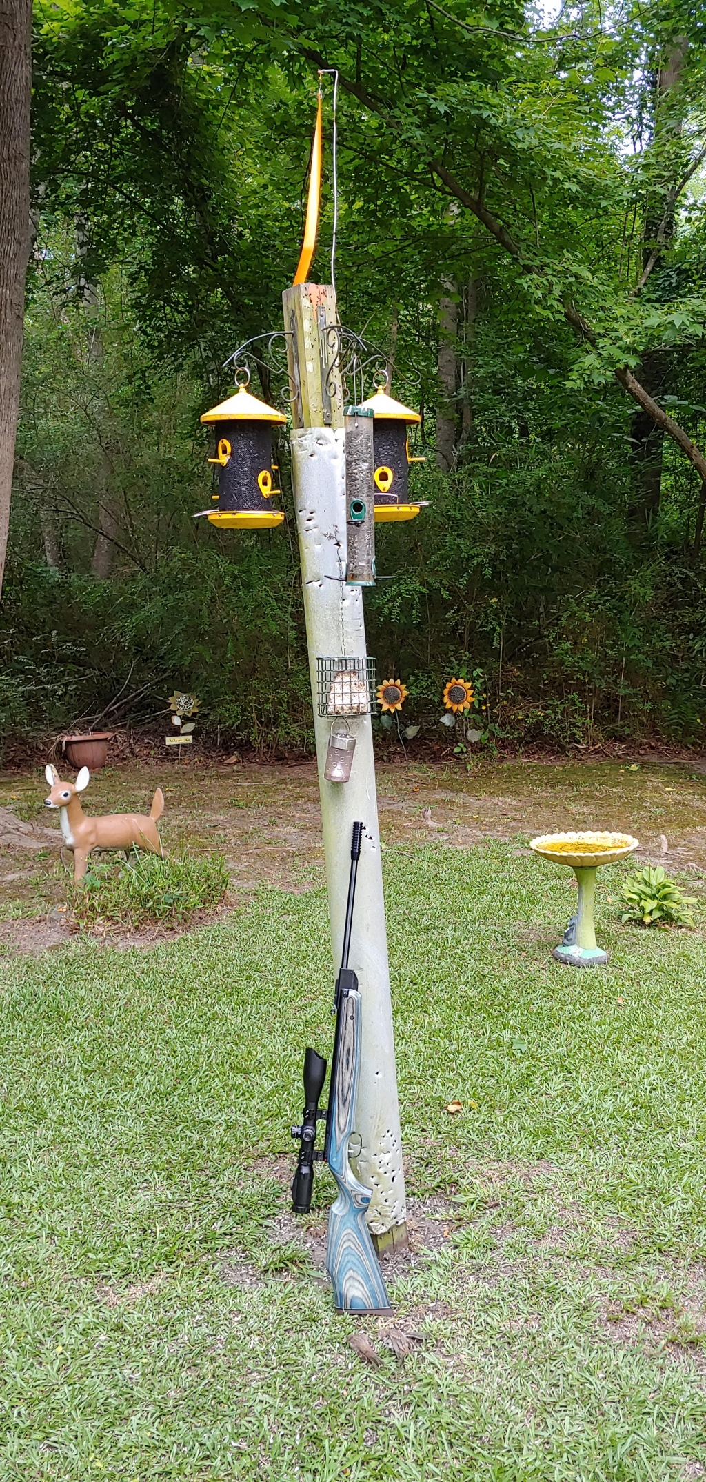

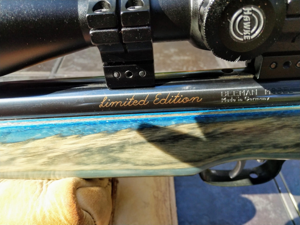

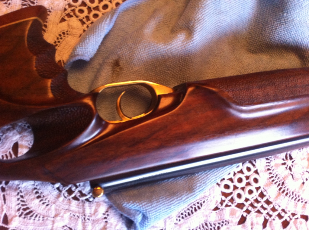

Nor sure about weight but you would be hard pressed to fine a better Springer. The rekord trigger amoung best in business. This one love jsb 8.4 head size 4:53 @ 860 fps mv and brain dead accurate out to 50. The r9 should be part of your collection. A must have imo.
Wow, never seen an R9 with a laminate stock. Nice
Ray
