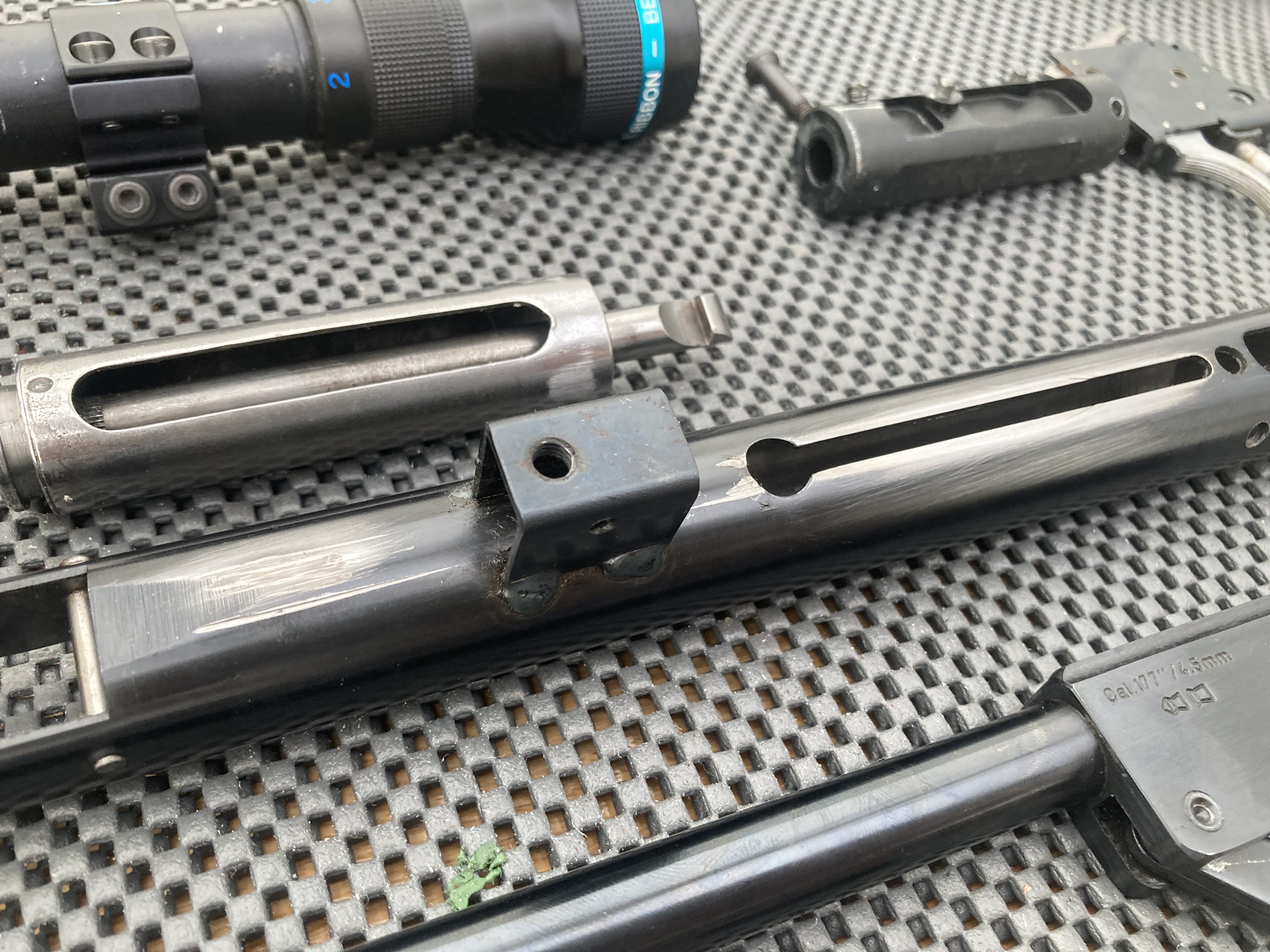

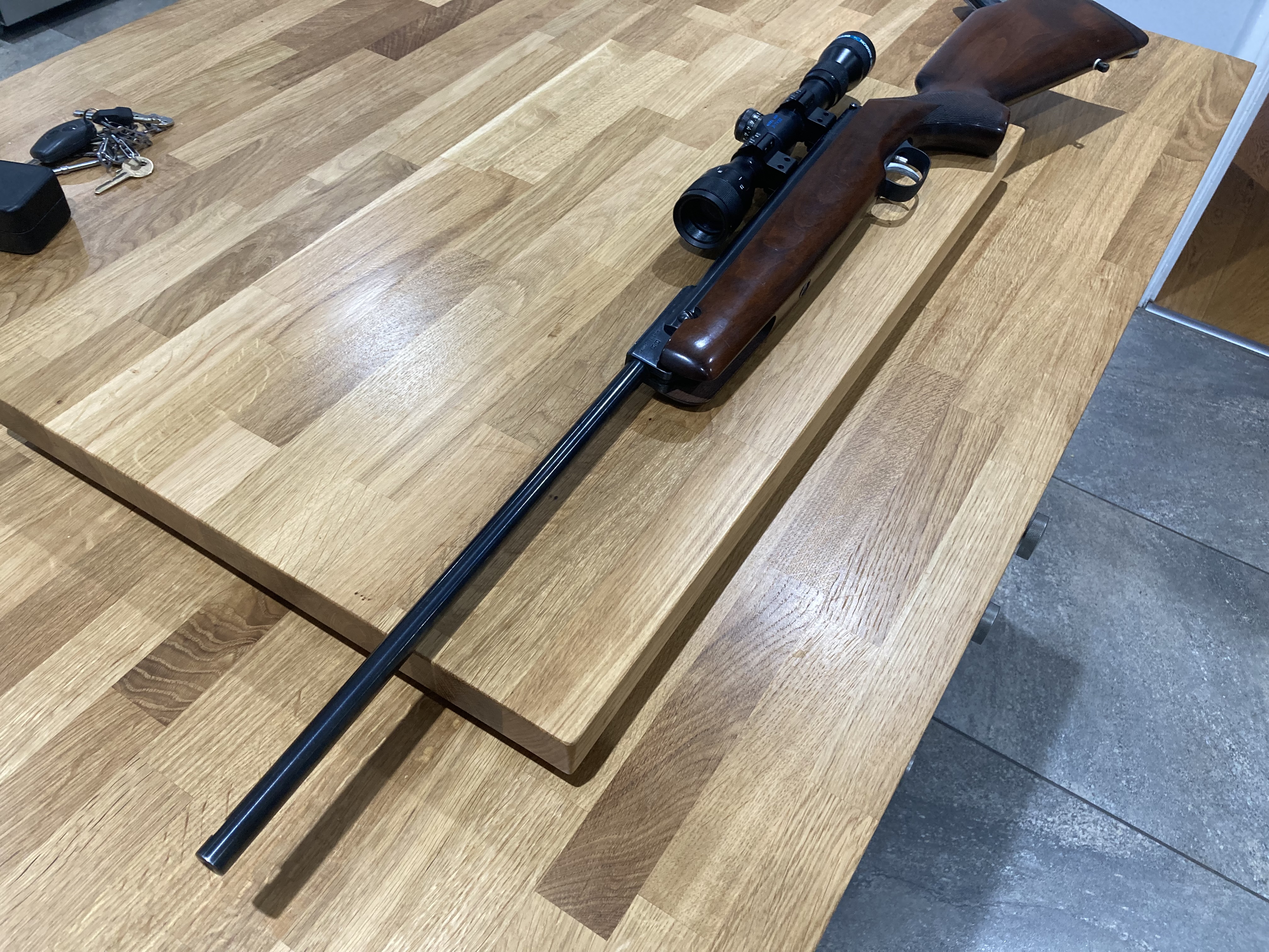

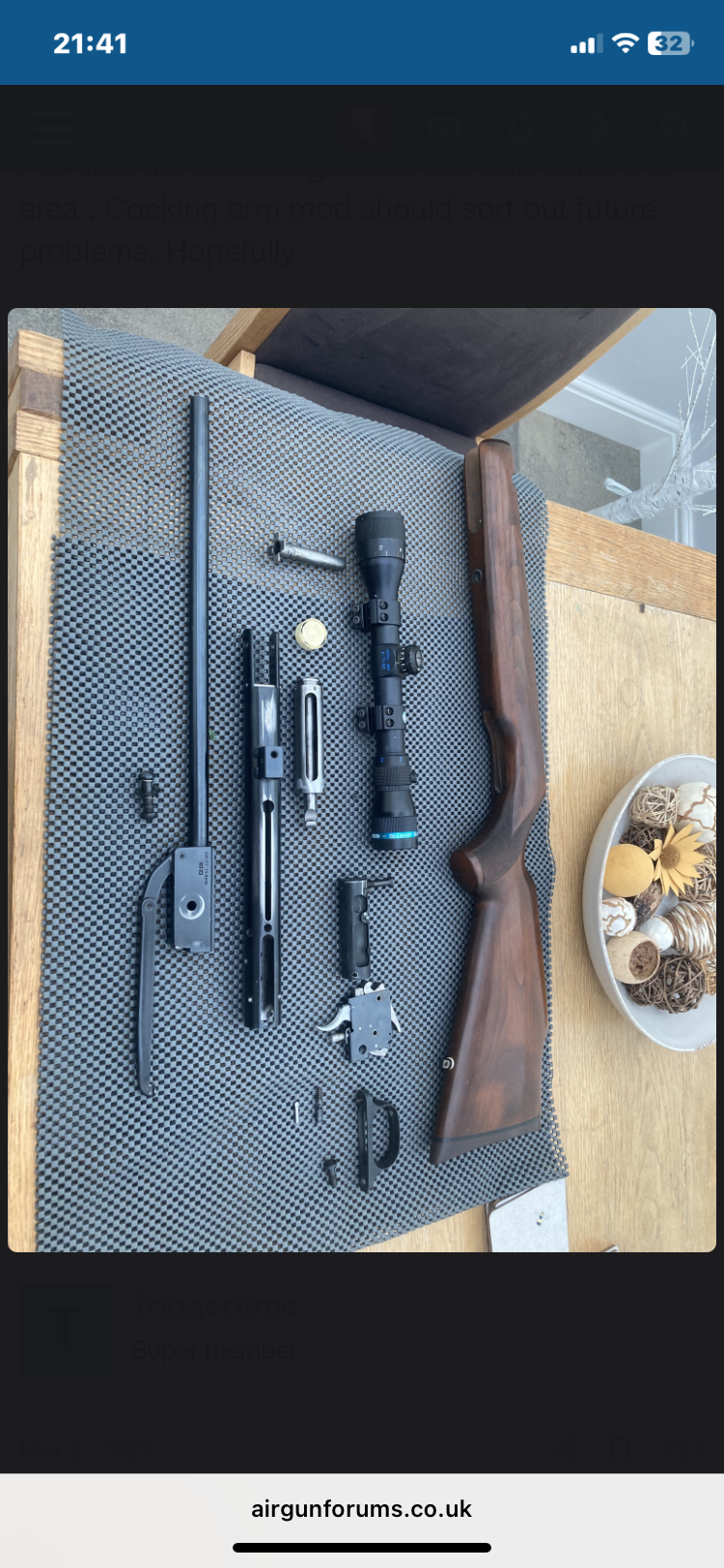

This particular r7 in 177 had been doing a good job of eating itself suffering from dreadful galing. A comprehensive strip and rebuild was the order of the day .

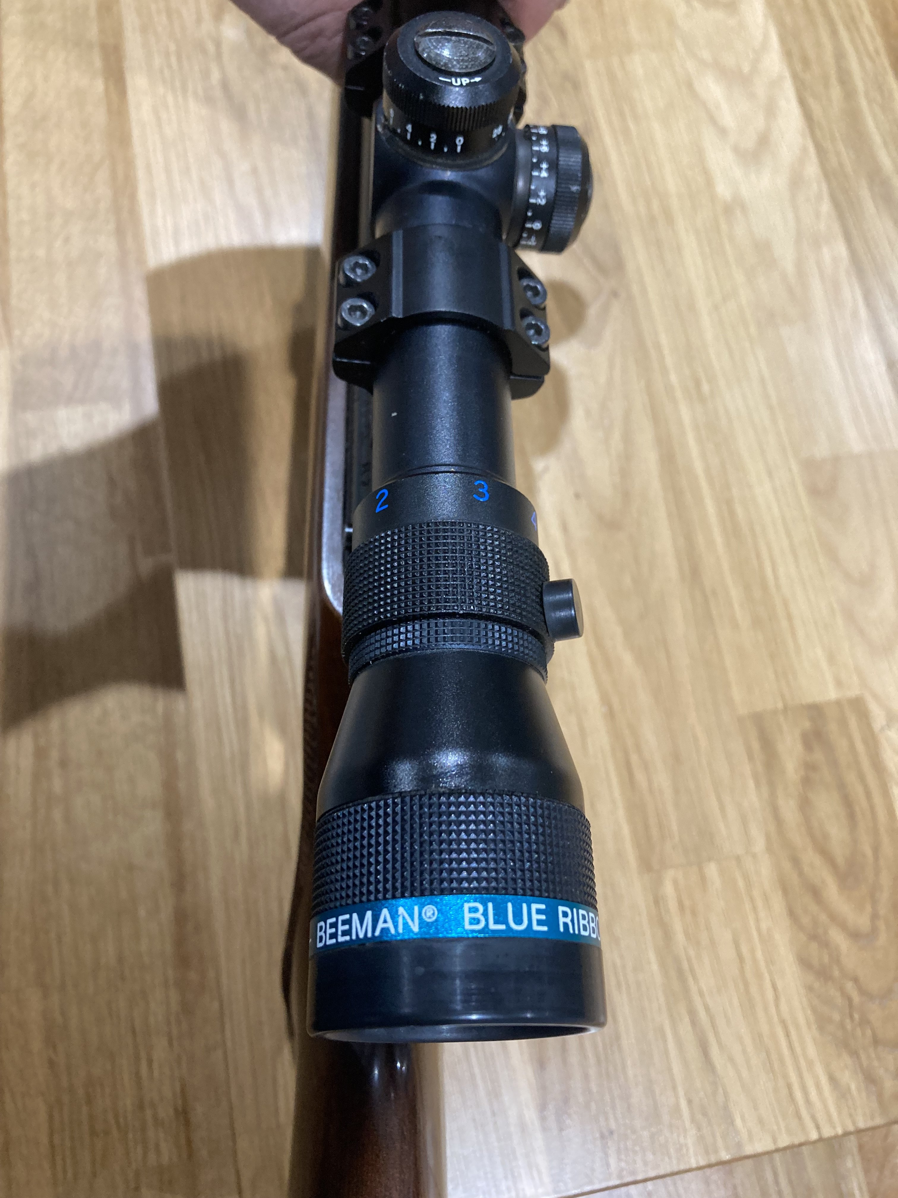

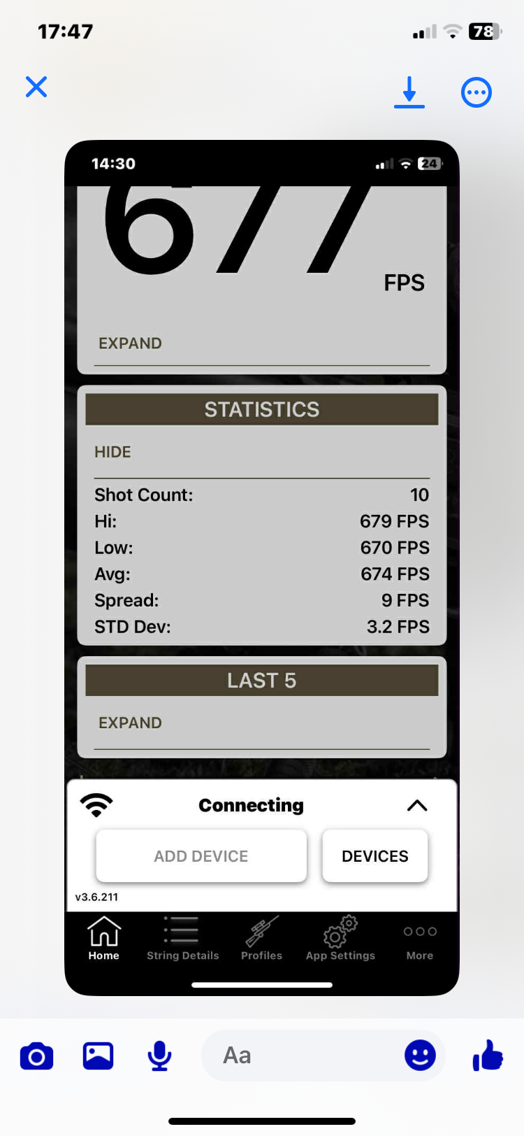

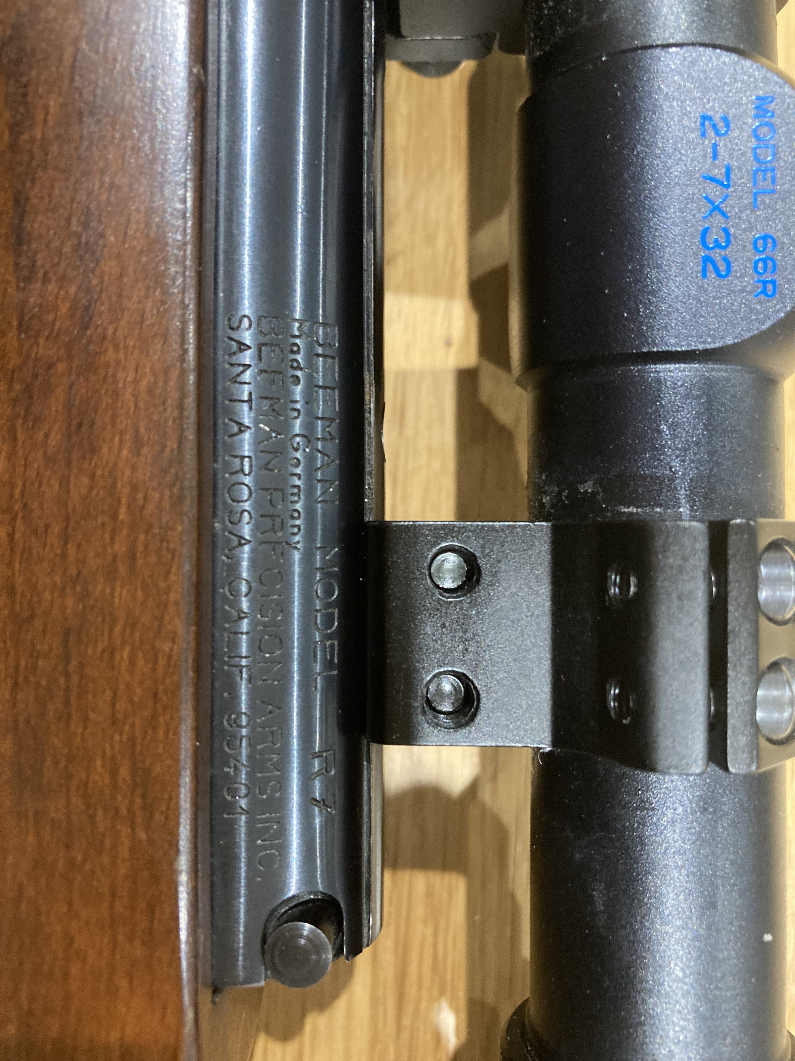

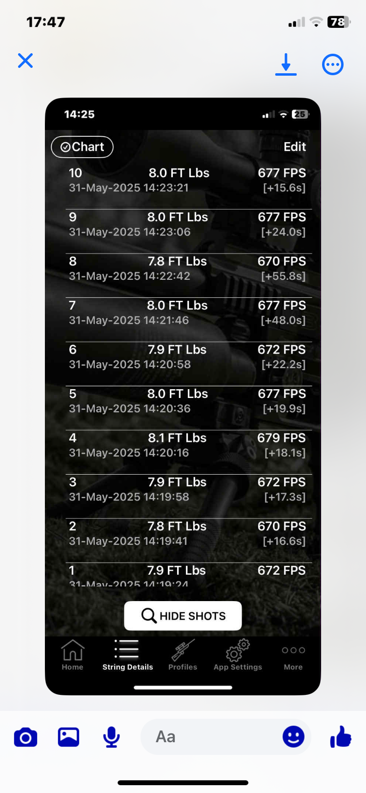

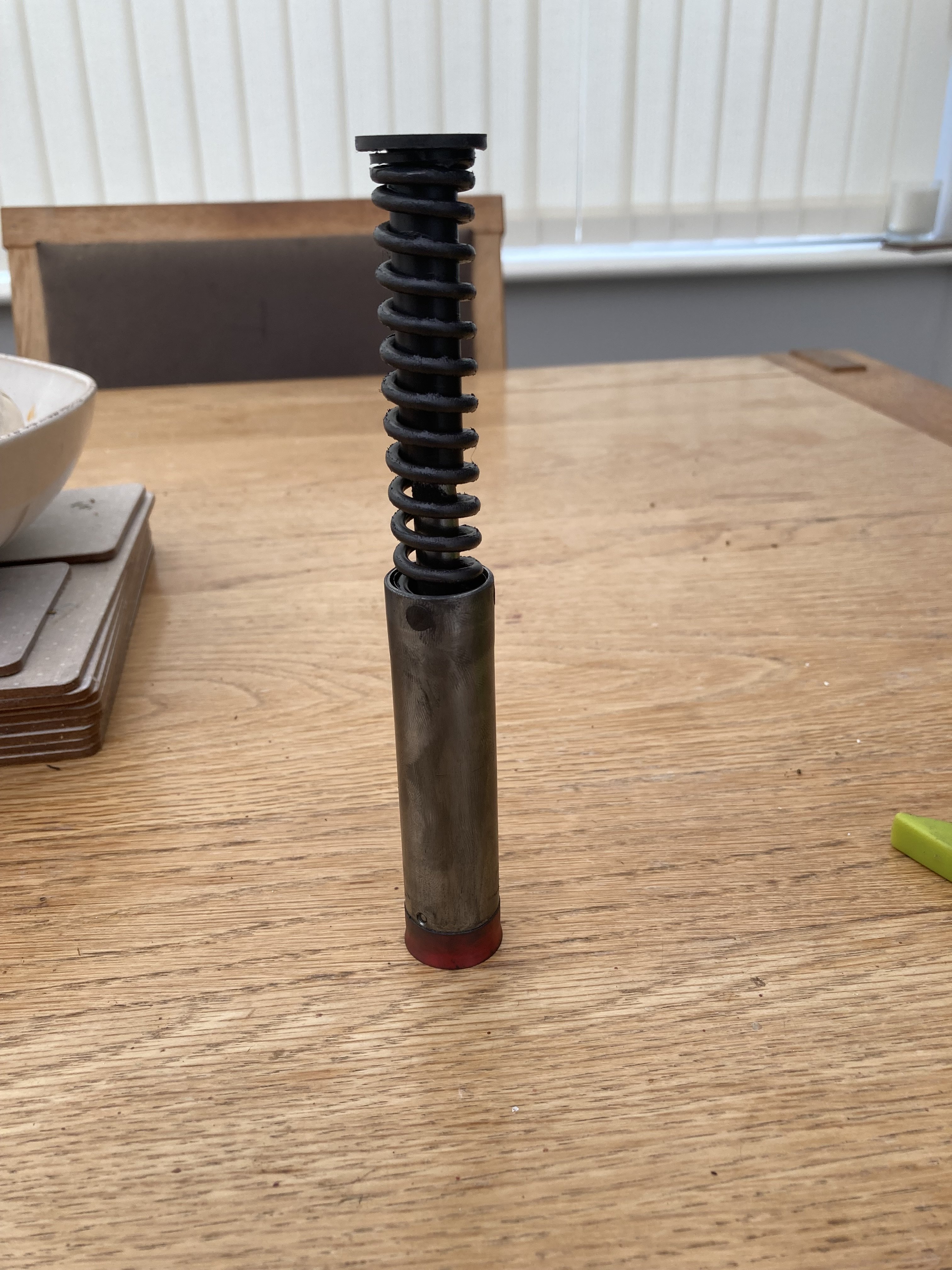

A cocking arm modification was done including how it’s retained ,got rid of that pin and added a set screw adjuster .the piston was turned down and rear buttons added to the skirt the original spring was good so custom guides made along with top had . Deburr on all slots .seal wise 25mm Brit seal with their breach seal . Rifle is back together and shooting nice very consistent over the chrono @8fpe What’s really nice the rifle was bought with a blue ribbon scope which is excellent. I’m missing the dovetail front sight can’t find one in the uk so hopefully I’ll have better luck searching in the US 🇺🇸 a few pics
Any pics of the arm / pin set up with the set screw … it’s a hurdle with that platform and the 99/50 articulating arms.
A pal has borrowed the rifle Chris so I can’t whip the stock off to show images but I can explain from this pic . I freed up the cocking linkage knuckle and reduced the arm sightly, re profile the ear on the arm and added a delrin insert to the arm similar to the new 99/50 . The strip only needs to be .5-1mm proud of the arm . I found the location of the pin a pain as it’s a fraction to low with the strip fitted. I scraped that and added a brass m6 set screw behind the pin location and forend locator. You can dial in the fit and tension to the arm so you achieve a nice smooth cocking cycle , when happy locktight in . Works well far better .
Goo
