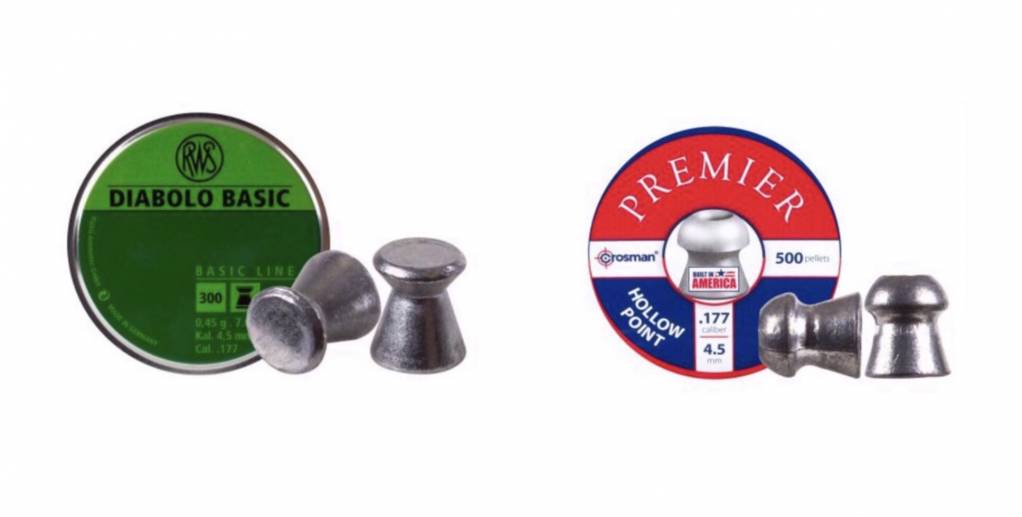

Pellet selection depends on what purpose and how accurate you need to be. Target shooting my R7 likes RWS Diabolo Basic. “AOA”. In the wind/pest control then Crosman Premier Hollow Points. “Walmart” Both cheap and accurate. Been using these two for a over a decade
