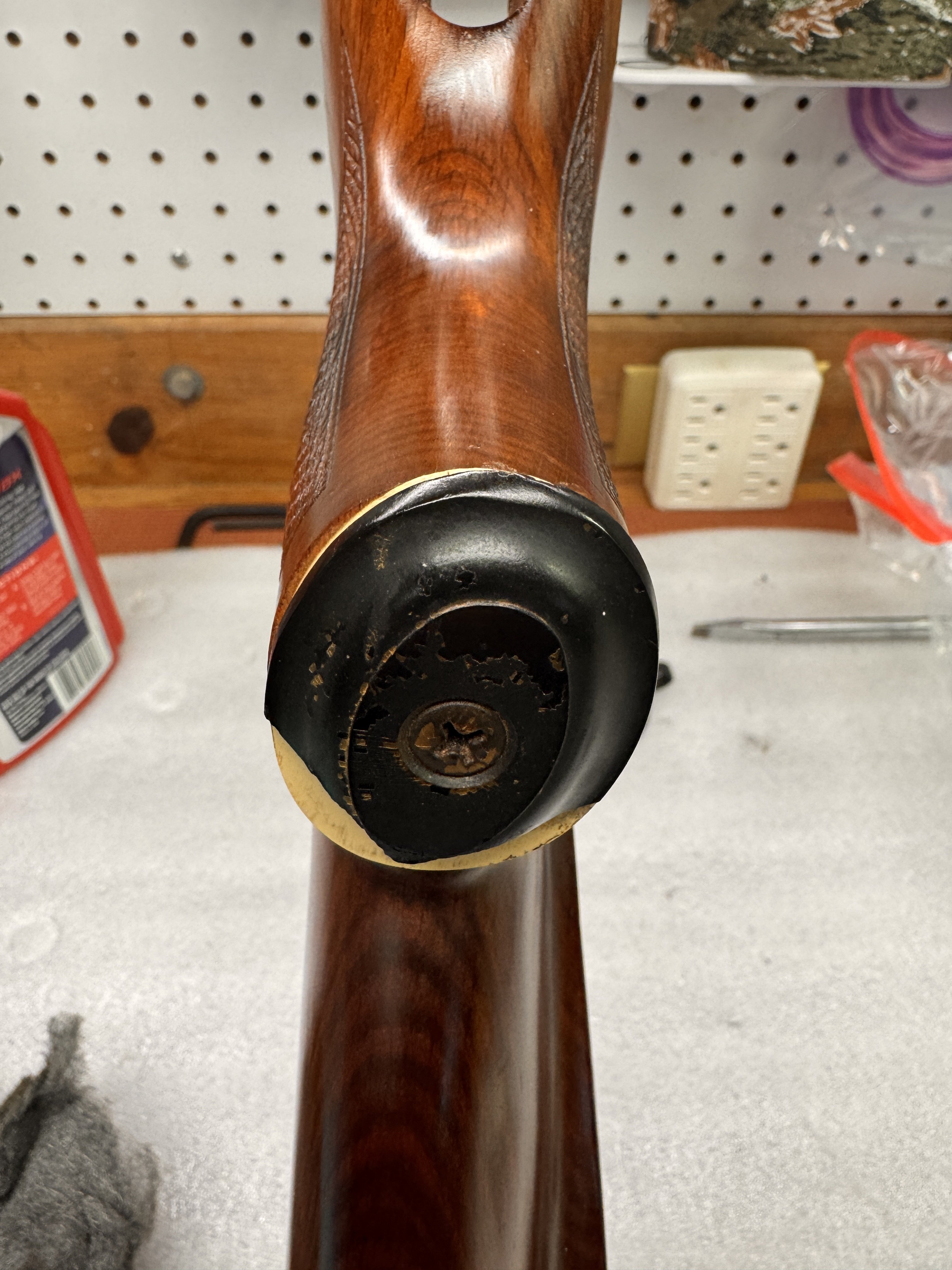

Hello, does anyone have or now where I could get the ( for lack of a better word) the black pistol grip cap on a beeman R1

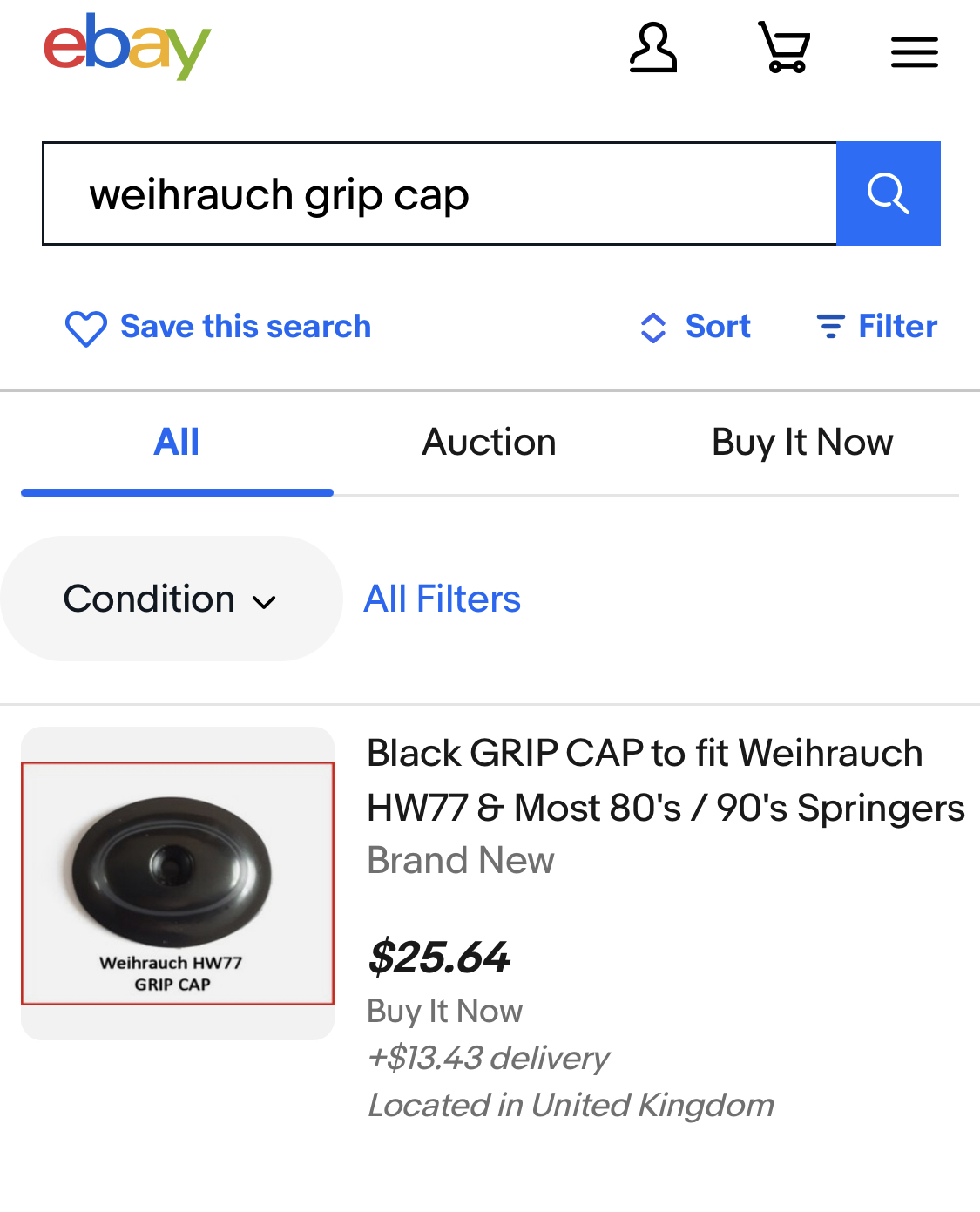

thank you all for your responses
I've been looking on eBay. i can't seem to find it.... I also look at a few other places.
there are many available. But i don't seem to see any made for beeman/weihrauch
midway has one that will work.
i think making my own will be the best option. was trying to keep it all stock... ( no pun intended )

If you make it just a bit (1/16” all around) larger than the pistol grip, it looks nice and professional. you won’t disturb the original finish trying to sand it in to match up perfectly. I used to remove them and make new ones out of aluminum. Oversized them a bit, round the edges and polish to a mirror finish. Then used a polished aluminum or stainless screw. Looked really nice. Good luck. Please show us your finished project.
