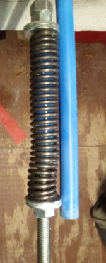

If you set the spring for about 4-8 hrs or so it's not as bad a fight .. that one that got away on me was one I got in a hurry and did not set the spring / fresh new full length..
Make a scragging tool and set the spring ( I made a guide to keep the spring straight when compressing )😉

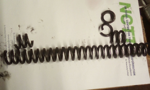

My hw's with a broken spring still shoots pretty good ... It's not hard to snatch the stock off and look or just pull the spring and then inspect the seal ..
This spring for example shoot spot on but maybe 760+/- fps .. lol
You'd be surprised how well a gun with a broken spring can still shoot and sometimes you may never know it ...lol
