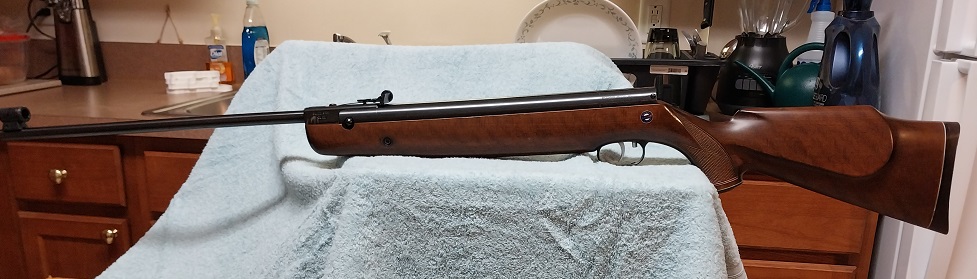

Does anyone know when Beeman introduced the carbine version of the R1? I just purchased one with a Santa Rosa address and can not remember If any were offered with the SanRafael address. I wish I had put more effort into getting all of the catalogs when they were available.
Yes , for awhile Beeman was out of San Rafael . You got a good gun there. .22 caliber? Swept volume of the R1 aka Hw80 is designed for .22.

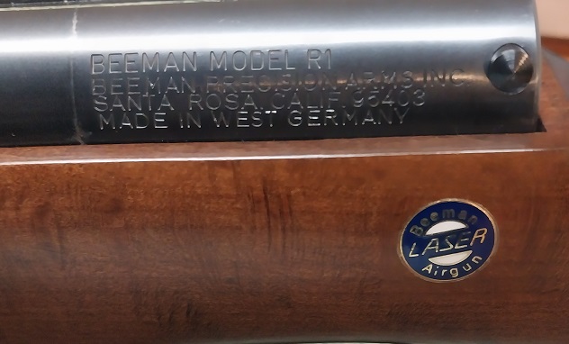

Got one myself not long ago. .20 caliber Laser version with the Santa Rosa address the data base says was built in 1990.

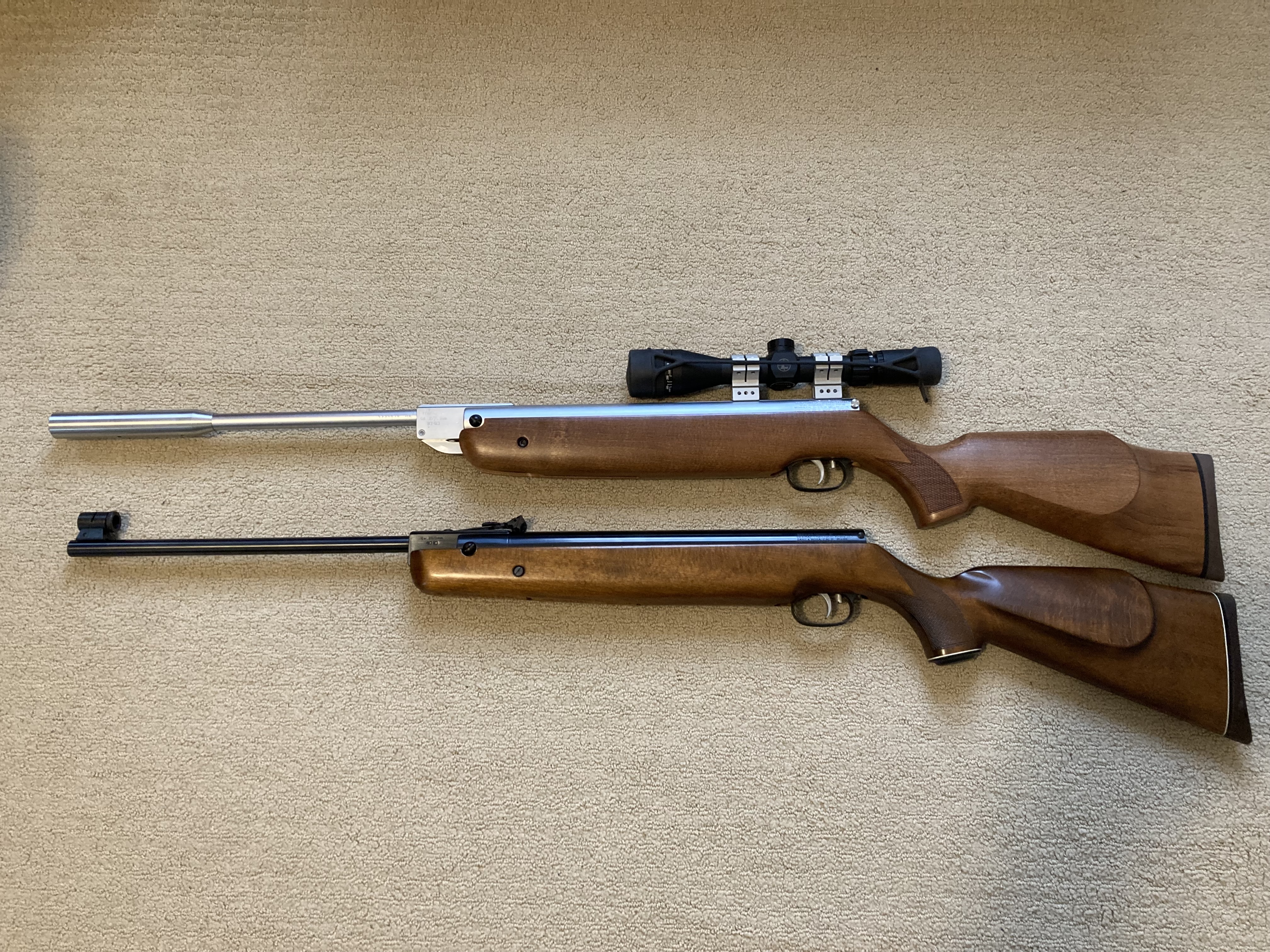

Thanks! Not my only one. I've got an older R7 .20, R8 .177 and R10 .20 to go with it...so far...lol

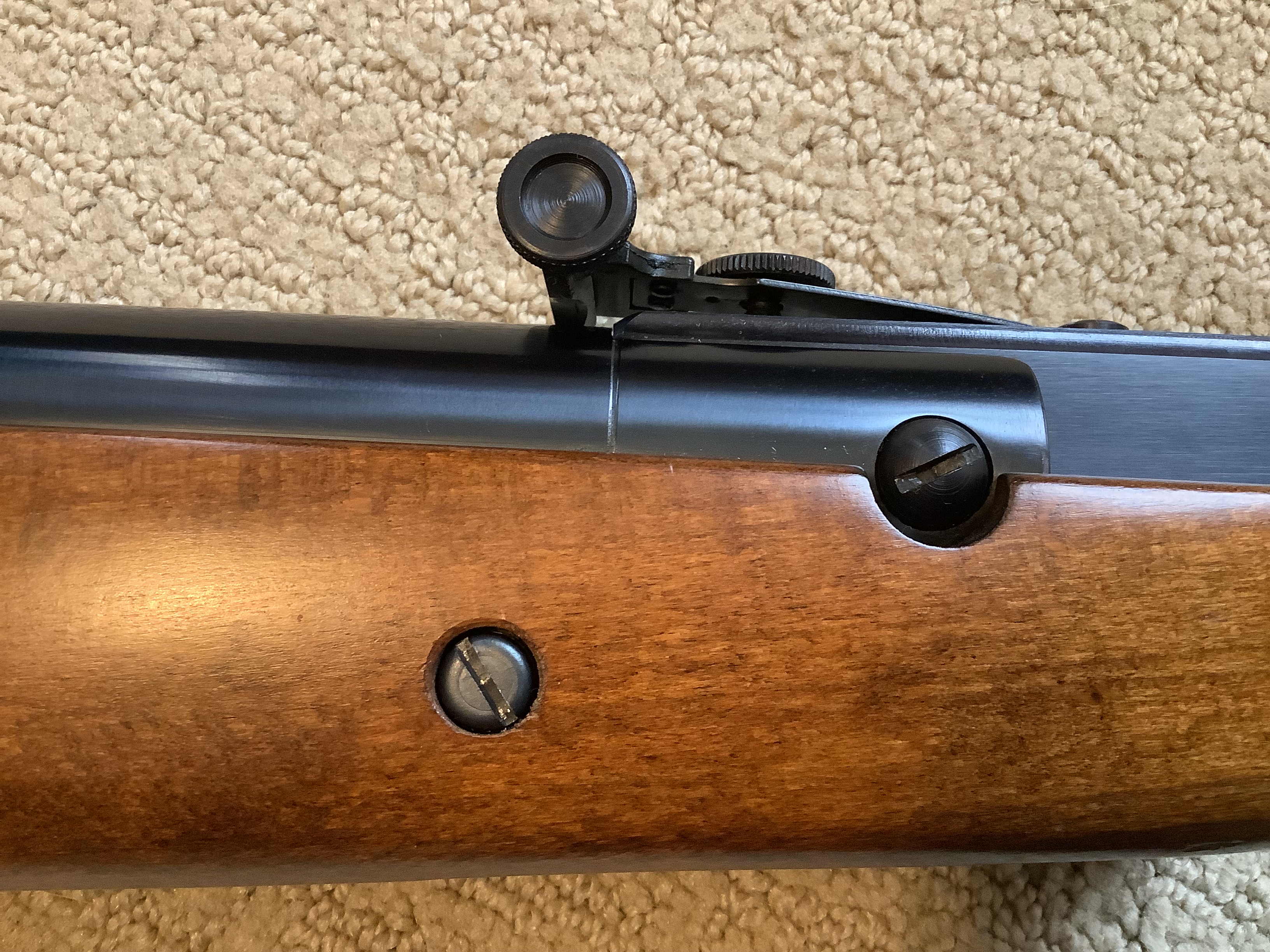

Very pretty gun. With the size of your R1 collection perhaps you could answer a question. I see that my carbine has a chamfered front compression tube cap seam rather than the usual attempt at hiding the seam. I have seen San Rafael without the chamfered seam so I know it’s not an early thing. Which R1s had the chamfered seam?
