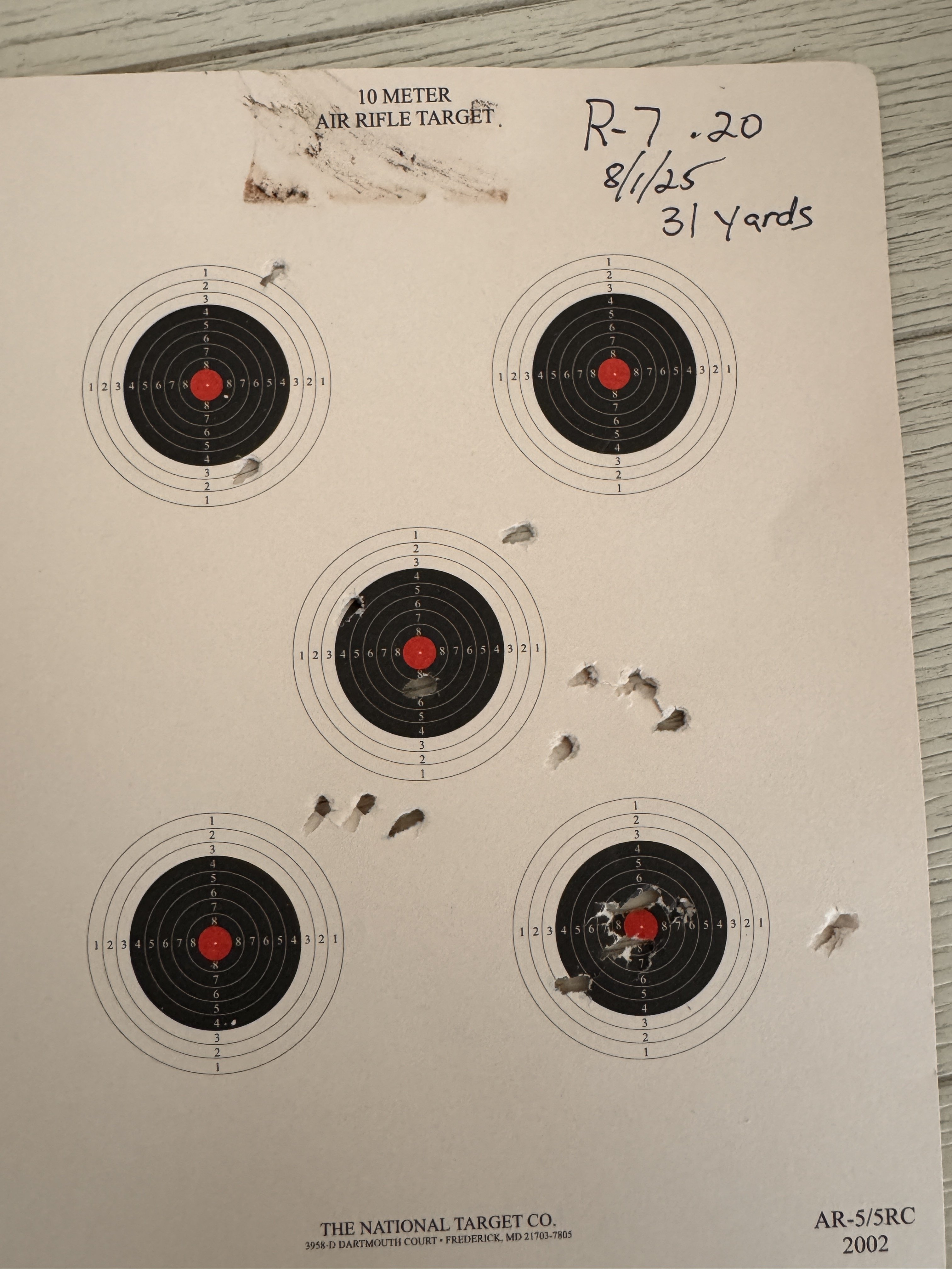

Beeman Beeman R-7 .20 cal rebuild….. results….?
Dieseling , I don’t believe so. I have heard a dieseling gun before . I put a tin or 2 of pellets through it since the rebuild about 2 years ago. I moved and everything was a mess for awhile.
I’ve been working on some other Airguns recently. So I took it out of the case and shot this video. It’s only 2 shots but it’s close to what I had recorded back then. I have no knowledge of the r-9 I don’t have one …yet…lol
but I do believe it’s basically the same gun with the exception of the screw in block. I can tell you that the tube on my r-10 was like a mirror finish inside. It was manufactured in 1987. I’m the original owner. I did polish everything inside and used limited moly and Tom’s red goo on the spring sparingly. The other guns I have worked on so far have a cross check in the tubes like a cylinder block in an engine. Does that matter ..who now’s. These things are finicky for sure. I remember back in the day guys were getting over 900 fps from 124’s ….as for the chronograph… I couldn’t say. In not an engineer . I only shot through it and record the numbers.
it shore isn’t helping my r-7 at the moment…

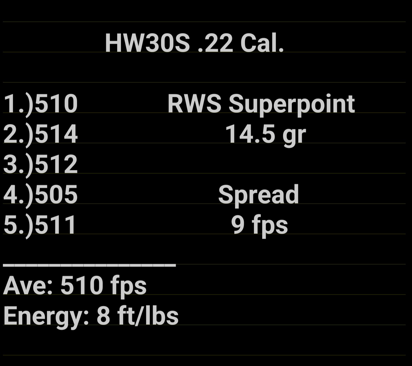

I bought my .22 HW30 used. The numbers that I'm getting are very impressive compared to the ones that I'm seeing here. I haven't opened it up yet, but I plan to because it's a buzzer. It's an incredibly smooth and accurate rifle. Now I'm curious. 7 - 8 ft/lbs should be about right for a power tune. My PG4 fitted .177 is getting 9.5 ft/lbs
9.5 fpe for a 177 Hw30 is exceptional. You're getting 8.3 out of a 22 hw30. Which is about normal. I've tuned a few and the 22s are hit or miss with barrel efficiency. A good one will do 9 fpe. You're a bright man so I'm sure you know that larger bores tend to be more efficient than smaller bores on piston guns. The problem with 22 Hw30s is the larger bore exhausts the relatively small swept volume too quickly for that potential efficiency to be useful. Combine that with Weihrauch's propensity for sloppy 22 barrels and you get what you got. It will pick up some power with a PG4 kit and VAC seal but it's unlikely it'll make as much power as your 177. I hope you prove me wrong. They're great guns and nobody loves them more then me. I've tuned several of them in 177, 20 and 22. All of mine are 177 for a reason.

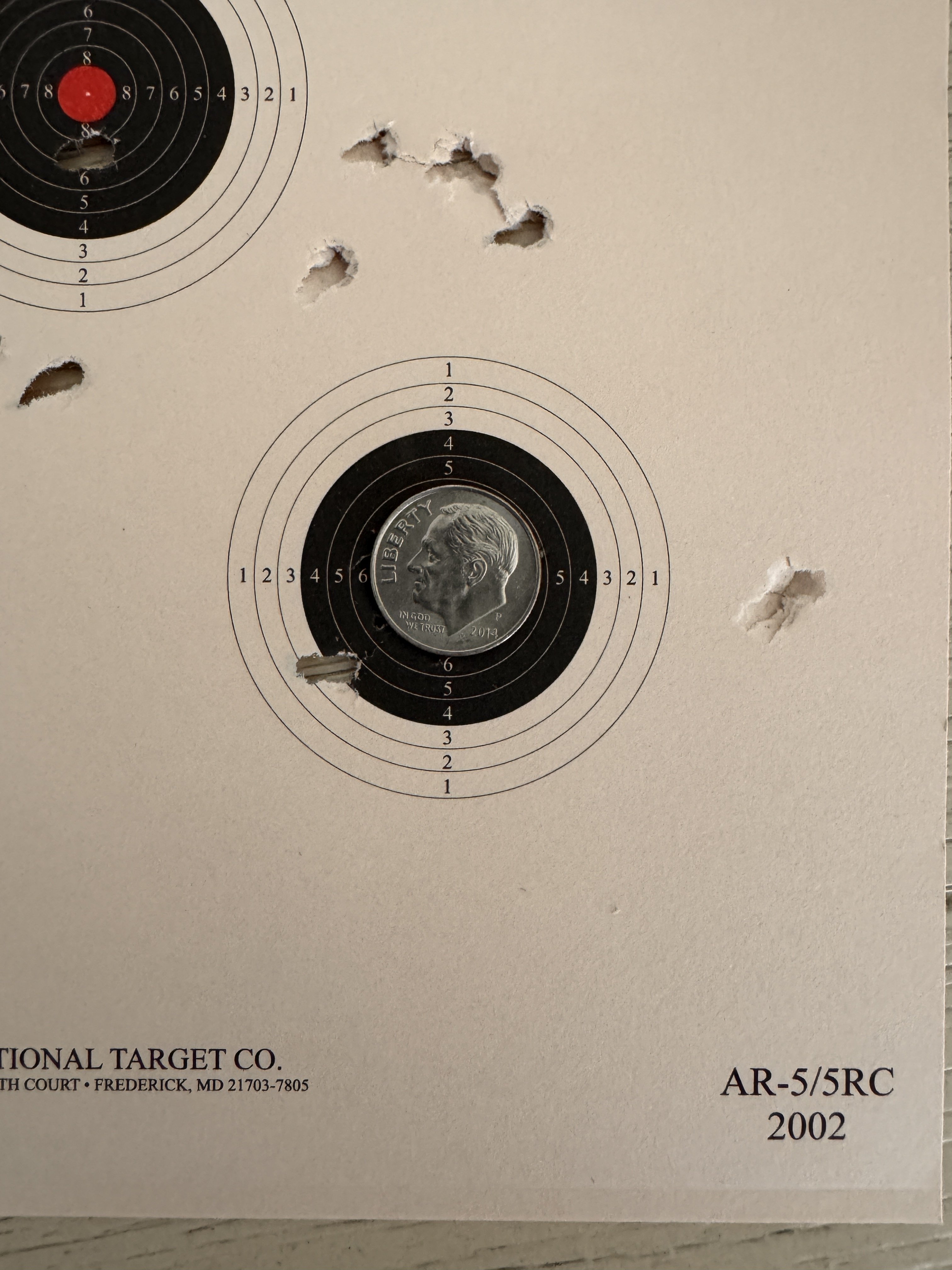

Did you happen to catch my most recent video featuring the HW30 in .22 cal. If not, check it out. The 25 yard, 5 shot group it produced is pretty impressive. Especially, when you consider who was behind the trigger...

That's great. BTW When i say Weihrauch 22 barrel efficiency is hit and miss. I wasn't talking about accuracy I was talking about power output. They can vary more in power output than 20 or 177. Probably because the same percentage of machining tolerance on a bigger bore makes for bigger changes in efficiency. This is only a guess on my part.

Perhaps, but there are .22 bores that will produce match grade accuracy. I've heard many complaints about Weihrauch .22 barrels. However, in my personal experience, I own at least 9 HW rifles in .22 and they're all up to 1/2" spinners at 50 yards. That includes the 2 little 30s. albeit, it requires a ridiculously big elevation adjustment and a little holdover to boot. I don't profess to have a clue as to why my mileage is different.
