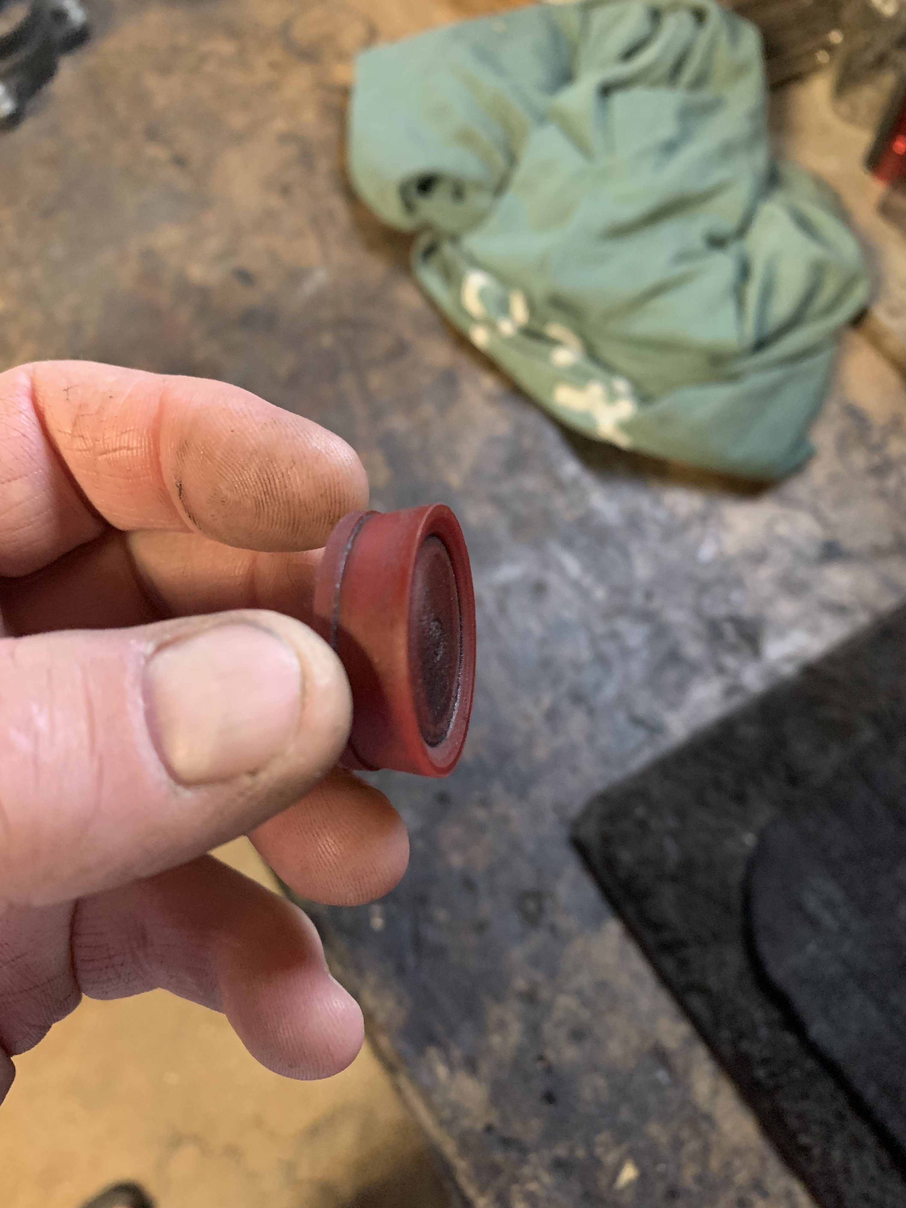

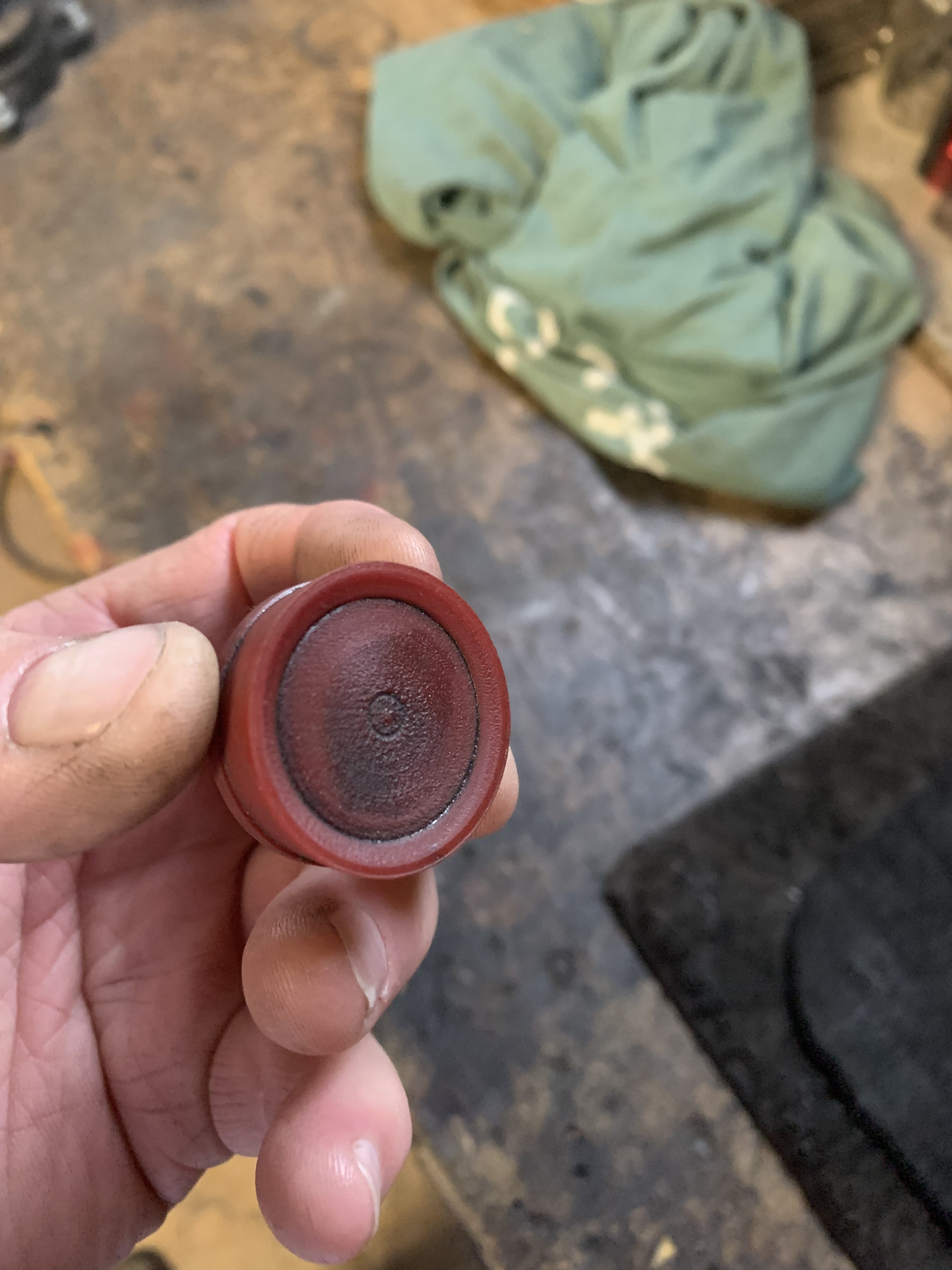

Nope it’s a los of tiny volume.. albeit tiny it’s not the loss issue. it’s the seal sizing. They are designed to fit snugger and burn in. It’s a manufacture % game as every tube is different and if thats Built in leeway. That and they have no sharp edges to grab threads and holes for The average Joe installer. The more powerful guns like R1/ R9 that have the spring power to heat them , compression size them in. Smaller guns won’t generate the needed heat and friction to size down. Macarri just plain out builds what he wants and tells you strait out. YOU NEED TO SIZE THEM. (Which I have no issue with)
I make 90% of my seals for my big power guns and all 27 mm Tommy /Longbow guns.
I can not take any credit as it’s a direct copy of the Venom power pulse seal. They are a different breed for the leading edge is sharp and the way it fits is much different. when done right they act More like a O ring with out the O ring shot cycle.
The VAC SEAL MAY LOOK ALIKE ,BUT IT SEALS MUCH DIFFERENTLY..
Air is pushed against the lip and the micro gap forces the seal to expand. (it’s why after break in some Vac seals will not test positive for psi at the port yet shoot fantastic as they need constant psi to open.
At the end of the stroke you get a pulse blast from the gap.
Power pulse Venom seals were sharp to the end and sealed with a snug er fit that had a 1 mm contact point ,( you can see the smoother area in the pics on the edge) they build immediate psi at moving. (Just like a O ring ) , the angle onnthe cup is steeper and its a tad deeper for a bigger pulse. (Yes I’ve tested them deeper and it’s a down hill loss). View attachment 582509FView attachment 582508View attachment 582510
They are no longer made as ,well there is no more Venom/V-Mach. So I make my own , then again I make my own guns too.
Looks like a ArH seal . 🤔

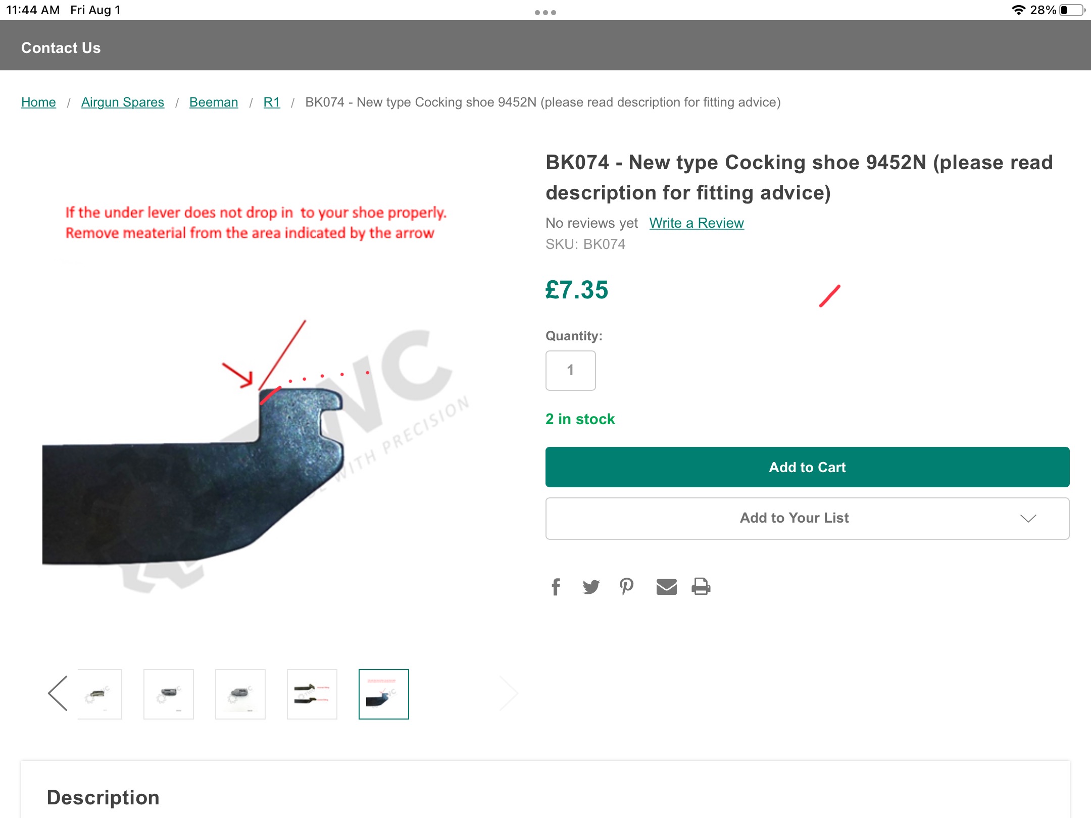

I have the new pg-4 kit and the new cocking shoe for the R 1 ( mandatory to use the new style cocking shoe with the vortek kits) it will be interesting to see the difference in velocity’s .
i have a baseline from the R1 but it was never opened up in 43 years. The gun was totally neglected
Is it the New .905 27 coil one or the .860 spring. Use a new Vac seal. They are sized well for R1 and will shoot in fast.
Make sure to lightly ease the bottom outside rails of the shoe before install, a tiny file works to micro flatten them
ALSO YOU WILL PROBABLY NEED TO RELIEVE A TINE BIT OF MATERIAL ON THE REAR OF THE COCKING HOOK TO ALOW THE NEW SHOE TO INSTALL AND ROTATE DURING COCKING.
take just enough so the shoe lays flat and come on and off ..YOU WILL NEED A SMALL BELT SANDER OR 1 inch grinding wheel
