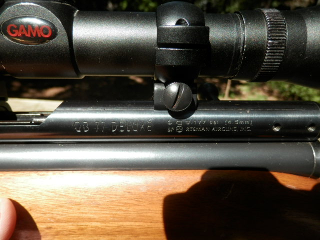

Here's a pic of the markings on the QB-77.
