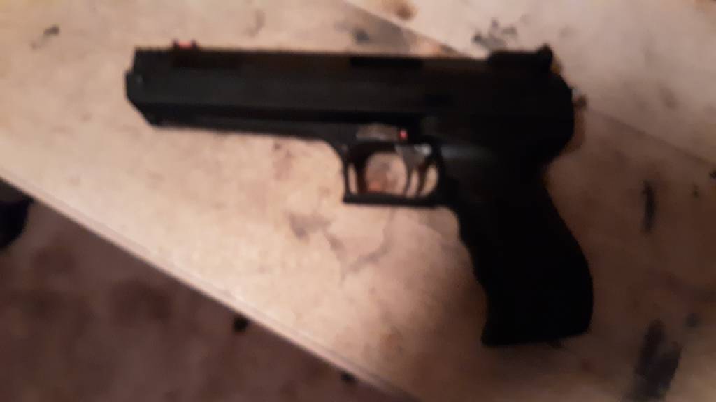

I bought 2 for my grand boys and 1 for myself. The boys guns shot well from the box with no sight adjustments. I waited ,and later I spent some "time" with my new toy.
I slugged the barrel and found the bore to be .174.
The breech was rough , barrel smooth and crown end had a bur. ( just what one might expect )
I polished the breech, the leade and the crown.
Chrony....at 5'....H&N Baracuda FT....head .1735....9.57 gr.....410 fps....3.5 fpe
The pellet was a good fit.

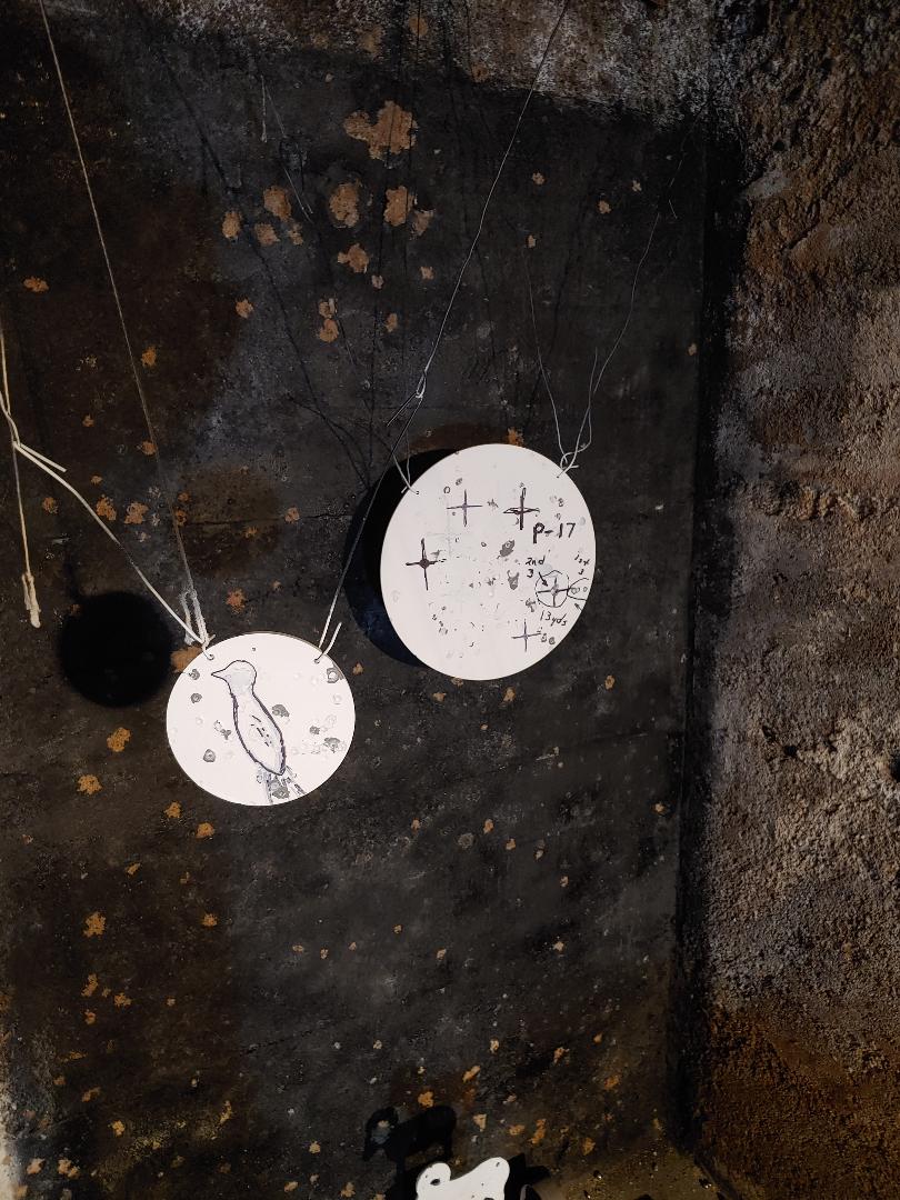

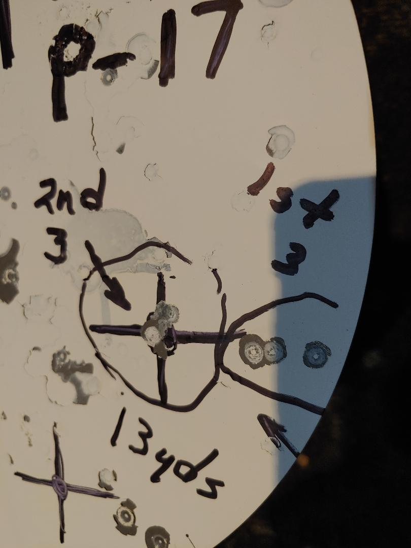

I have a range in my basement. There is a 10" x 3/16" A36 steel gong at 13 yards. I put a 3/8" black mark on the lower right.
Shot 3 times , outside right, a string.
Made adjustment to sight and shot 3 more times.
I like the trigger.
