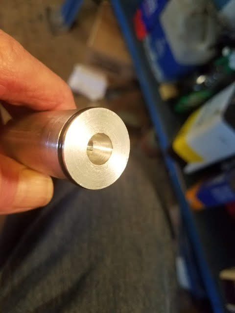

Some guys remove the front pin on the piston rod & pull the piston. Once out you can use a 3/8 drill bit (or dremel) to make a shallow divit on the piston face. This will lower the compression a little & make it easier for you to cock without affecting accuracy. (Do a Google search) In a couple of years, you can remove the piston & fill in the divot with J. B. Weld. Now your back to where you started.

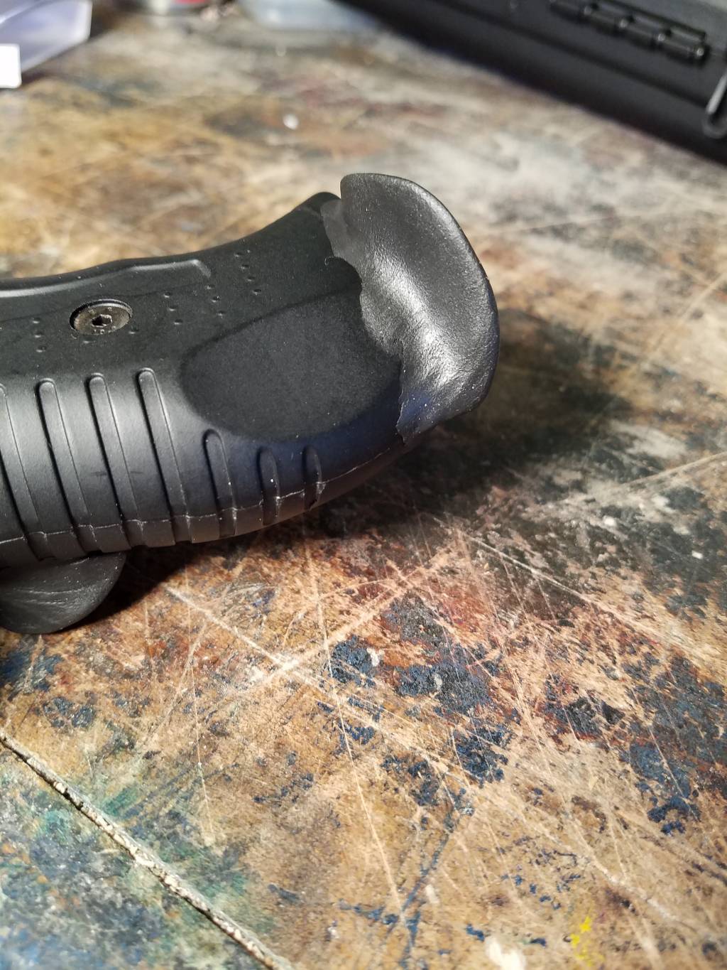

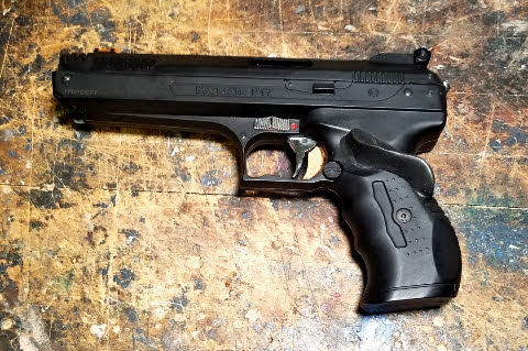

I bored the inside of the piston on mine. Also cleaned up where the o-ring meets the barrel, made a cork trigger stop, and modified the grips with moldable glue.

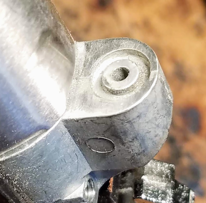

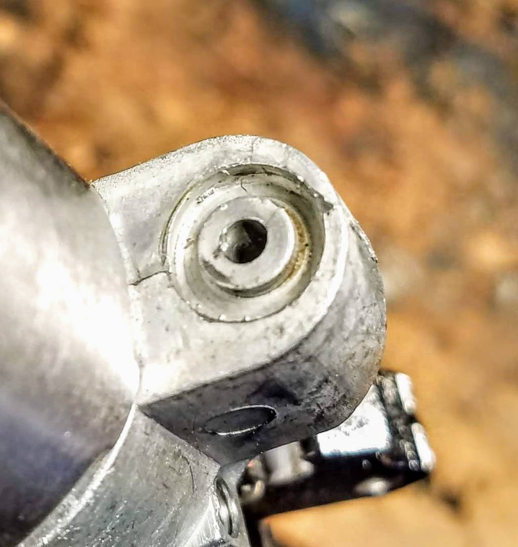

Turned the cylinder 180 deg which place the inlet air hole up so its easy to squirt a few drops of silicon oil.
Easy to cock, and no air leaks at the breech.
Before
After
w
D-cuttler
Great post with pics. Any information on modifications can be useful to someone. We all have different goals at different stages in our shooting experience. It's not always about the most power. Thanks for demonstrating with pics the modification I was trying to describe.
