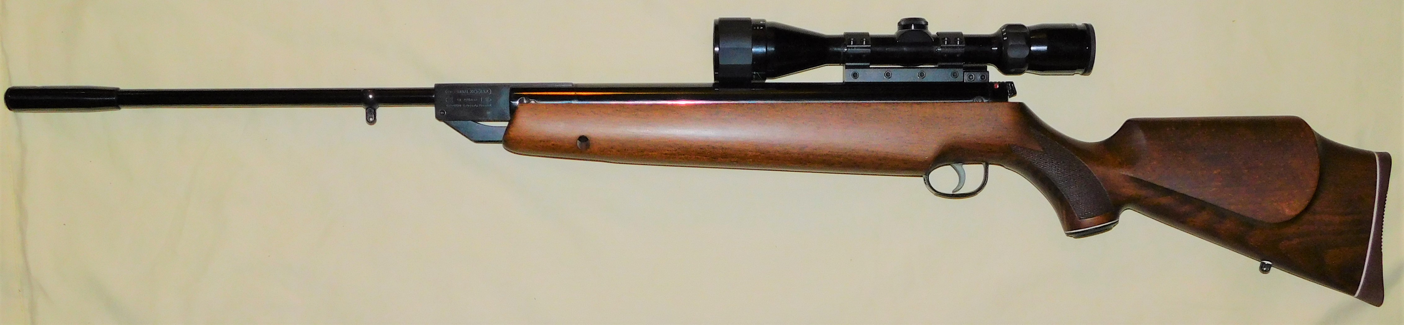

I have both the Spring and Gas Ram versions of the .25 Kodiak. To answer your original question, it is a Webley product made for Beeman. Different stock with Kodiak being Beech and Patriots Walnut. Spring version is a beast at 30 ftlbs. Put a hole in one of my pellet traps. The Gas Ram version is a little less powerful but has a completely different firing action. Makes it a little more accurate.

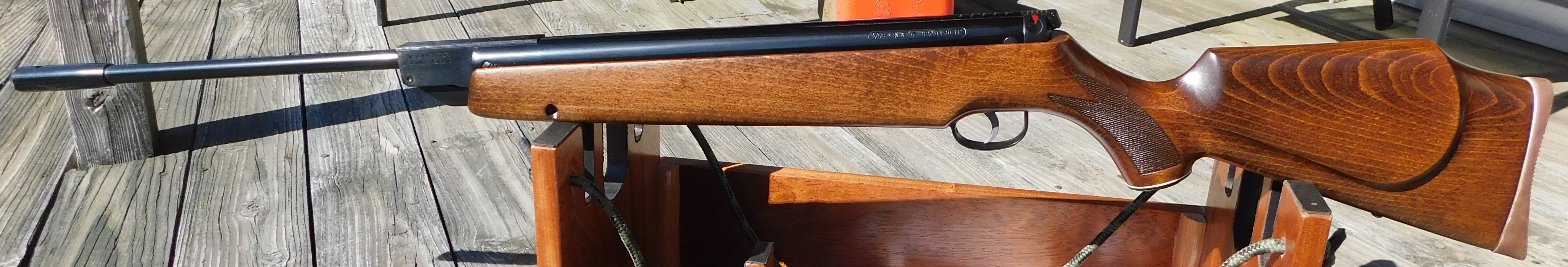

This is a big rifle. Certainly if you have buddies that rib you because you are an adult and still play with “BB” guns, hand them this. I know it works because I did it. Cocking the Kodiak takes a sharp smack to the barrel just to break it open, not knowing this they will look like 9 year old girls trying to open a pickle jar. At that point, you can advise them to stick with their firearms.
Beeman \ Williams sight added
At least until they are man enough.
Holding the Patriot it becomes clear where the power comes from. While not as heavy as even the stubby HW97K, it is a big rifle. The receiver tube is huge; it feels like it is built to a 125 % scale.
It likes a middle weight pellet in .25 caliber for producing the best sustainable energy, which is not uncommon in most springers. It is also not accurate with the perfect rounds; I even try making it a shotgun loading 2 and 3 of them at a time. Interestingly the total energy remains about the same, which is lower than pellets at just over 24 ft lbs. It comes close with some pellets, but falls shy of the magical 30 ft lb number. I mark the best, as you can see from my notes on the pellet tins. (The 26.4 gr averaged about 702 fps)
Scoping the rifle proves short lived, as it sends the 18x Bushy to an early grave in no time. Rather than challenge it with another scope to devourer, I put a Beeman aperture sight on it. This makes for a much better match in my mind, also keeping a scope out of the way when muscling the 50 + lb cocking effort and reducing the bigness feel. I believe Tom Gaylord said it best when he one time likened holding the Patriot to feeling like a kid shooting his father’s gun.
