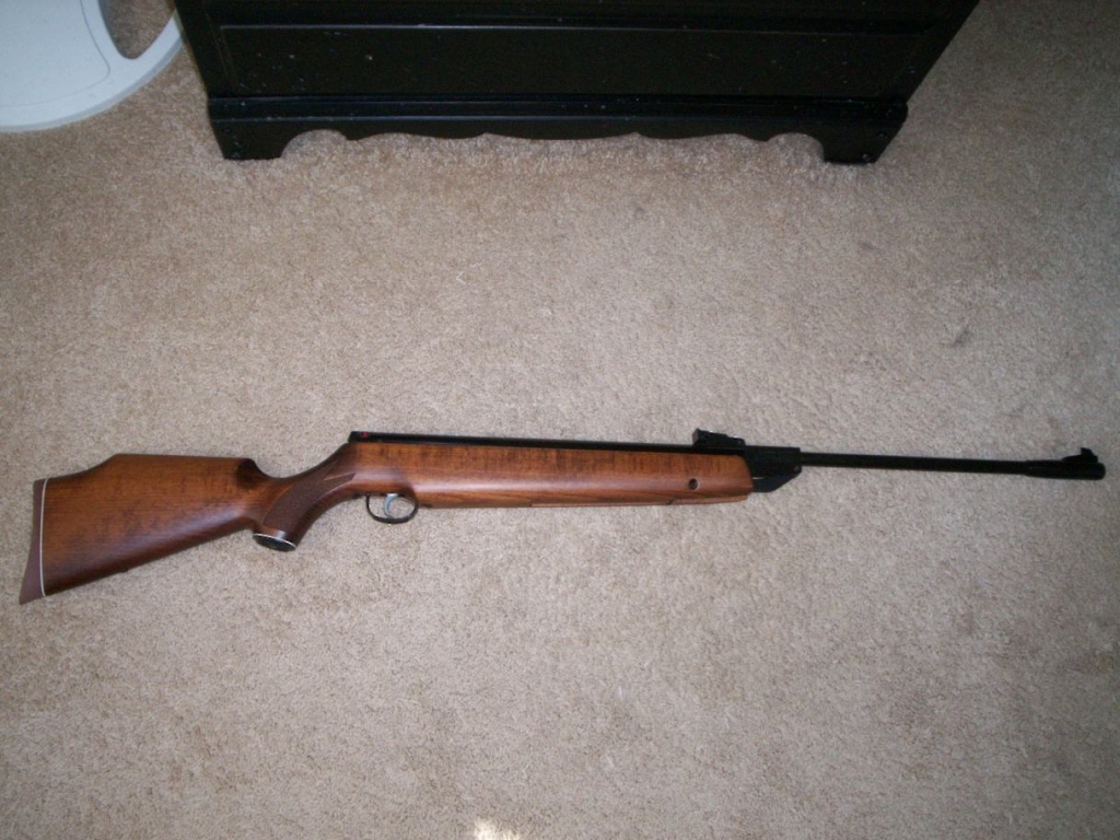

Beeman Kodiak .25 arrived
Never been shot,still has factory grease on it.Waiting on pellet's.

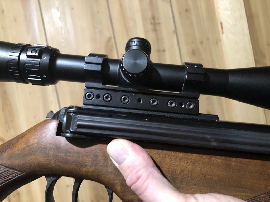

I just mounted a scope on mine yesterday. Looks like it has some serious barrel droop. I think I bottomed out the vertical adjust.
I'm pretty sure I'll have to shim this mount since there isn't likely to be any mounts with built in droop compensation for these rifles.
However, if anyone wants to prove me wrong by pointing out such a mount, please feel free.

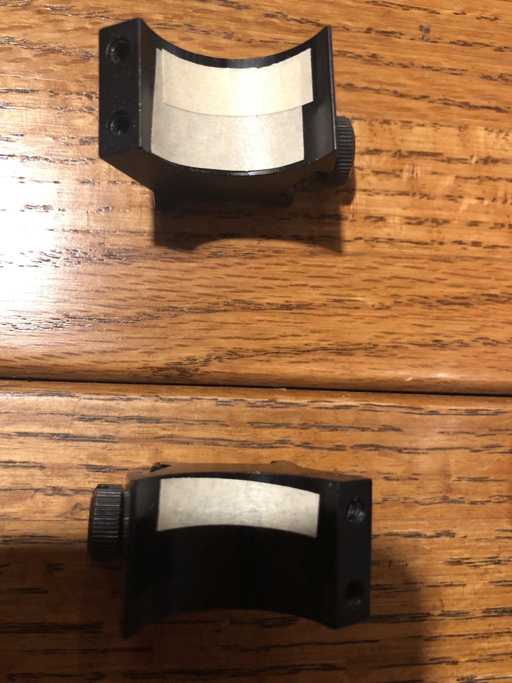

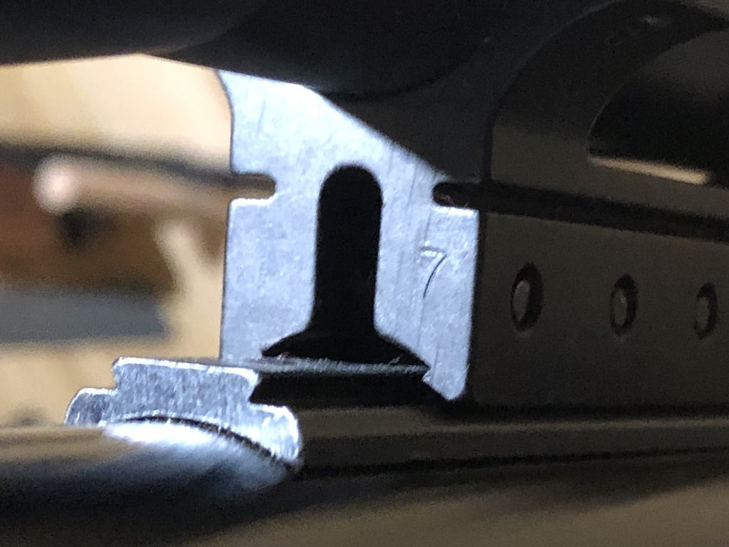

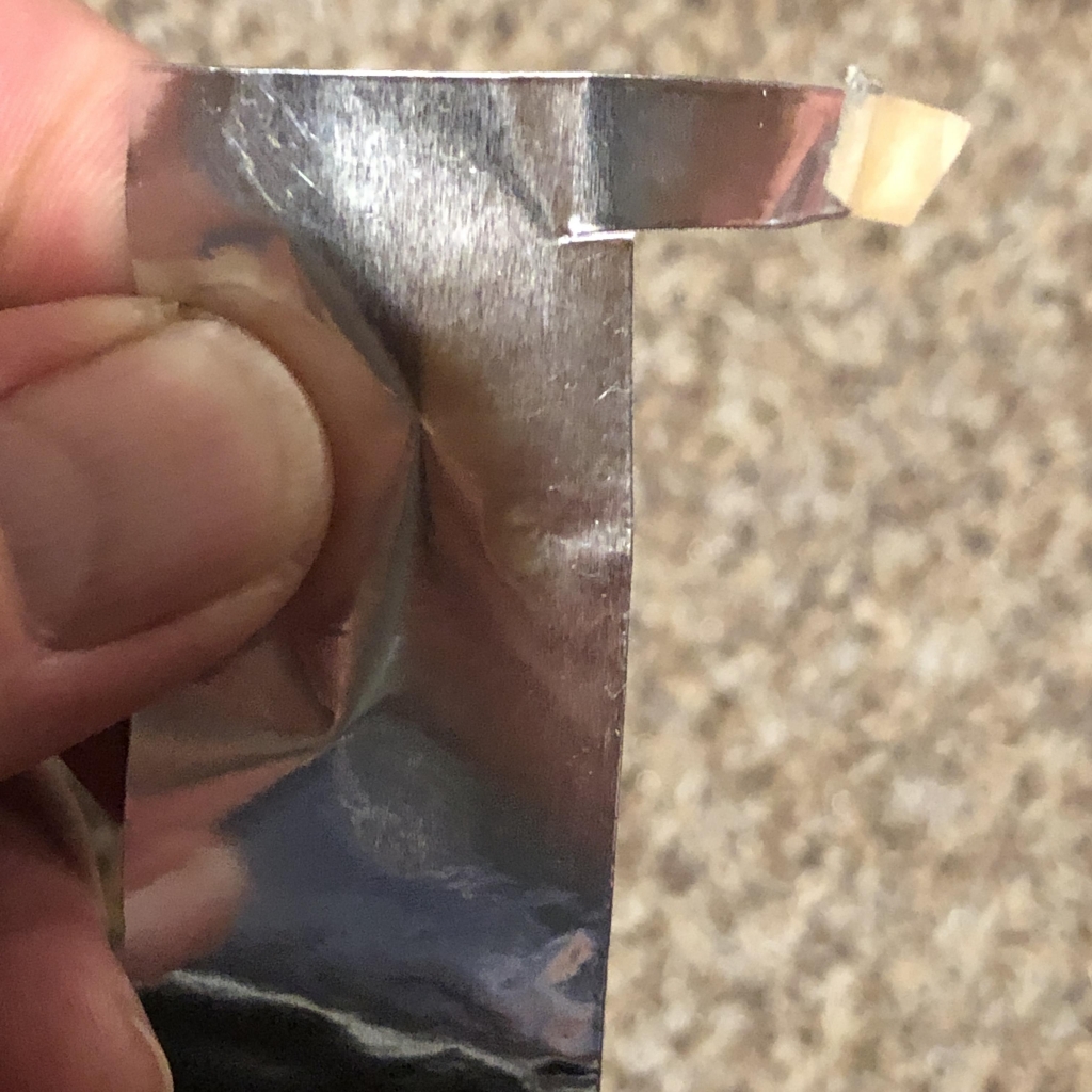

 Depending on the amount of droop, you will probably still need to shim since it’s not compensated on the mount. I’m not sure that I’ve ever shimed with that powerful of a springer. I would use what I call aluminum tape. Looks like this, has a peel off backing.
1567650566_13011878655d7073061999a6.66922992_FC6F5C80-9A7C-40A0-AA88-E4B190006D28.jpeg
Build it up carefully. So the tube isn’t bent. It gives a bit when you crank down the screws
I demonstrated with masking tape, easier to remove. I’m sure there are some engineers out there who have better methods.
You will likely have to remove all the screws from the mount, put them in the opposite side to open up the clamps to mount.
