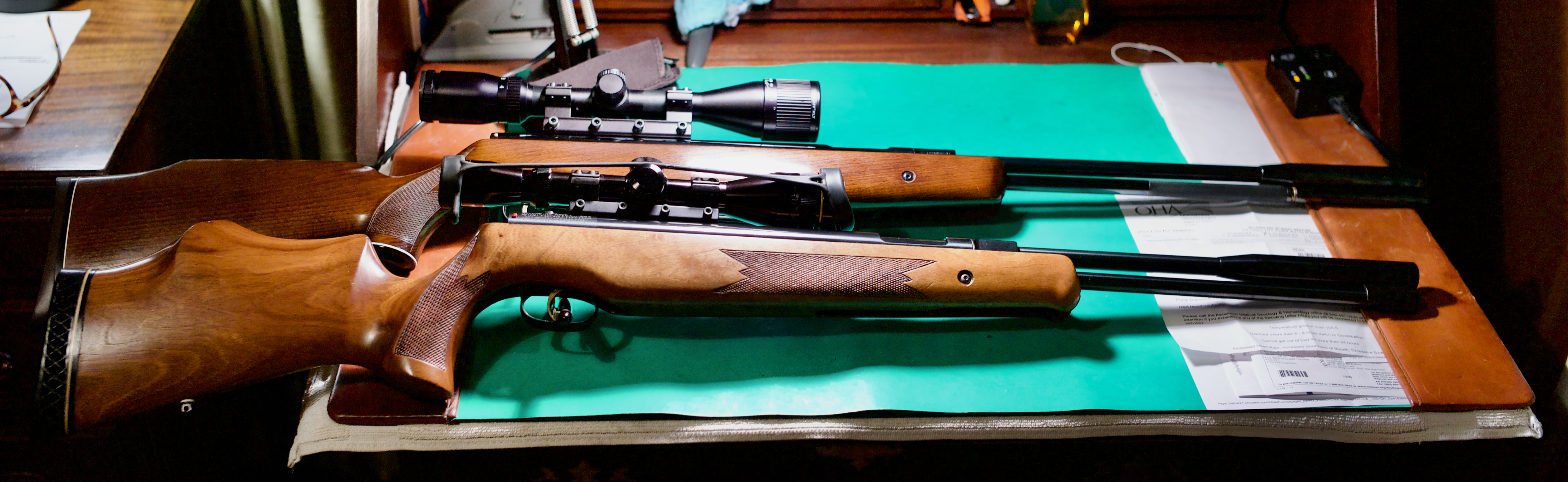

I've never seen a TX200, but everybody says it's a wonderful airgun. Here's two Brit tuned guns, an "Airmasters Mastersport"-HW77 and a Venom tuned HW97 with "Hunter" T stock, actually a CS stock made for the folks at Venom...crummy photo, sorry.
Yes that was my thought the 77 as prototypes for the TX200 Mk2 till Mk4.

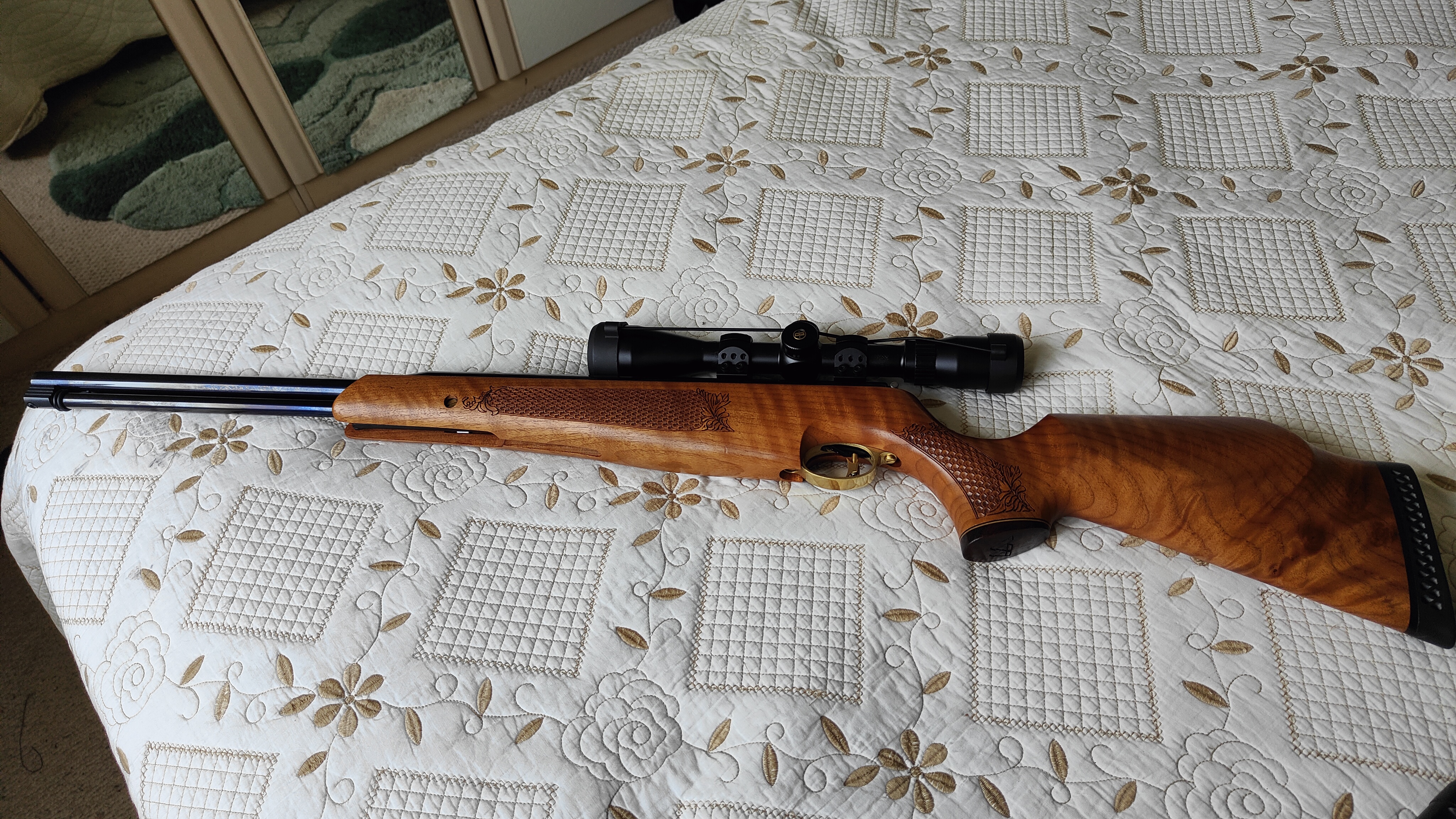

The tx 200 is an air arms gun not weihrauch. It is mark 1 2 3. This is my mark 3. Great guns better than the HW97 which it was compteting with. Without doubt the much better build. However with a bit of a fettle I still prefer the hw 77 and 97.
Incase anyone is interested in the Mk1 for the 25mm shot cycle. Any 26mm HW77 or 97 can be converted to 25mm by changing the piston, sliding compression tube and possibly the main spring to 25mm ones.
The main body is the same making the stocks interchangeable as well. A MK1 stock might require a little inletting for the bear trap.
So if you have or know someone with a rusted and beat up MK1 you can recycle the parts in stellar fashion. Obviously expect a reduction of power from the piston conversion.
This has been a public service announcement.

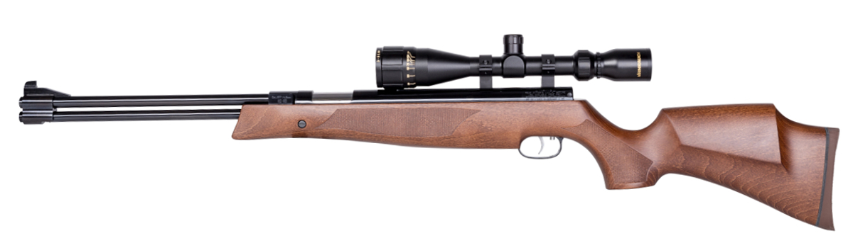

My only gripe with the new ambidextrous stocked versions is the near impossibility of using the iron sights with the higher stock comb.
Absolutely true. The 95 Luxus stocks suffers the same thing. Why put stocks that high on a gun with open sights. Might as well ditch the open sights. Might as well only market the 97 if the 77 open sights are now unusable.
It was a disappointment to not be able to use the 77 irons without facial reconstruction surgery.
Don't know about that. But strange so then for it meets the whishes of professional or addicted shooters for an elaborated stock design very much, doesn't it? And ambidextrous. This was the one I was about to purchase. And this is the only one I'd have short barreled.
By the way, what are the recent stroke lengths? is it still the 82 mm from the first versions? What does MK1 mean?

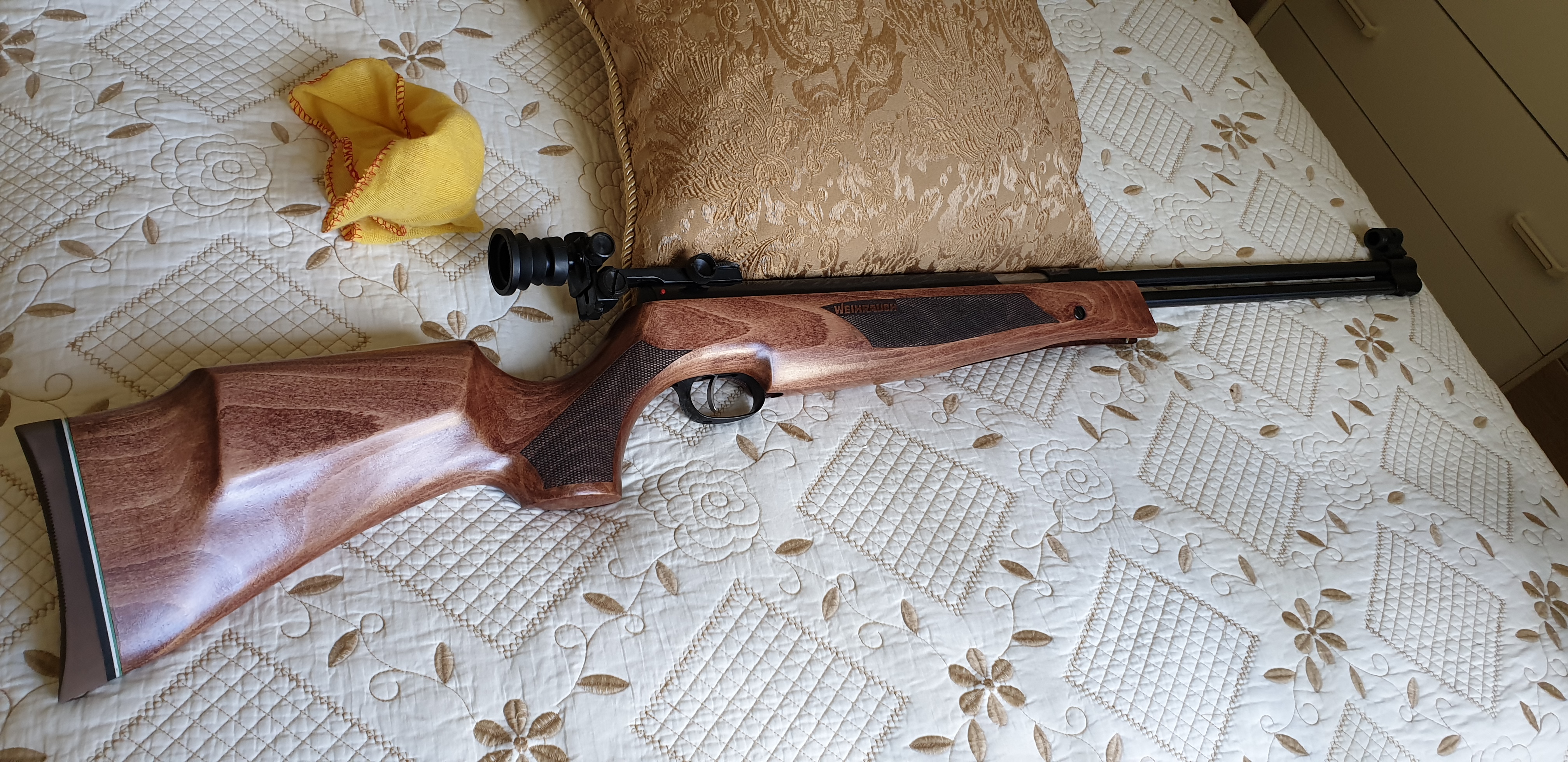

I bought this stock as it came with the gun which I wanted for open sights (diopter). I lowered the comb and I was able to get on the open sights easily. I did however eventually put an old open sights stock but the altered stock on this post was very good. see pic now a much lower comb.
If you are interested, here is the work around that I came up with for comfortable use of the iron sights.
