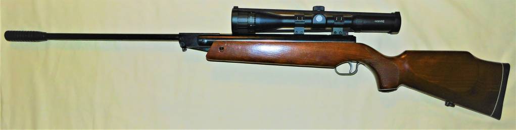

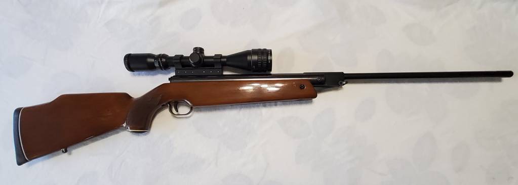

I paid $400 for mine. From the looks of yours based on photos you provided I'd say the rifle and scope would easily get $500. That if it's been tuned by someone who knew what they were doing.
Thanks Golden, when I first looked for the original seal I fully cocked the gun so I loaded it up and shot it just to relieve the spring pressure. It fired just fine so I shot it again. Function seemed fine. I am going to take it to the range today to see how it does with a half dozen rounds through it. The front action screws are slightly buggered up which makes me think someone replaced the seals already. I don’t have a spring compressor and don’t know anybody who does but if I can find one to purchase I would grab it. I do all my own gunsmithing already and wouldn’t be afraid of working on this beauty to tune it up if I had the proper guidance. Is there a particular post on this site you would recommend for tuning? Thanks again for your comments.
