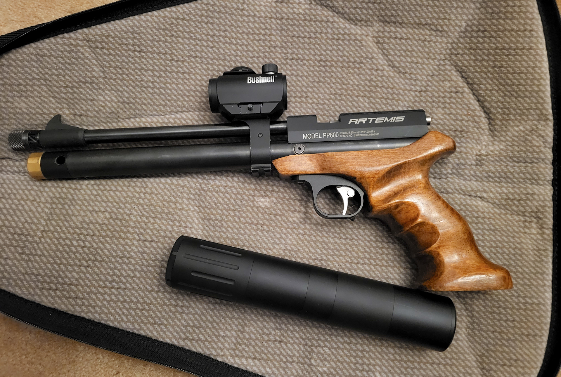

Gona go ahead and just recommend getting a pp700 instead. I have a bandit and pp800 (essentially the same gun). While the 700 does not take a magazine, essentially everything is better about it. The 800s are good, i think a lot come with regulators now. But they were originally designed to be unregulated. The air tube is very small on the 800 and the beeman. But with a regulator.... the air capacity shrinks significantly. Maybe that's not an issue if you dont need or want many shots per fill. The 700s were designed to be regulated, and have nearly double the air capacity. An un-regulated 800 has a very wild power band. Very high output, and pretty steep power drop off on either side of peak power. So velocity will be all over the place if you fire it from full down till the gauge hits the red section. Another thing to be noted about these pistols is I believe the beeman grip is undersized for most people. The bandit grip is vastly over-sized (see mine cut down below), and if you get a synthetic pp800 grip they are also a bit on the slim side, but manageable. Could probably get some type of rubber pistol over-grip wrap to make better. My hands are extremely average sized.
