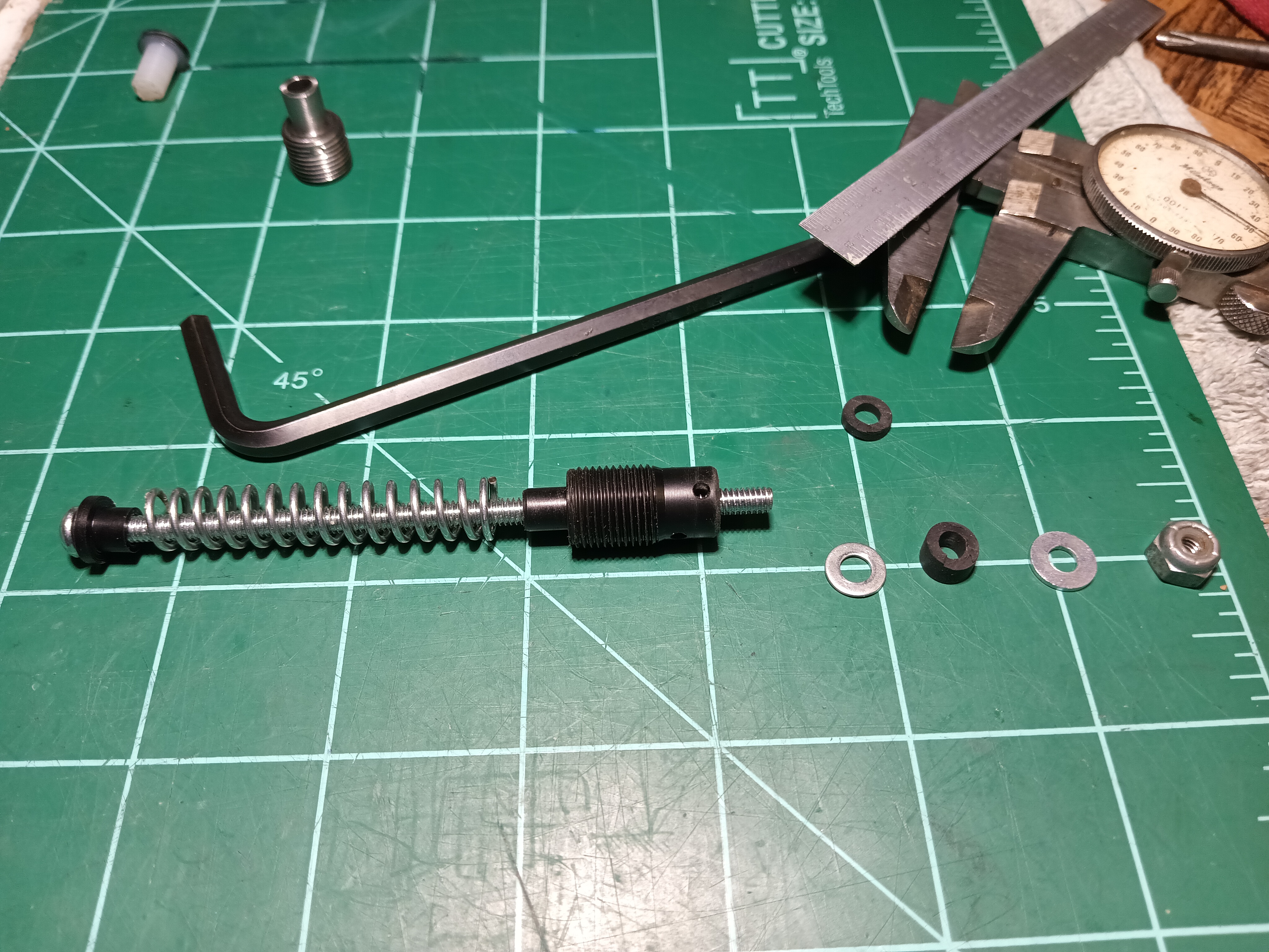

The reg seems to work well. 10.5's at a constant 840/850 over a large PSI range. Haven't looked to close where it fall off the reg. Made this up today. Have to get a different spring and trim the screw.
I can tell shot count is up just from playing around with it. Needs a little stiffer spring. You can see the stock adjuster in the background of the first pic.

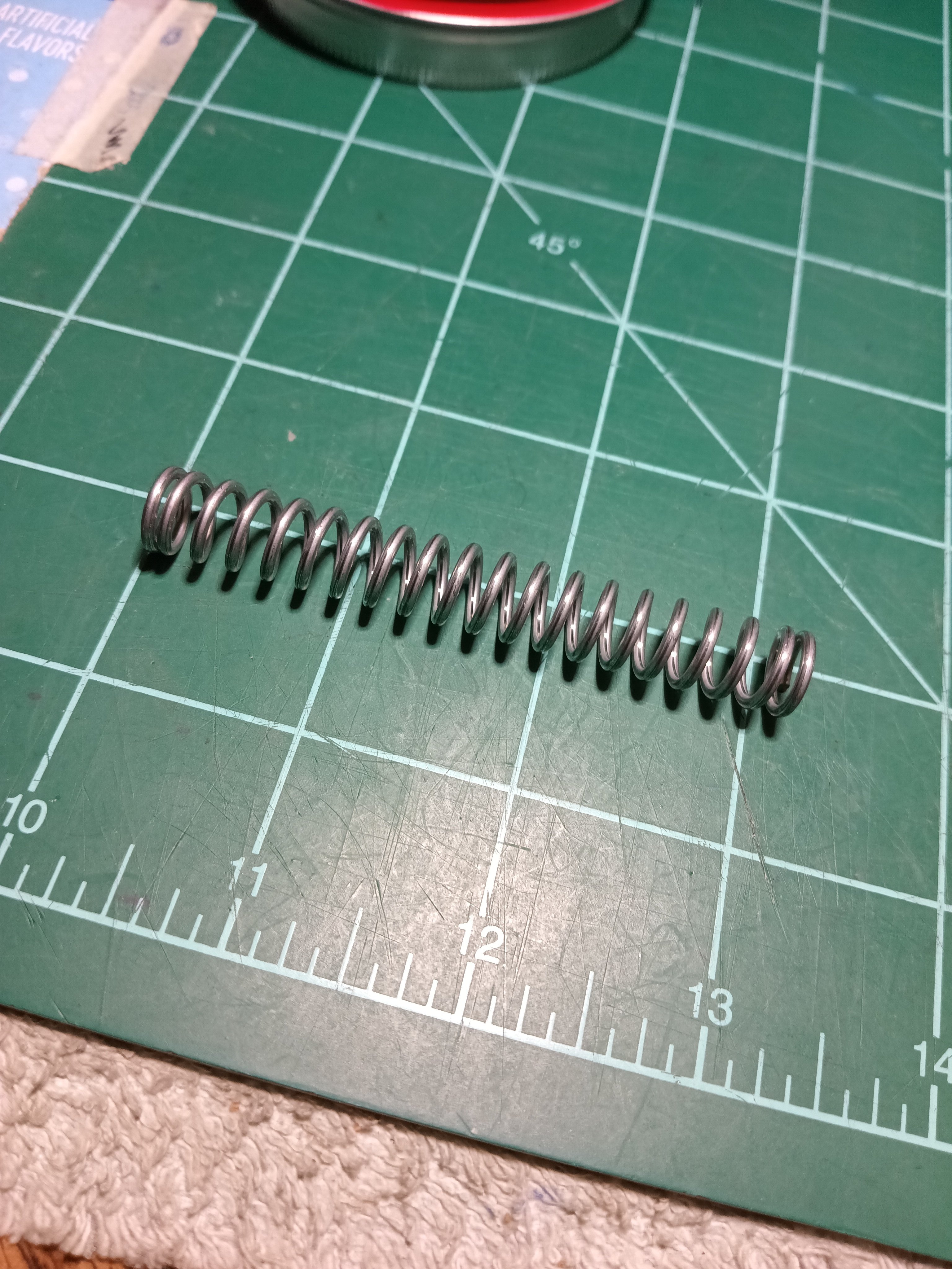

Stop at the hardware store on my way home from physical therapy. Picked up a new hammer spring to try out. Pulled my HDD out of the gun and replaced it with a hardware store spring. Worked out pretty good, especially for a dollar and 69 cents. Specs on the spring are OD .43 x wire thickness .056. OAL at 3 & 1/8
Don't hear any hammer bounce took four shots over the chronograph 888 to 896
Used the factory hammer spring adjuster with about 3/16 of an inch protruding from the action.

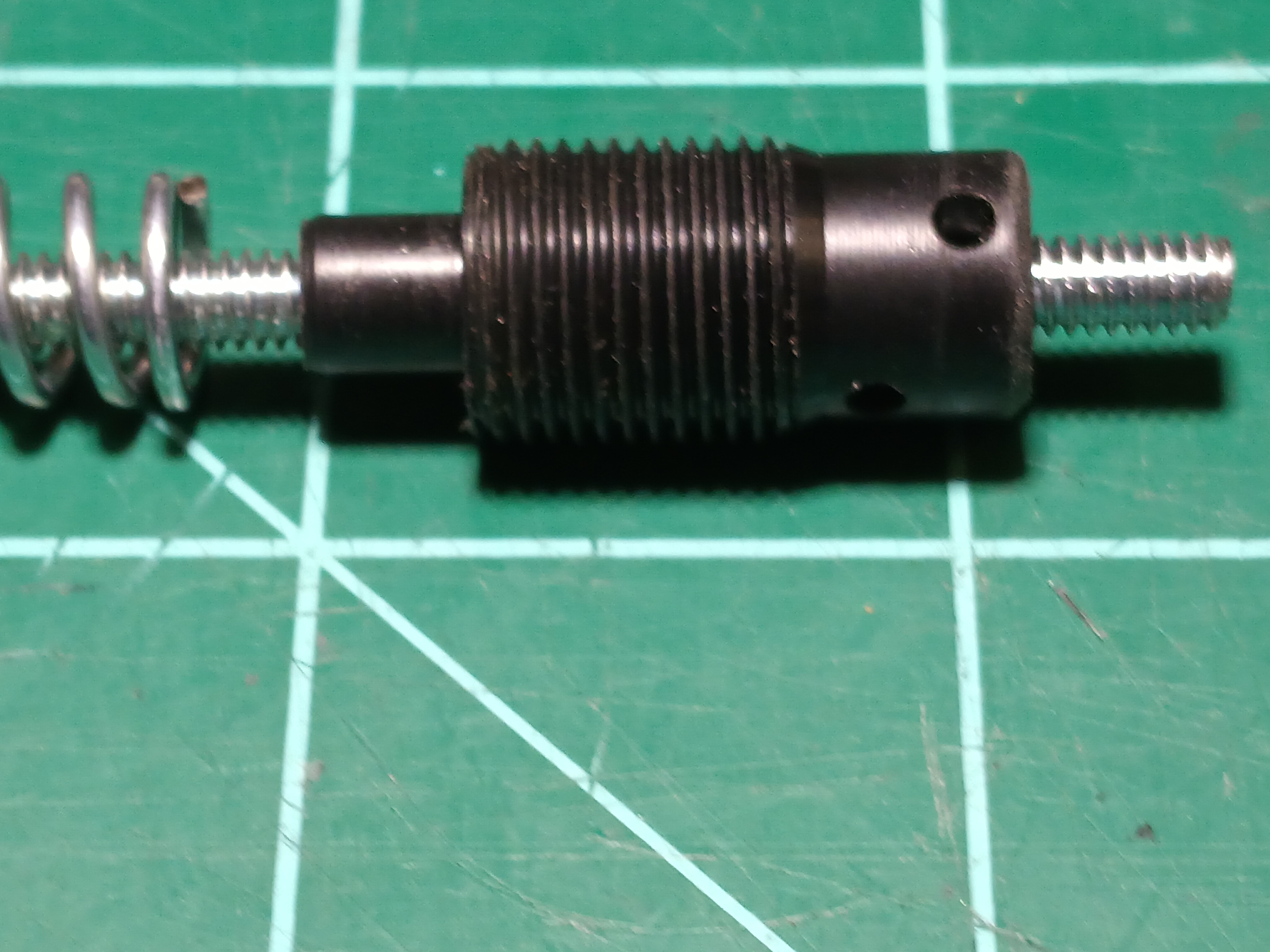

The HDD is real easy to make. Can be done with no modification to the gun itself. And it uses the stock hammer spring adjuster.

This is the HDD. 8 x 32 x 4" screw, 2 flat washers, a thick o-ring or piece of rubber tube, locknut and spring(s).
Assemble and preload the spring. Install and leave some slop where theq hammer slides back and forth about an eighth of an inch.
The screw will slide right through your original spring adjuster. No need to modify it. Mine got kind of chewed up somewhere along the way when they were putting this thing together so I made a new one.
