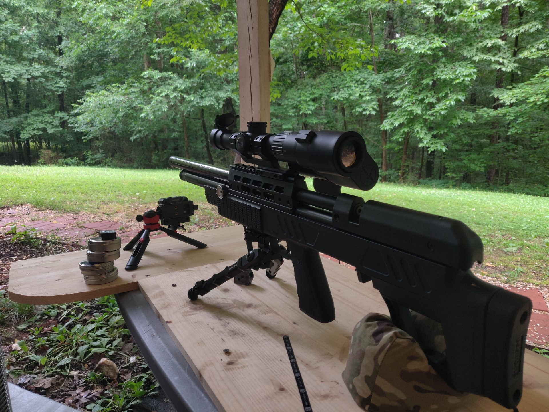

Beeman Beeman 13615 .177 Kinda Impressed
Got this little guy a few weeks ago and finally had the chance to miss with it. Out of the box nothing to write home about, trigger kinda sucks and it has horrible hammer bounce. Swapped out the trigger spring and polished some parts and the trigger breaks at about 1lb. Swapped out the hammer spring for a shorter dual spring combo that gives a free flight hammer and shot count went from about 30-35 to 65-70 per fill. the regulator was set at 160bar from factory, pulled that out and have it around 120bar now. oh did I mention its loud like really loud so I made a shroud for it and now its really quiet. long story short for $175 and some tinkering you can have a pretty damn descent heavy ass bullpup. video below is me just goofing around with it. FYI the targets are @45, 50, 55, 60ish yards
