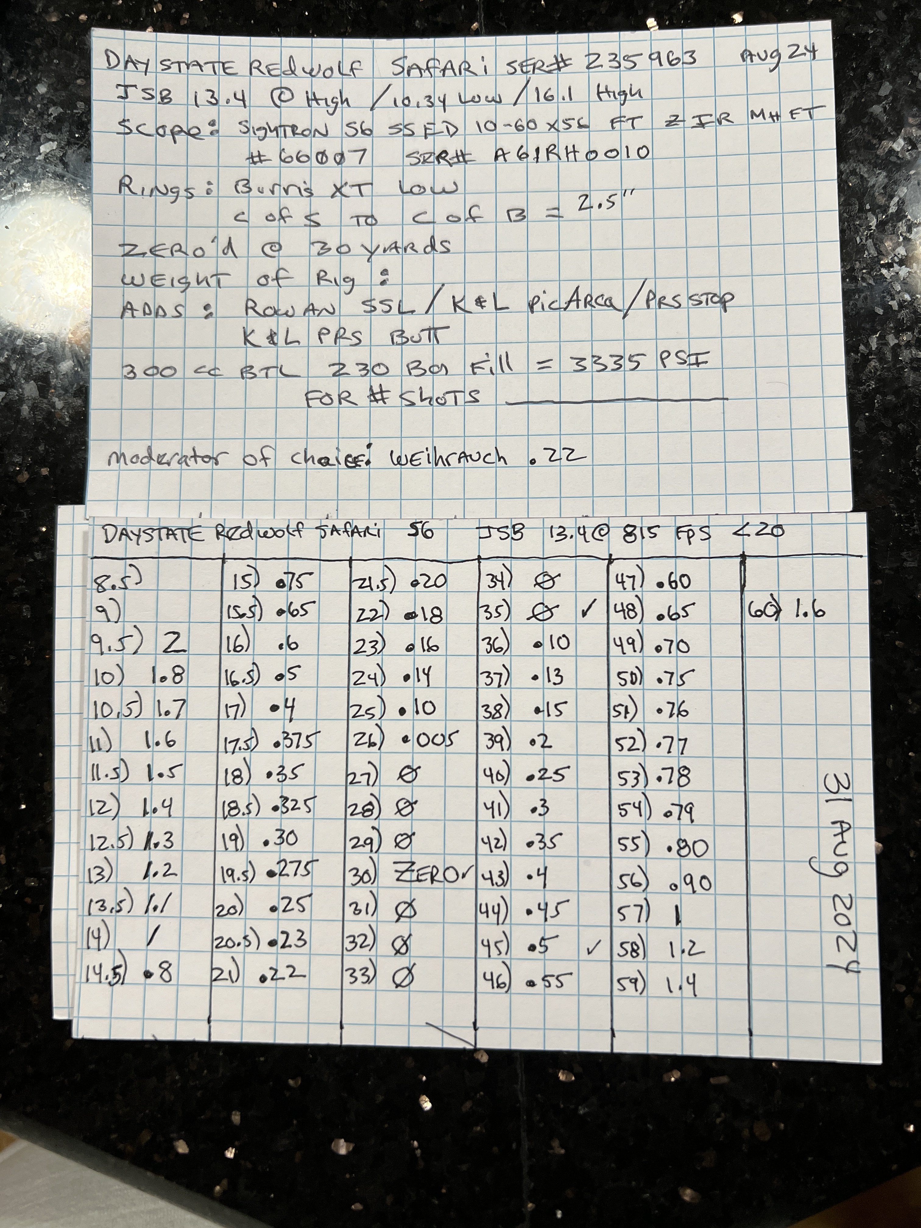

Zero for HFT should pretty much be at the height of your apex / pellet trajectory. This is a function of pellet weight and speed and ballistic stability (BC).
To determine your pellets flight apex, you shoot from a stable bench on no wind days at distances from 10 yards to 55 yards (9-60 for me).
You study your point of impact through your scope to determine the rise or fall for holdovers while trying to avoid hold unders.
BUT - if you’re able to use the elevation knob in your class like wftf or open you can ascertain your clicks at a given distance to remain at zero with the reticle.

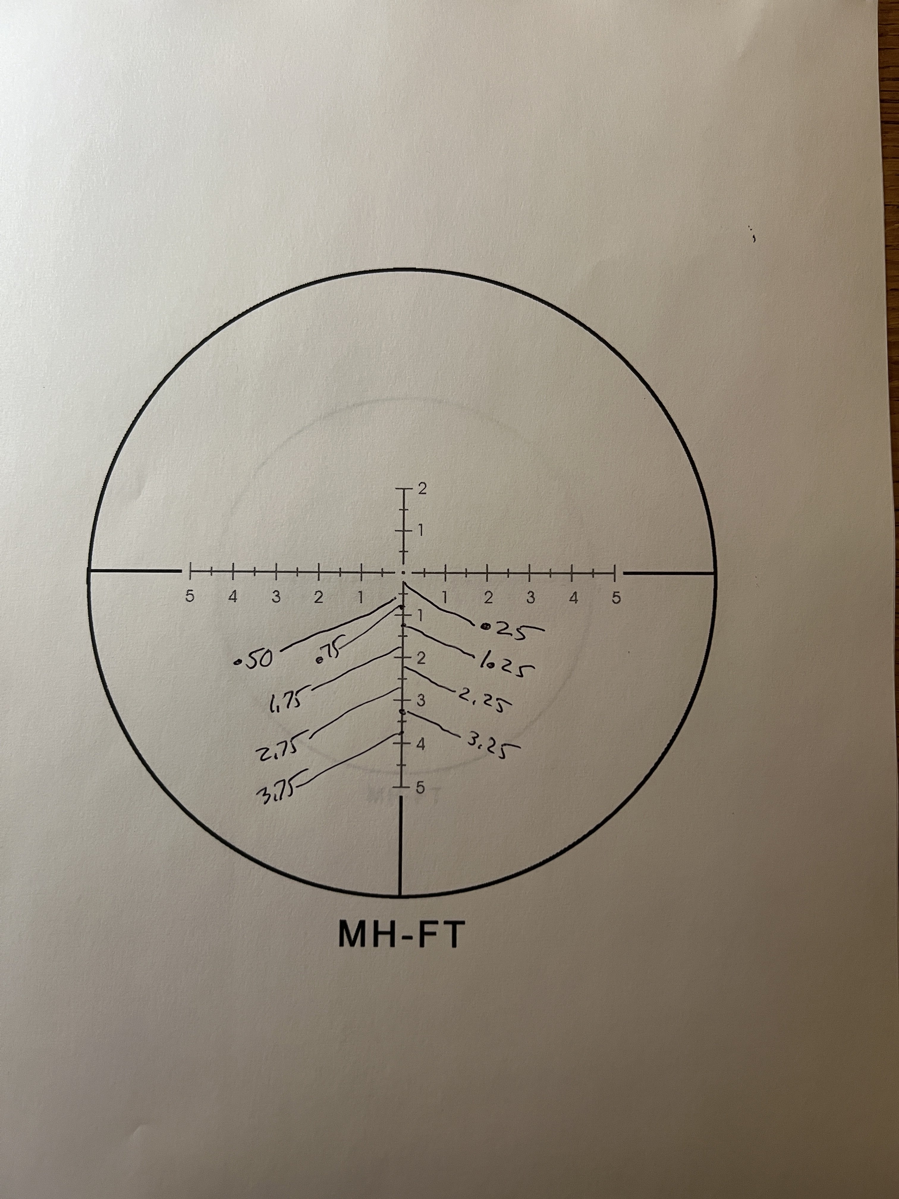

You then create dope to be quick and accurate in competition - too much to remember. Pictures below are my dope for a Sightron S6.
