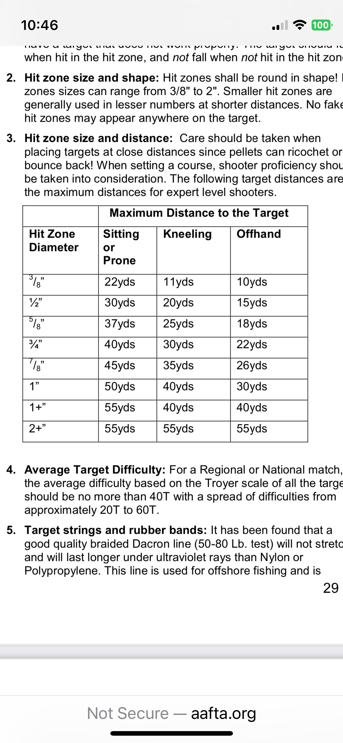

Though this is off topic, it’s related to what you said there. Higher top scores might not all be the result of allowing 16x scopes. There are also now more standardized courses with lower difficulty for the hardest targets. And those are the targets that even top shooters would often miss.
You don’t see any 60T targets these days. And with a 1” at 50yds, if your ranging was off by 2yds, it was probably a miss. No matter how well you read the wind.
