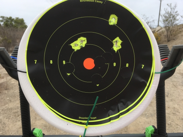

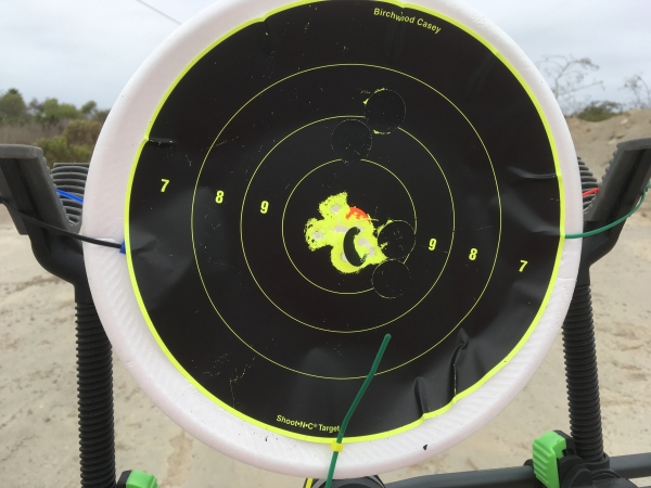

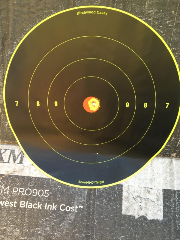

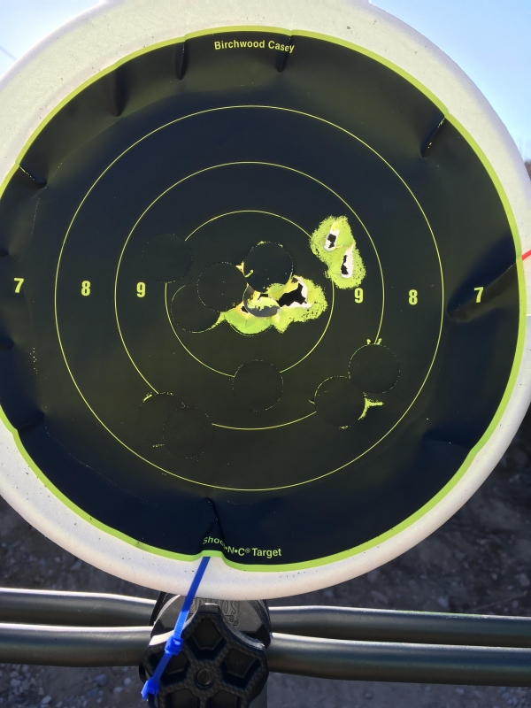

Here are my zero, 50 yd & 100 yd groups with my Pulsar for the H&N Baracuda Hunter Extreme 28.24 gr (DeadShot). Keep in mind that I used my Chairgun holdovers for these groups.to also test for accuracy (bull's eye) as well as precision (grouping). When I group today, I will use no-holdoffs for the groups so that I can use the center cross-hairs to get a more reliable result for precision. I will test for accuracy separately.
Zero (42.9 yd per Chairgun optimal zero):
50:
100:
jw:

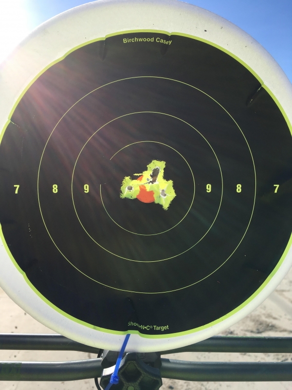

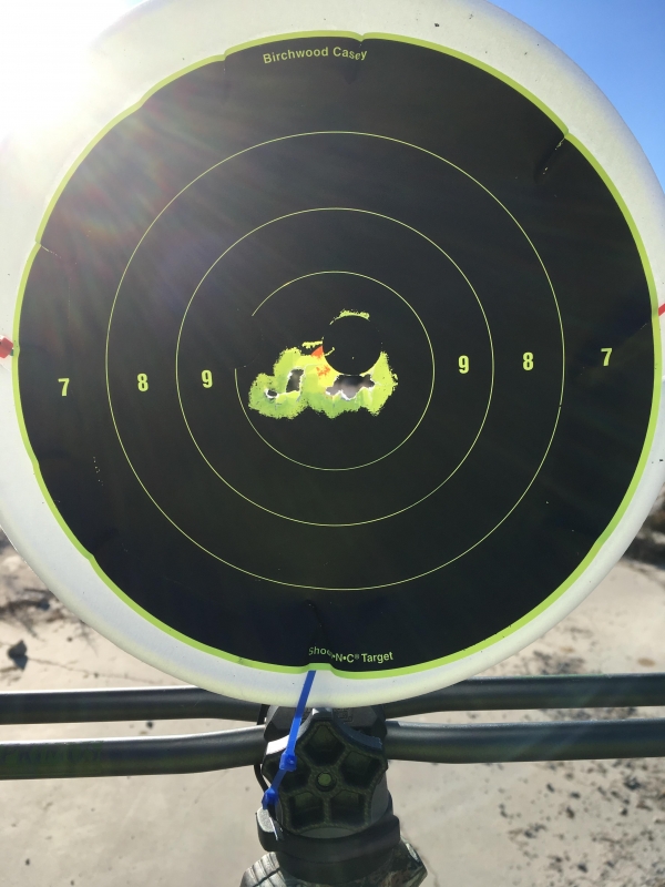

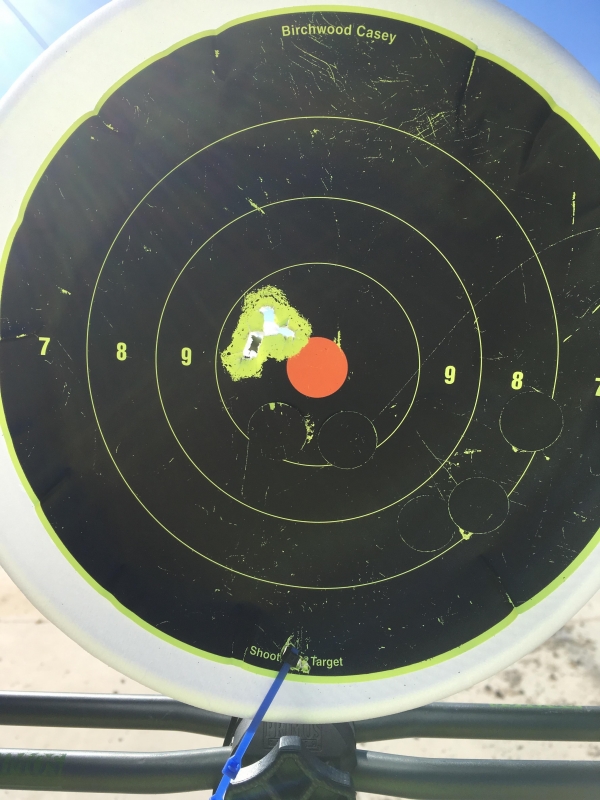

Helluva day at sea, Skipper! I just got back from the range where I zeroed, grouped (precision), and Chairgunned (accuracy) my Pulsar HP .25 with the JSB 25.39 gr. All targets are five-shot series. The results are substantially better than with the H&N Baracuda Hunter Extreme 28.24 gr! The JSBs shaved off an MOA @ 100 yds. The following were shot off a Caldwell Magnum DeadShot FieldPod (mild intermittent winds):
Zero Group (44.9 yds - Chairgun Optimal Zero Range):
___________________________________________________________
Complete Zero:
50 yd Group (No Chairgun holdover because 50 yds is effectively within my Chairgun 1/2' kill zone):

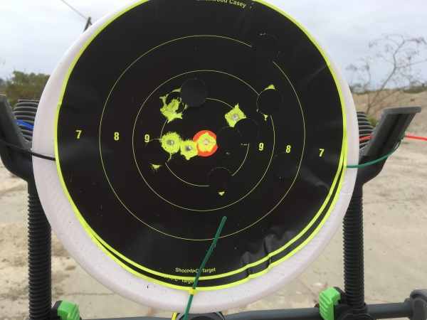

100 yd group:
100 yd Chairgun holdover (What is interesting is that this has a tighter spread than the group shot; I guess it was the wind):

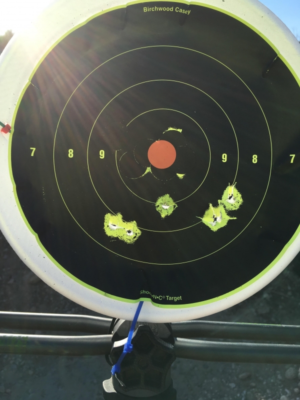

This last shot was from my Primos Trigger Stick tripod with the two-point rest, which is what I use while hunting. It is a 47.9 yd shot, which is within my Chairgun 1/2" kill zone. The crosshairs were set dead-center on the bull's eye. I literally had one shot left before I got a low-pressure warning!:
I think I may know why my 100 yd Chairgun holdover returns a tighter group (and red-dot accuracy) than a straight group. I believe that it is because I correctly derived the scope height Chairgun input metric. This measurement is not a simple parallel measure from center bore line to scope tube center. It is the measurement of the distance between the bore line at the muzzle and the scope line of sight, which by definition must be less than the simple parallel measure from center bore line to scope tube center due to the scope line of sight crossing the bore line. The scope height metric is a major significant input to Chairgun. It is right up there with fps. If the scope height is not right, POI is materially affected.
