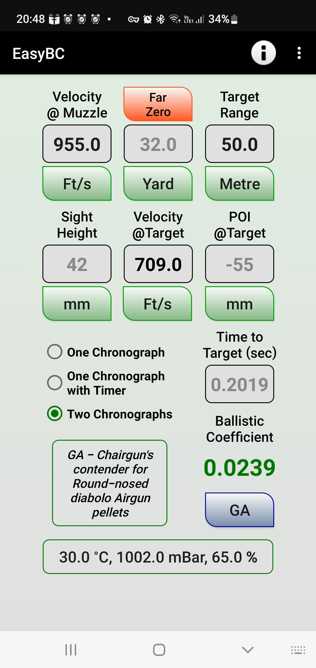

Ballistic Calculator: GPC Ballistics:
➧ V @0m = ∅ 955fps (52.6FPE)
10 shots: 962, 959, 959, 953, 959, 950, 950, 953, 954, 952, 951.
➧➧ V @50m = ∅ 709fps (29.0FPE)
7 shots: 703, 710, 714, 708, 712, 710, 706.
➧➧➧ 🔴 RESULT:
BC (GA) = 0.0239 ≈ 0.024

This is disappointingly low for a 26 grainer, also considering the test results of others.
Even if — through an error — my actual V @50m would have been 15fps faster (724fps), the BC still would only have been 0.026.
