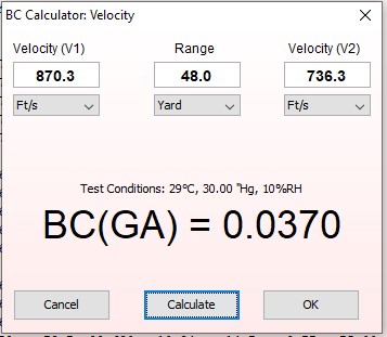

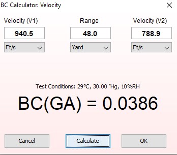

All of that got me to the testing yesterday: BC collection of the 18.13s at 870fps vs 940fps.
Using the fps at two distances method and each fps is the average of 10 shots taken at that distance. ES were pretty small for each of the 4, 10 shot groups.
BC of 18.13s @ 35.62fpe (940.5fps)= 0.0340
BC of 18.13s @ 30.5fpe (870.3fps) = 0.0358
0 and 48 yards= two distances at which fps was collected.
So, calling that 0.034 and 0.036. Yes it is slightly better, but I expected to see a much better BC at 870fps. The difference here is quite likely marginal and inconsequential. A difference of 0.0018 probably isn't going to matter much.

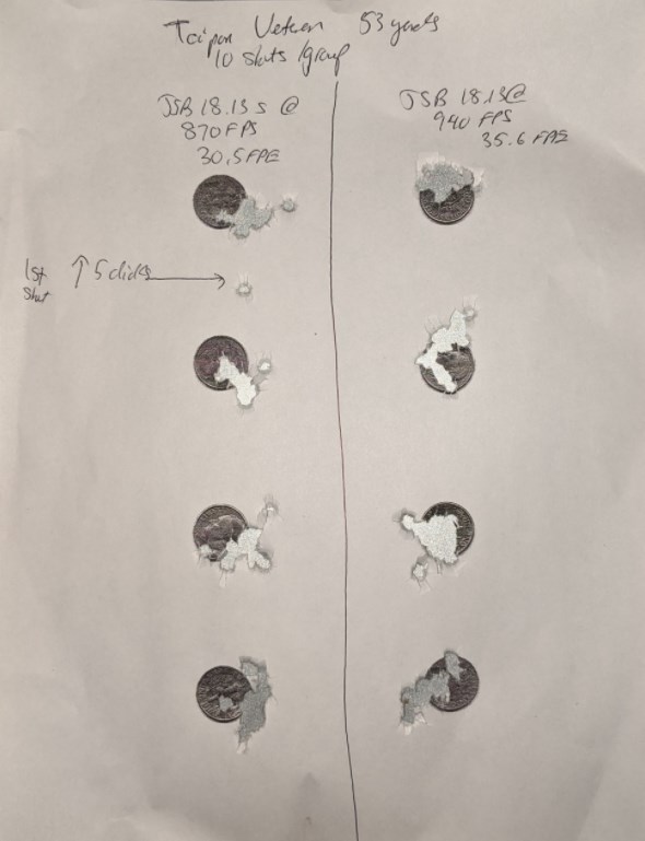

I also decided to shoot some ten shot groups at 870 and some more at 940 to see if any trends could be seen. (left column 870fps, right column 940fps). 81 consecutive shots and pulled a couple.
There was a slight (5-10mph) wind from the left to the right. That can be seen a little on the left column, as the groups are to the right of the center of the dime just a bit. Again, though, the groups on paper seemed pretty inconclusive, lacking a significant difference in either group size or location.

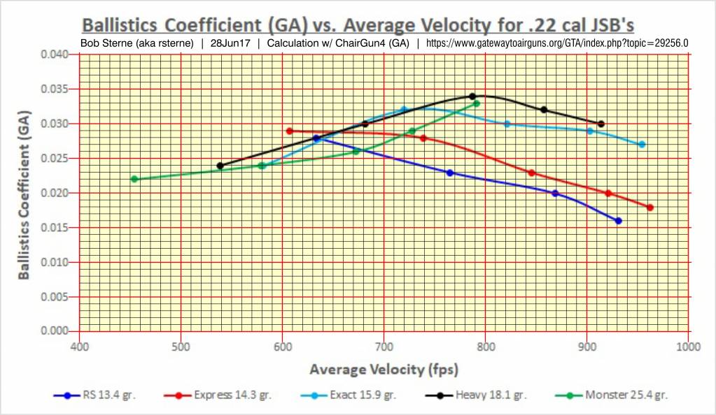

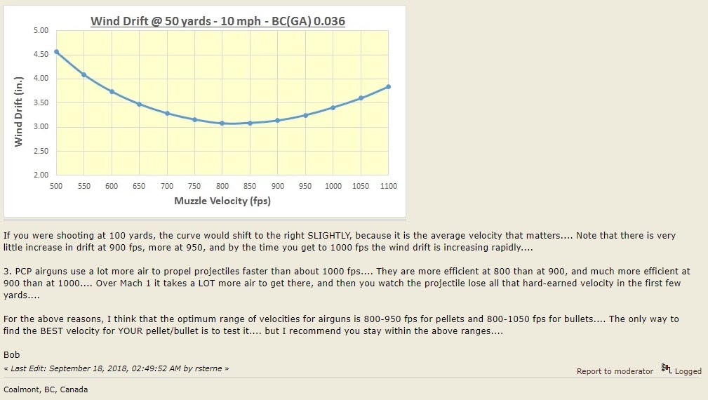

Doing some digging, I found where Robert Sterne made some comments back in 2018, specifically regarding the JSB 18.13s. Here is a screen grab of his contribution to that discussion
(entire conversation found here, if interested: https://www.gatewaytoairguns.org/GTA/index.php?topic=148410.0)
From his graph, it would appear that the difference in wind drift from the 18.13s between 850 to 950 is in the <1/4 of an inch range at 50 yards.

Franklink, I can't see a difference in drift in the groups you show here either???

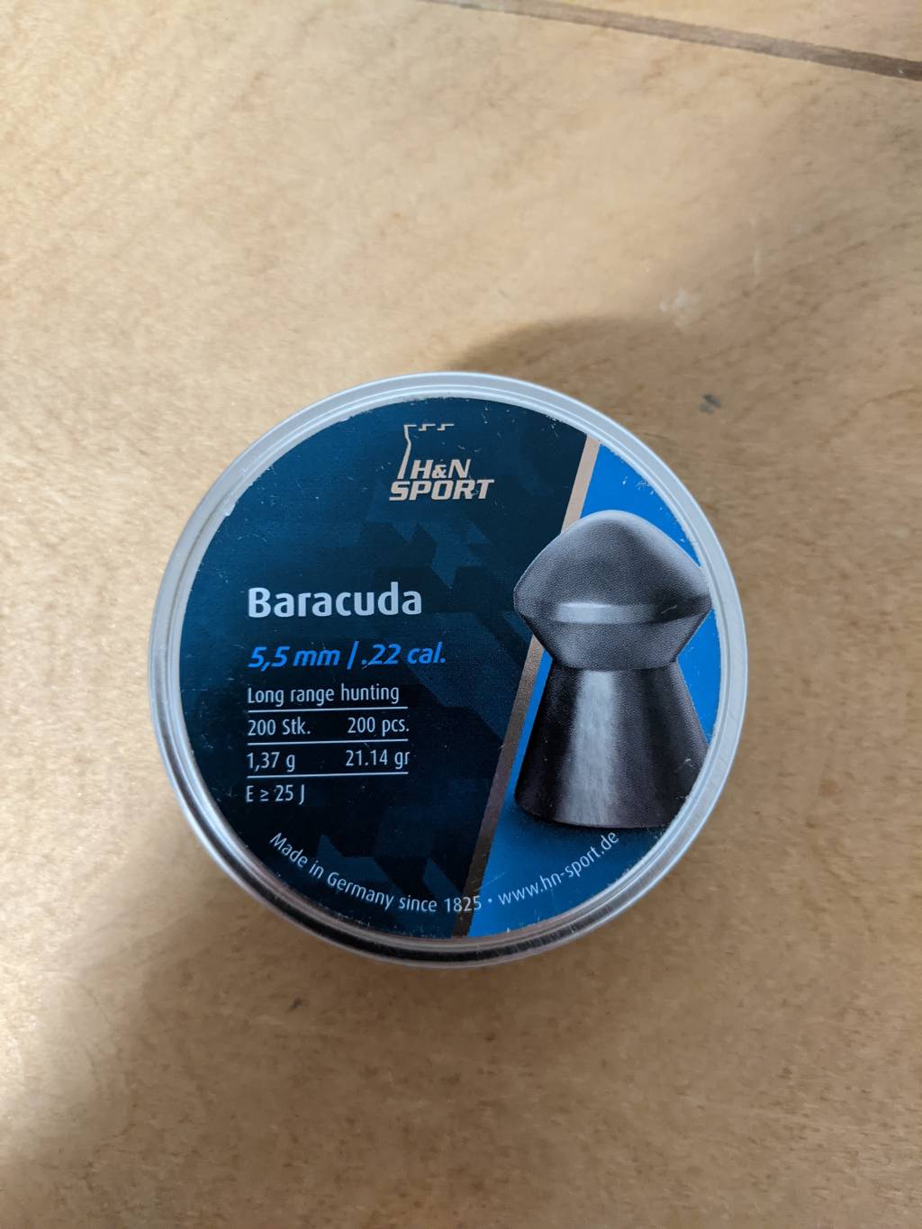

🔶A thought on pellet selection:  Have you tried the H&N Baracudas? The Match version comes in three different head sizes, and they have a Power version (copper coated). 21.13 grain. BC similar to the JSB Heavy — or better due to its much higher weight.

🔶Here's another velocity-variable BC chart by Bob Sterne, with all the JSB domes in .22cal.
For longer ranges it helps a little to shoot the pellets a little faster than their optimal BC velocity — because during their flight they slow down and move to velocities with less than optimal BC.

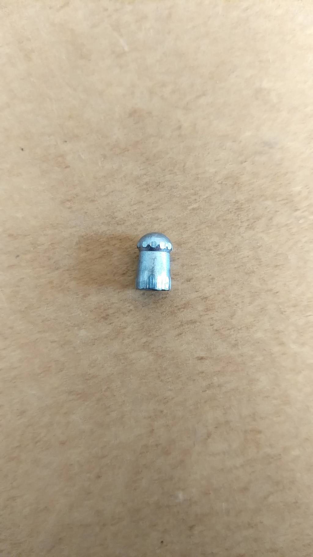

I've tried slugs out of this barrel too, down to the 0.2165 size from NSA, the 17.5s to be specific. They did okay at < 50 yards but were really bad any further out.
When I pushed various projectiles all the way through the barrel I was finding they measured 0.210-0.211. When I pushed them up to the choke and then back out the breech, they were in that 0.214-0.215 size. That suggests to me that even the 0.2165 slugs are too big for the choke on this particular barrel.
Check out what a JSB 25.4 looks like after going through the choke.
The marks made by the lands start pretty high up the skills of the skirt. Oh, and the amount of force required to push any projectile through the choke is just something else. Dang near has to be tapped through, vs pushed through.
So, I think the tight choke keeps slugs from being an option with this barrel too.

On your question of H&N, I tried these
And they did just okay at 50 yards. From past experiences I have a really hard time making any H&N pellet a primary projectile for a gun. They've just seemed to be really inconsistent across various types and calibers, as well as from one tin to the next of the same pellet.

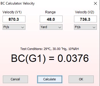

So, the BCs I worked up the other day are pretty good ideas of how well the 18.13s slipped through the air that day, at those two specific speeds. They are actual BCs of this gun, calculated from actual data. I was using 0.040 in Strelok to get things to match up kinda closely, prior to doing any of the BC collection that started all of this discussion. Which lead me to this.....(just did this now as an experiment).

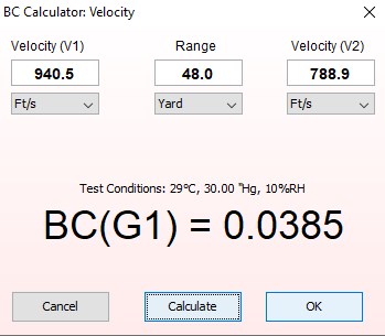

Plugged all the numbers into an old version of Chairgun for PC.
A difference of 0.0016, using the GA, and STILL an inconsequential difference in BC from one speed to the next with the 18.1s from this gun. The difference using AOA's calculator was 0.0018. As I previously mentioned, I'm betting there's a GA drag profile in the macro/behind the scenes calculations for the AOA website tool. Th difference of 0.0002 between the calculators is most likely due to how it was formulated to do the rounding.
Regardless of the calculator I use, the answer the question I wanted answered (will lowering the speed help the wind drift?) is pretty much the same. No, it won't. Now, had I seen a BC go from 0.0386 with the 35fpe to 0.045 with the 30fpe, you can bet your bottom dollar I'd be out there shooting it at distance to see how much it really drifts at 870fps vs 940fps. But, with this minimal (and very similar between two calculators) difference, nope, not worth my time.
You wanna really have some fun? check out these numbers with G1 instead of GA.
G1 is a flat based spitzer, a far cry from a skinny waisted diabolo like the 18.13gr JSB, yet the predicted BCs are nearly the same. THIS is why I don't give much credence to putting all my eggs in the ballistic modeling program basket. They're a good start, but that's it-gotta shoot real pellets (or slugs) at real distances in real conditions to get real results.
