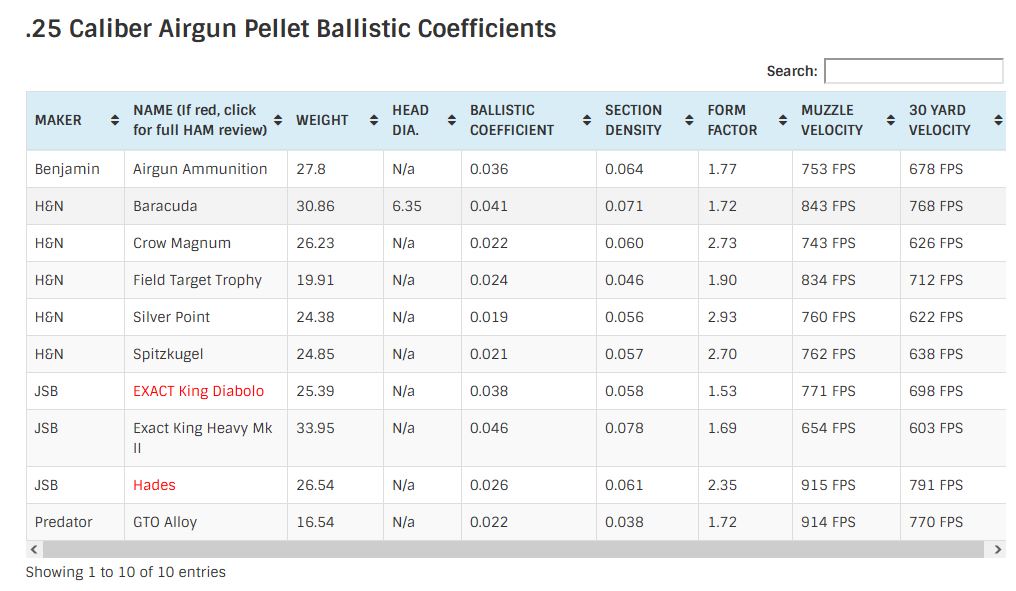

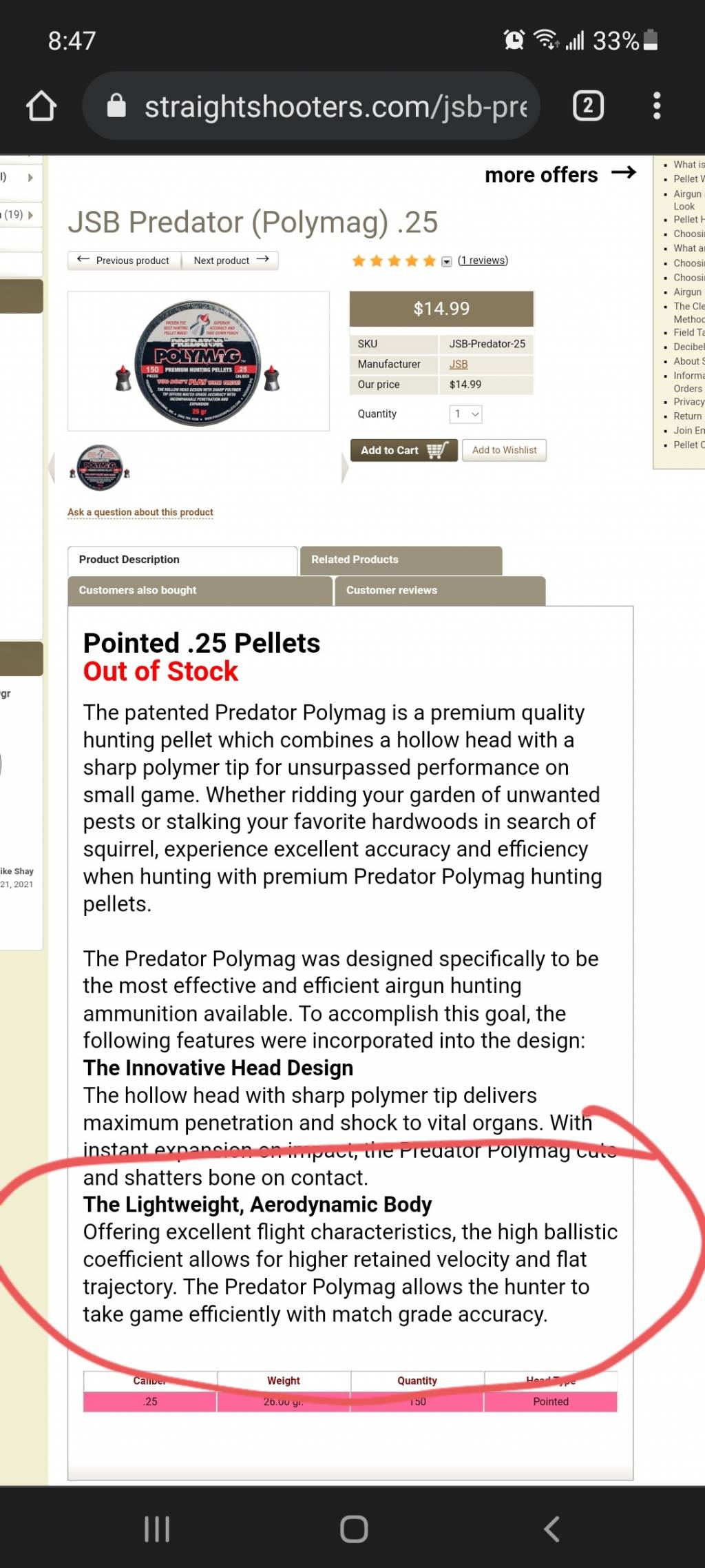

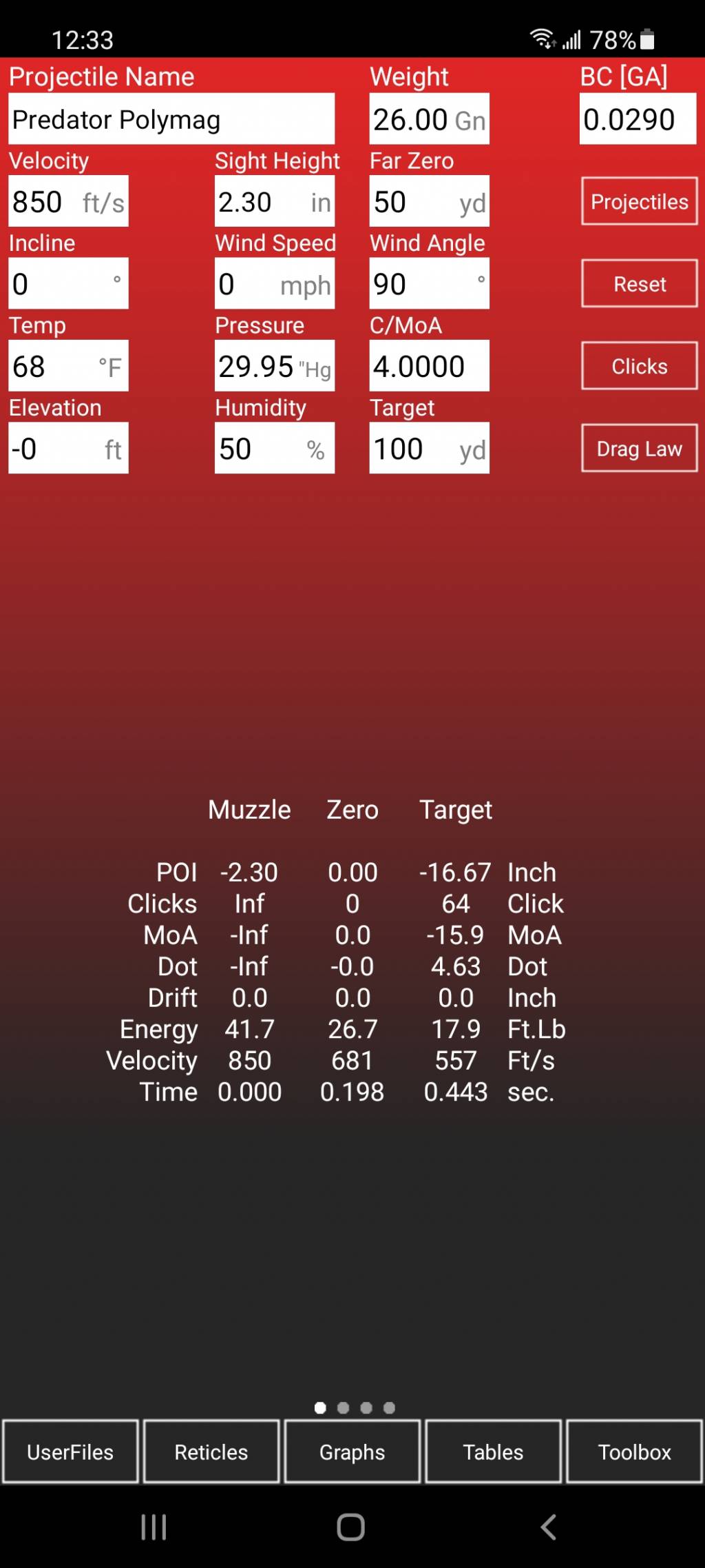

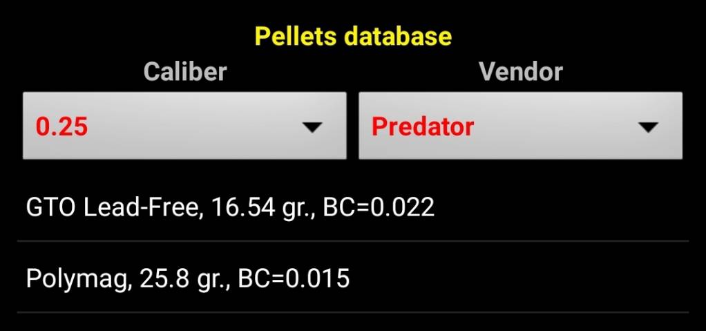

BC For .25 Caliber Predator Polymags

@Vetmx Are you saying that his credibility is in question? I don’t know anything about this young man. I saw him shooting in a couple of videos months ago. I realize that videos can be edited to manipulate all sorts of things, so I think it prudent to exercise a bit of healthy skepticism. I’m not sure if he’s shooting Polymags or not. I didn’t see them. A scope cam would’ve been great as well. Ultimately my interests lie in the BC and the potential of this particular pellet since coming across this thread.
@Skohl I’m still unsure of a reliable source for the .25 Polymag BC. Have you found a number that works for you? If so, how far out have you been shooting from and with what sort of success?
