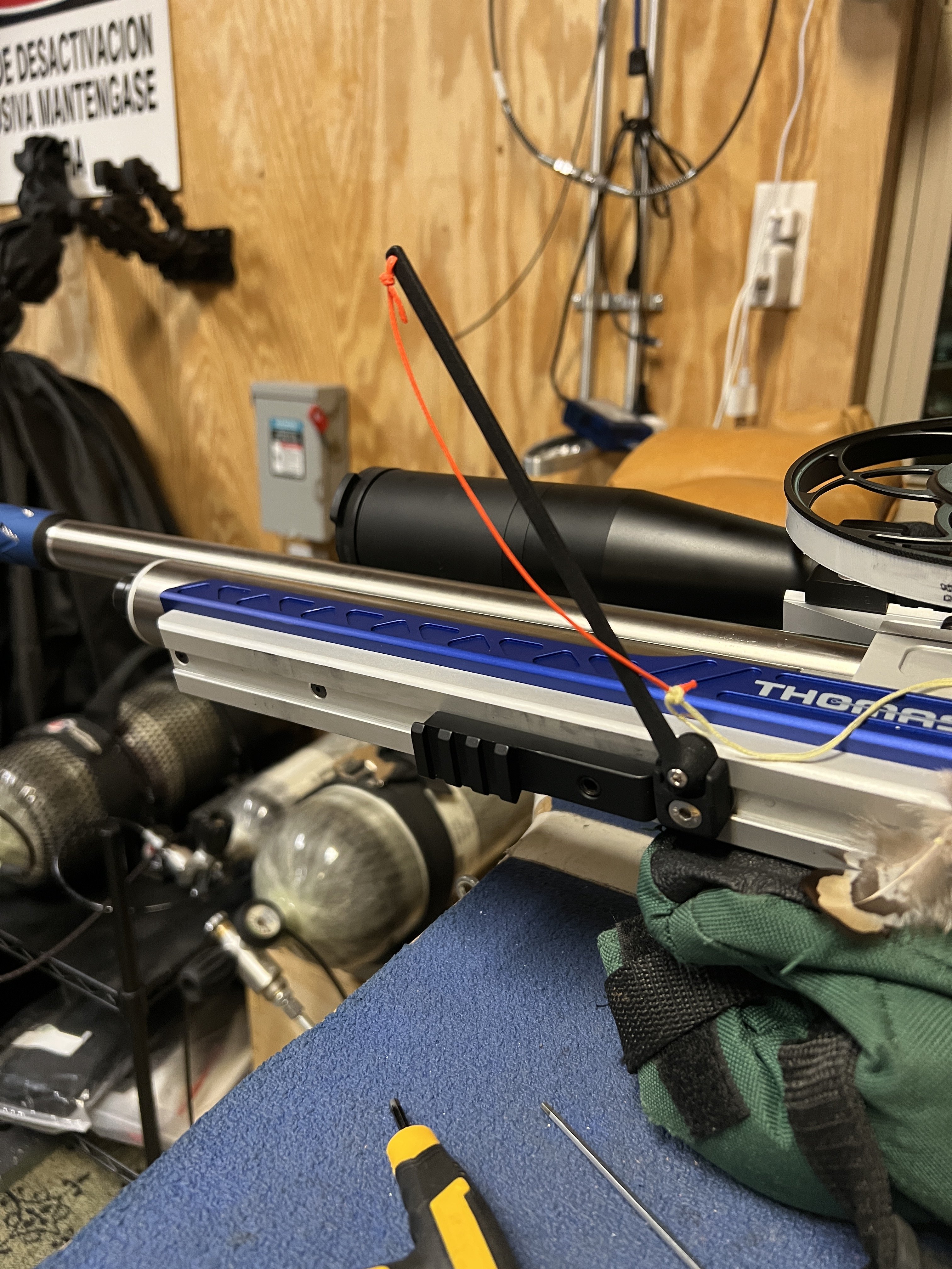

It's now ALMOST September 2025 and I'm still at it - the quest for the perfect barricade stop. This time I am working with my Thomas HFT rig and my 3 EFT rifles to get it "mostly" right or as stable as possible.
For the first picture, my Thomas is using a UIT to Picatinny adapter which is minimalistic AND a perfect stop for my Rekon sticks pic #2. This UIT to Pic adapter is made by Rapid Air Worx - taint cheap.
I am still sorting through my final choice for my EFT rig....
A .25 Blackwolf in a chassis that is M-LOK on the forend.
A RAW .25 HMX1000 which is M-LOK on the forend.
A .25 Redwolf in a PRS chassis which gives you a choice of Arca or UIT on the forend.
Chassis type stocks create an additional fitment issue for bipods and sticks because the chassis are typically wider than our trigger stick yoke heads, and the chassis frames often cover the bottle preventing using the bottle as a rest point before it bumps up to the chassis.
PRS in the UK makes a super cool M-LOK to UIT conversion adapter which a fellow shooter has on his .177 Blackwolf; not pictured here but a link is provided below (currently out of stock) and tariff issues are in play.

Rudy, why don't you to experiment with simply using the chassis as your "barricade stop"? Ie, rest the air tube in your bipod yoke.
I do this with various guns and don't experiment any sort of poi shift issues. And you certainly shouldn't with a robustly built Thomas.
I've done this with all my airguns = using the chassis / air source as my initial barricade stop while learning the nuances about a new rifle or pistoli, but it tends to mar the stocks and I find it a bit more tipsy. My TM1000 pistols have a deep well between the air bottle and chassis so i have kept that method for them... but again they can be tipsy if I'm not on my game.

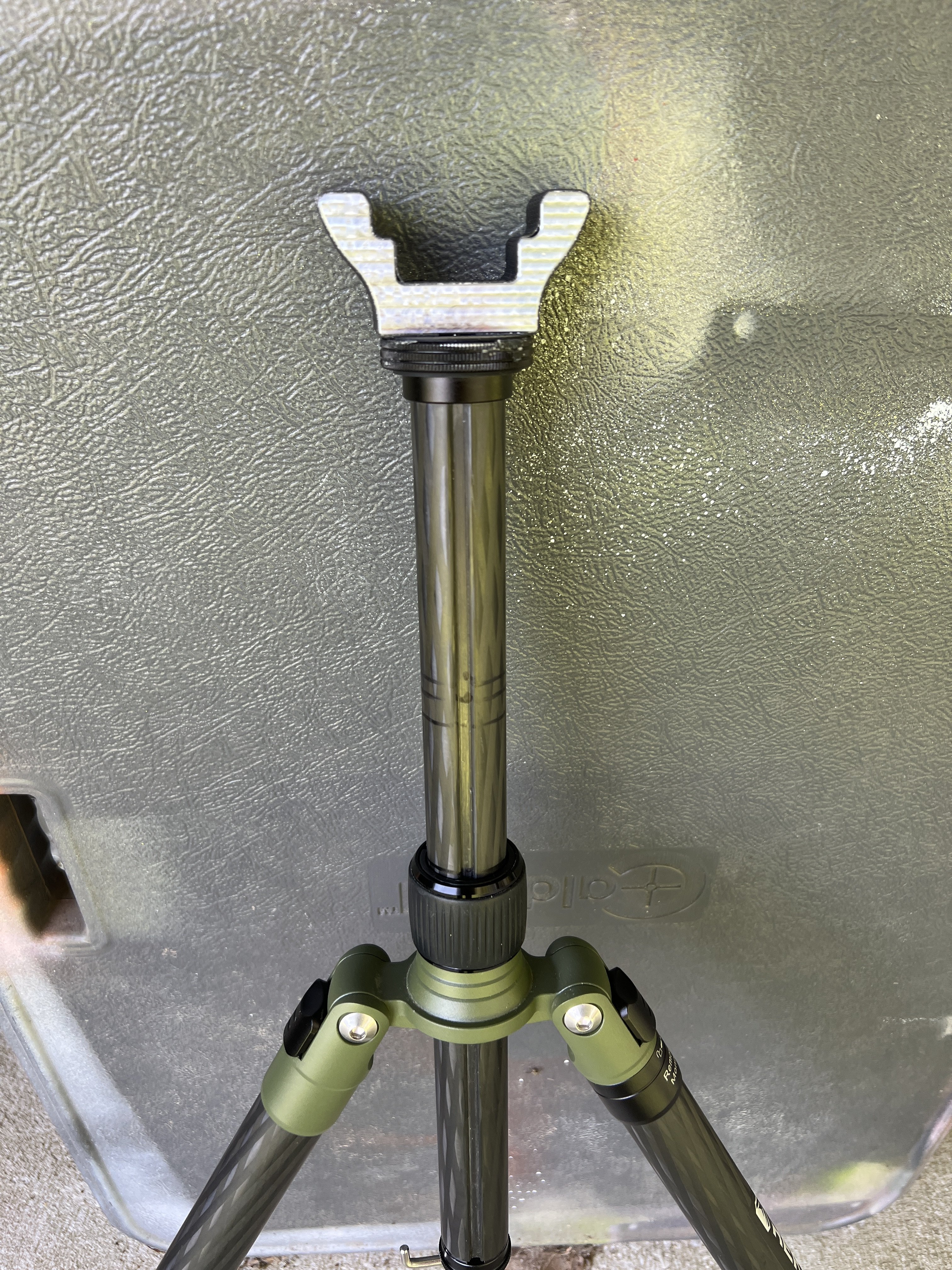

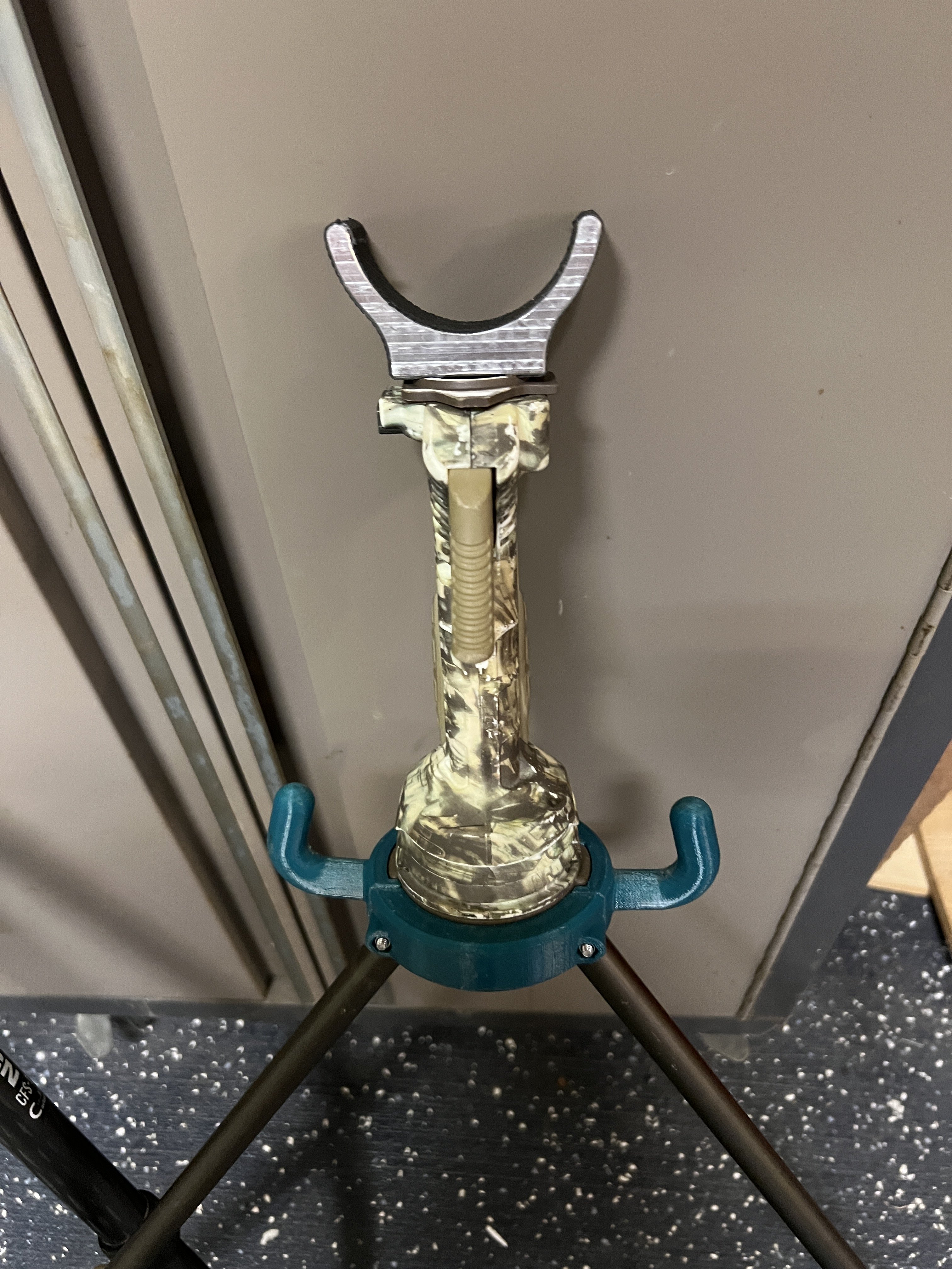

Rudy, for your Thomas is that a custom thingamajigger on top of the Rekon bipod?
Is it aluminum or 3d printed or...?
yes.... aluminum on the Rekon bipod sticks it matches the profile of the Thomas stock "but" it's width allows it to fall free easily. Front to back, the depth is less than 1.1/4". I also placed some friction type rubber on the mating surfaces.
The picture of the Trigger Stick bipod has the same idea but it's aluminum yoke is set up to accommodate a 60 mm? bottle so it sits in the sticks way better than the y-yokes.
Be aware that the thread size and pitch is different on the Rekon sticks V the Trigger sticks. 3/8" V 1/4" or something like that.
Reactions: steve123

Trigger sticks actually have a good bit of wiggle in them
Sure do.
The few times I've taken shots from them have left me with a "yuck, how the heck does anybody hit anything with these?!"
Maybe that plays into why people seem to constantly be tinkering with various yokes on the trigger sticks, desperately searching for SOMETHING stablish.
Edit: i use some plain shooting sticks (no yoke), not the branded "Trigger Sticks." I can see how my earlier comments may have lead to some confusion.
Reactions: cavedweller
Sure do.

the Rekon sticks are amazing but lack the easy adjustment.
If you could combine the stability of the Rekon sticks with the rapid easy adjustability of the trigger sticks - wow, that would be amazing
Reactions: steve123

Add a scope ring (any size) to the bottom of the RAW pic adapter and you have a nice stop
